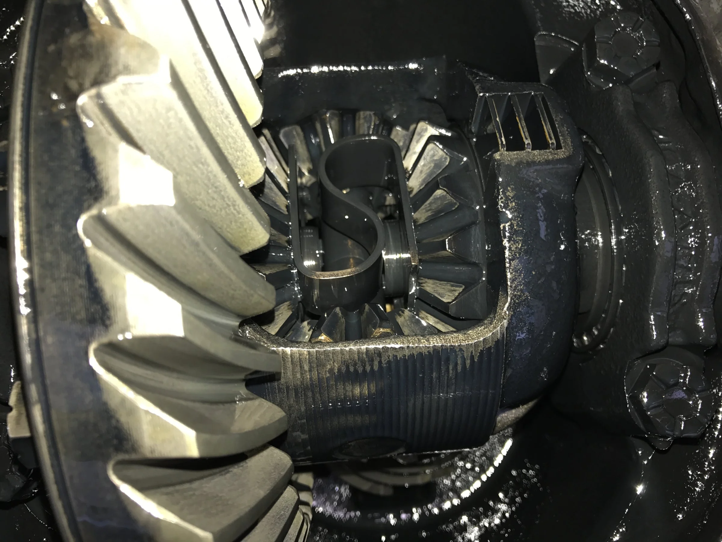

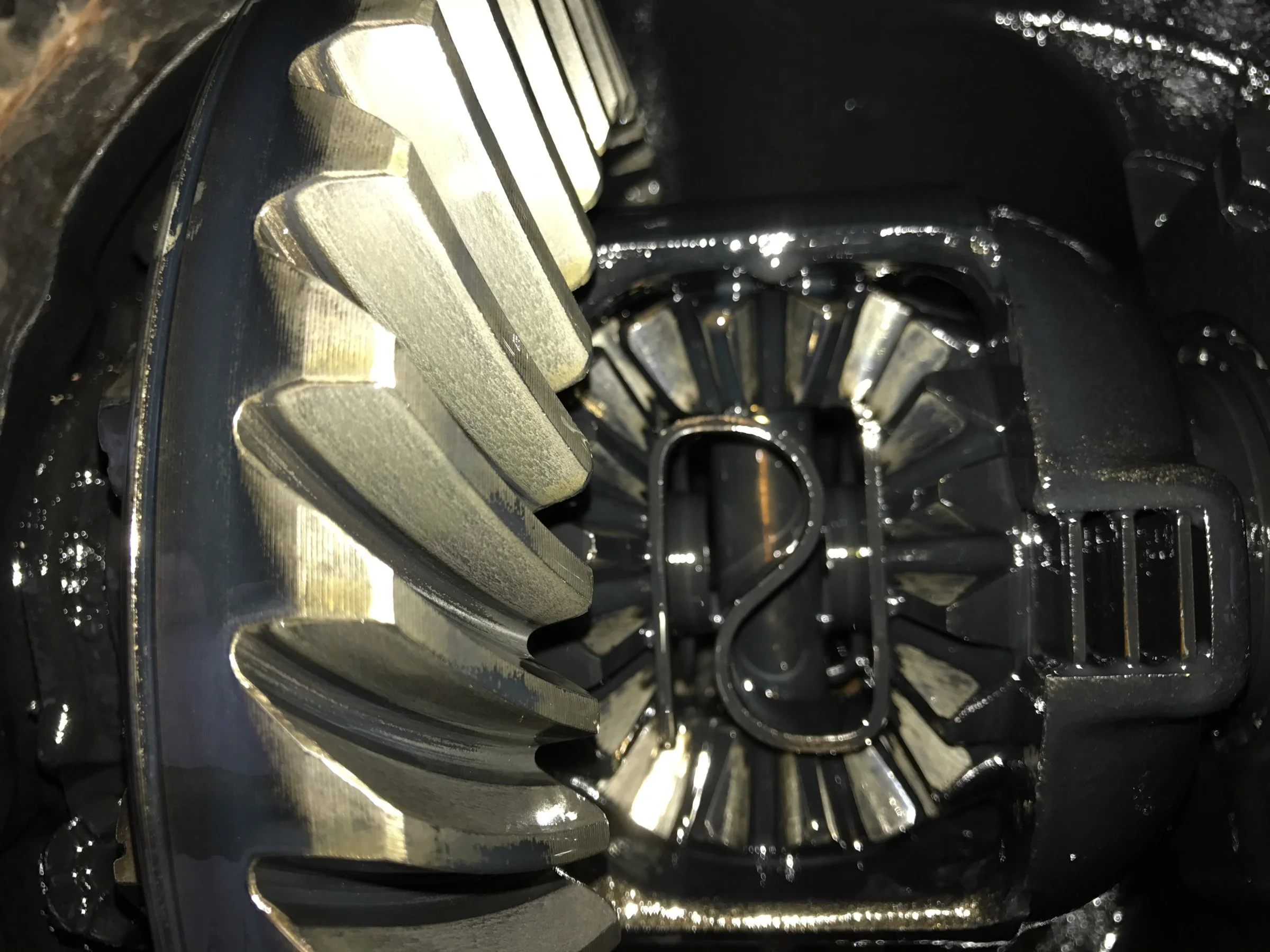

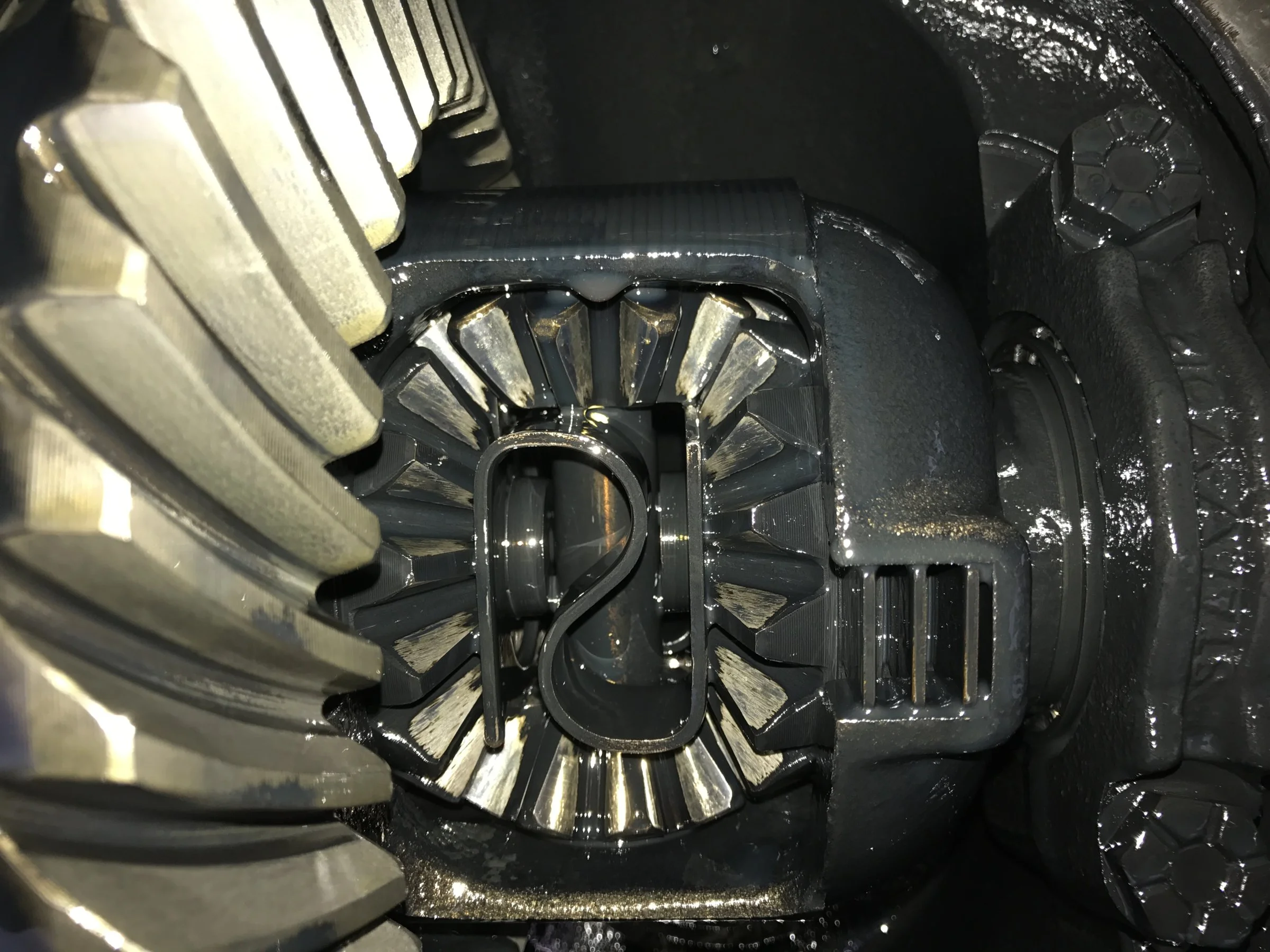

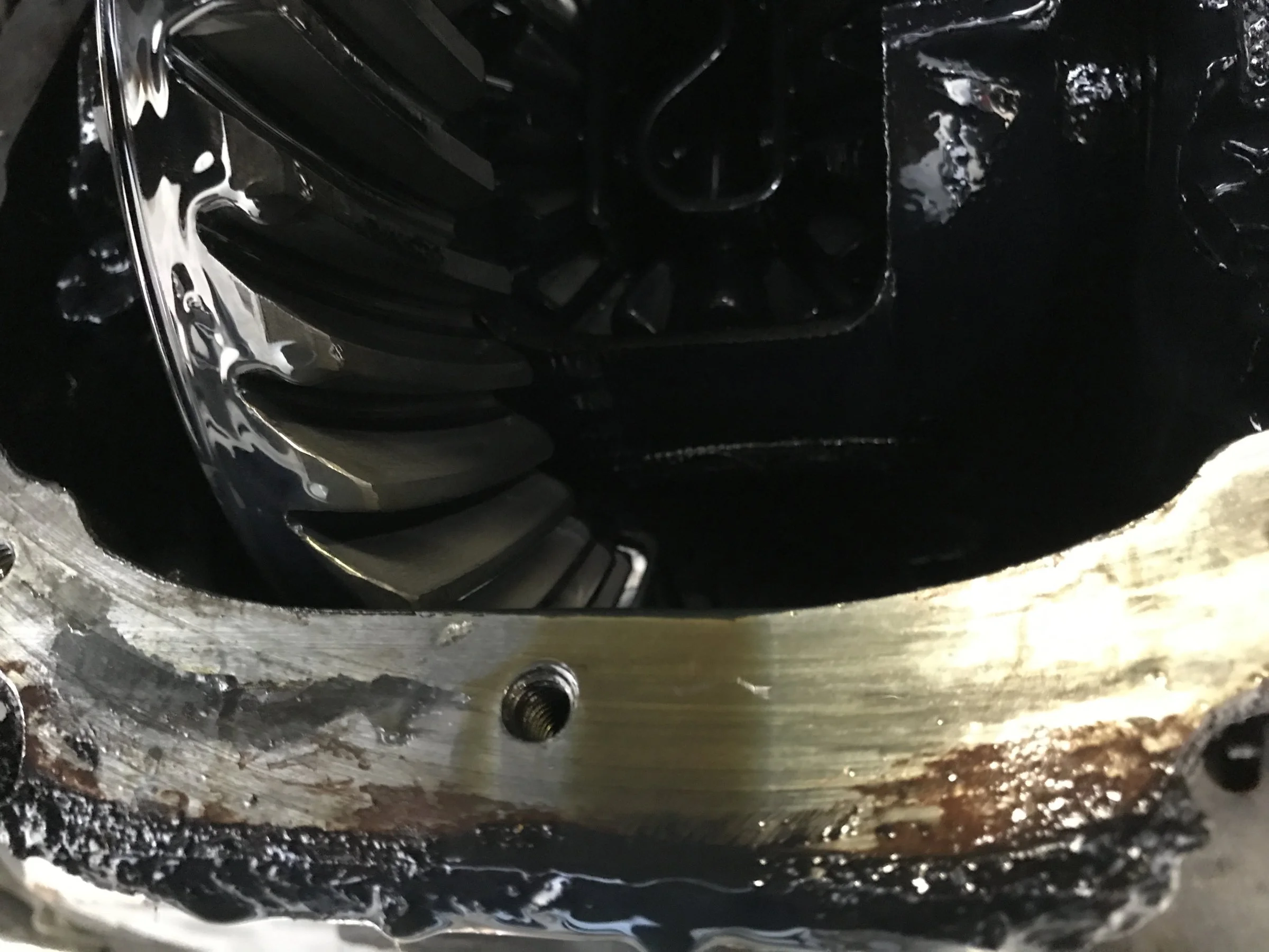

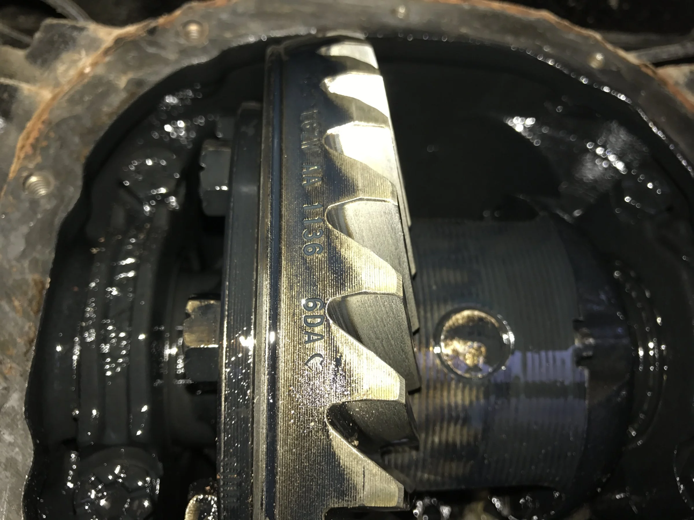

I was wondering if you could possibly help me with this other issue I am having.
I am having a binding noise coming from the rear when turning sort of sharp. It seams to do it once the engine warms and you drive about two miles. I did top off the rear oil after it did it the first time. The rear is hot to where you can not touch it long and not sure if this is normal. Do you think the rear is shot and can it be rebuilt or do you have any ideas to help me.

Sounds like you may have damaged the rear end. The fluid requires a special additive to keep from damaging the track lock
90sickfox
Wasn't a pretty sight...and I've got big hands
SN Certified Technician
Mar 2, 2015
6,949
5,825
213
Sep 20, 2017
#33
  • Sep 20, 2017
  • #33
The best advise I can give is to pull the rear cover off. Its not complicated. You want the front wheels chocked, transmission in neutral, and rear on jack stands with both rear wheels off the ground.
First, you're looking for any metal or glitter in the fluid. Second, you want to check the spider and ring gears for rough marks, chips, or scoring. You want to use " right stuff " silicone gasket maker when you put the cover back on. That stuff never leaks.
Also, you want to get a bottle of Ford friction modifier when you put fluid back in it. I had to get mine from Ford. I think it was a 6oz bottle. My rear took 4oz ( I believe )
I'd also advise you to remove the rear from the car and take just the rear to get rebuilt. Its easier for the shop that way....and sometimes easier on the pockets. That is, if you have a vehicle the rear can be transported in.
Sounds like you may have an issue with the clutch pack inside the rear.
There are several 8.8 limited slip rebuild videos on YouTube. It really isn't that hard to do. Just make sure you put all the shims back in exactly like they were before you took them out. If you don't replace the ring and pinion gears then you should be fine using the same shims that came out. There's a spring that a real pain to get out and put back in....other than that its easy peasy.
Show us some pics of what it looks like behind that cover.

I have not had time yet to pull the rear diff cover yet but I did take the drive shaft off and turn it by the pinion hub and it soulds like it makes a noise when I stop from turning as for as my wrist will allow. How much drag should it have when you turn it this way? I also tried turning it by the hub and think I got like a dragging noise is this normal? I will try and post the vidio of turning the pinion first then the wheel hub to see if you can give me any input. Had to load on youtube since file is to big.
View: https://youtu.be/vg9bD8VH_V0
View: https://youtu.be/Lv4kUrCPC7o

Yank them drums off, you may have a broken thing-a-ma-jig in there draging on the drums.
As for the noise when you turn the pinion that could just be backlash, the pinion gear and the ring gear banging together, you've checked the gear lube right?

I check the gear lube and did not see any metal. how easy is it suppose to be to turn the pinion hub or wheel hub? I did have the brake drums off and the axle when I took that video. I also notice a clicking when I hold the diff hub and turn the wheel hub a little bit. Not sure if axle spline are worn. Attached are some pictures of rear open.
