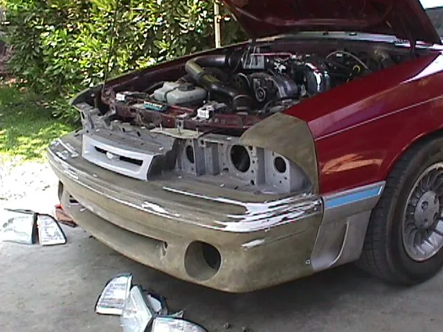

the front Clip and side skirts (infront of the front tires) go on without a hitch, bolt holes and all.
The side skirts that run under the door and the rear bumper (not my cup of tea) i have not done. I plan to go a little more mix and match.
keep in mind the actual fiberglass bumper from the get has brackets and holes drilled for those brackets for the fog light assembly. So if you do a swap, do it all.
Front clip + head lamp support +bumper and side skirts.
Ps: you will have to remove the stock lx skirts mounted on the low of the front fenders in order to get the GT skirts to fit. No biggy.
