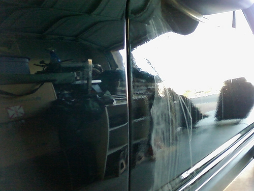

Here's a before and after... the left side has been wet sanded and buffed. the door still has orange peel, and a dusty pic of the fender...
Hey thanks for the reply!!! I was told by the paint place to only put 2 coats on.. they said that they have heard of some people who put too many coats.. I'm sure 2 or 3 would be almost the same... but anyways that have paint jobs that end up being brutal... foggy or something... have you ever heard of this... I guess.. I'm kinda nervous about cutting through though like you said.. that pic is really nice... good job!!! Like a mirror!! About the door... so would I have to have the hinge rewelded.. and cut off... to replace it.. or would just the pins and bushings do it.. would that fix the problem with the gap... how do I re-adjust the door.. needs to be pulled towards the back of the car... gap is too big near the back.. and rubbing at the front.. I am going to fix the imperfections before applying the base... I was told to spray the clear 45 minutes after the final base.. so the clear can kinda seep into the base.. while it is still wet... well not wet.. but not dry.. that sound right?? I'm at the stage where I have only a few problem areas that need to be blocked sanded.. and I am going to hit it with about 400 grit once.. then I'm pretty much ready.. but I don't want to do anything till I figure out this door situation!! Thanks so much for the reply... Oh about the gritty feeling.. is that normal for the primer to be gritty like that??? feels like sand paper..
