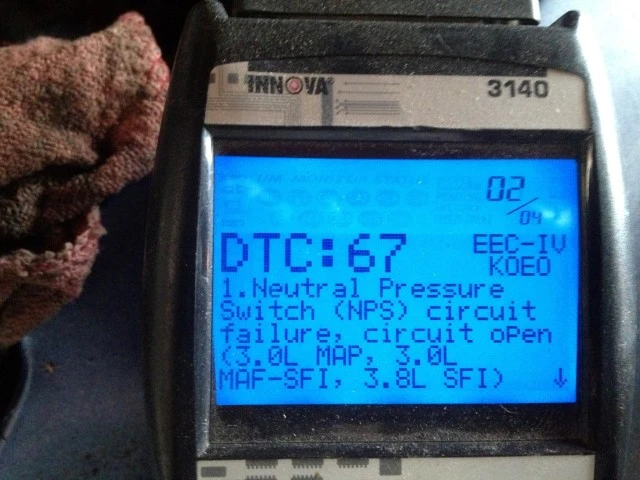

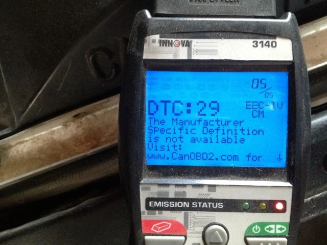

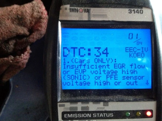

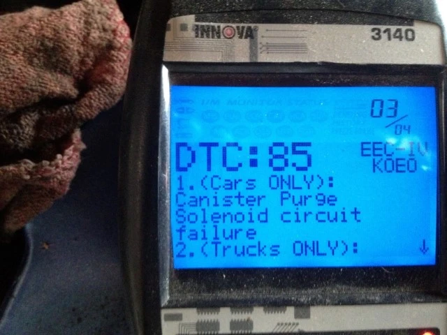

I hooked up the tranny harness, and I still get codes I wouldn't expect to see and it still won't complete the KOER test. At one point DTC 34 showed up twice, dunno why - that's why some pics say there are 5 codes and some say 4.

29
Vehicle Speed Sensor problem - VSS
