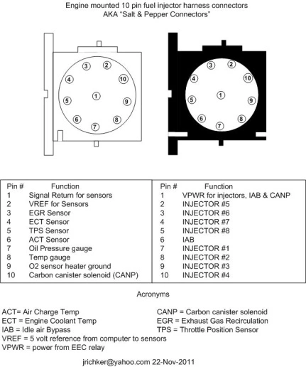

C.) No power, then look for problems with the 10 pin connecter (salt & pepper shakers at the rear of the upper manifold).
See the graphic for the 10 pin connector circuit layout.
salt-pepper-10-pin-connectors-65-jpg.68512
The injector power pin is the VPWR pin in the black 10 pin connector.
D.) No power and the 10 pin connections are good: look for broken wiring between the orange/black wire on the EEC relay and the red wire for the 10 pin connectors.

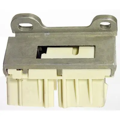

The yellow wire feeds the ignition switch...
Start by checking the ignition switch...

Some of the symptoms of ignition switch problems are things that don’t work or are intermittent like radio, turn signals, wipers or heater.
There was a FREE recall on Ford ignition switches. They overheat and sometimes catch fire. That burns up the steering column and sometimes the car interior. Since this is very old information, you may not be able to get the switch replaced for free anymore. The auto parts stores sell the switches for $13-$15.
While you are working on the switch, check the wiring and connector closely. A replacement connector with new wiring pigtails is available from most auto parts stores
AutoZone and Advanced Auto Parts have the same Part Number: 434 - may have to order, not always in stock
Advanced Auto Parts alternate part number: PT5534

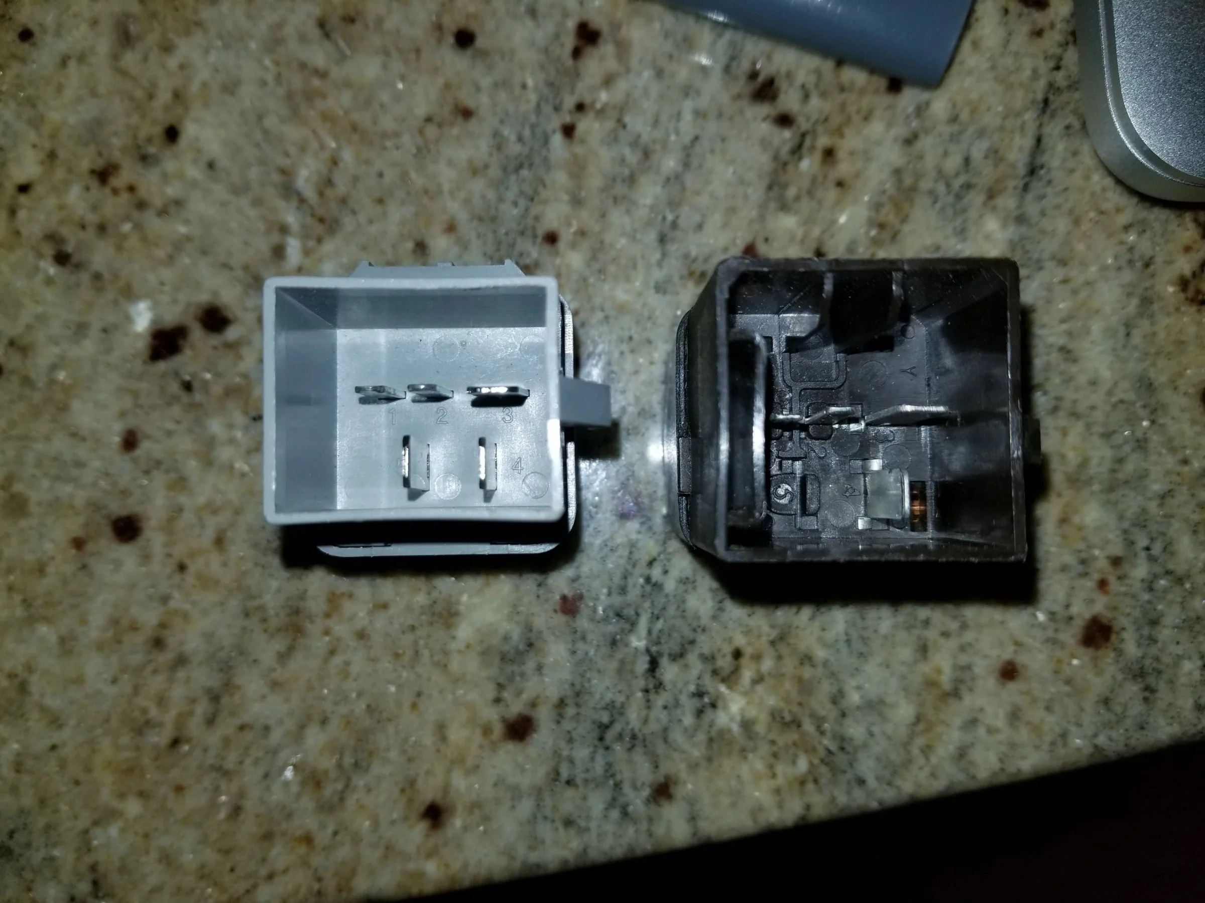

Both yellow wires coming out of the ignition have 12v. I pulled the ECU relay and tested the connector on the pigtail and found I have 5v at the two red wires.
Is the grey relay the correct replacement for the brown ECU relay? One has 5 connectors the other has 4. I ask because the brown relay with 4 connectors doesn't have any continuity so I replaced it.

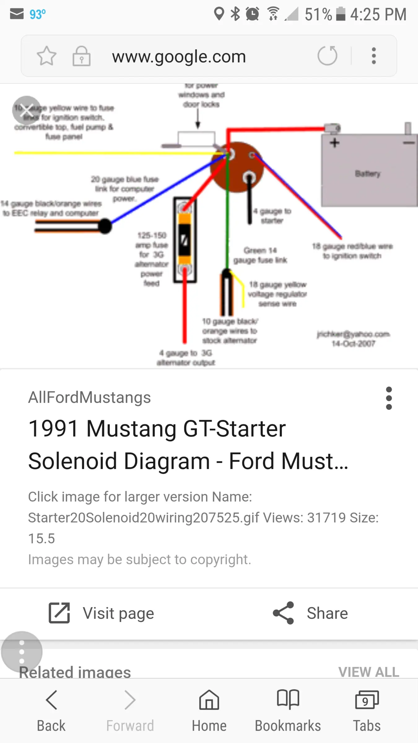

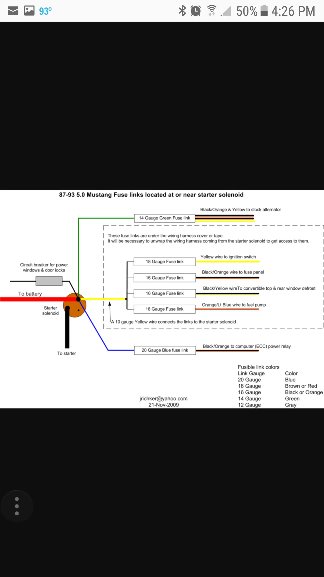

No it hasn't. Stock alternator. I had the blue and black fuse links screwed to the fender wall next to the battery ground.
Fuse links are never in the ground path on any foxbody Mustang. Fuse links protect the wiring from too much current that would damage the wiring. The diagrams provided here should be sufficient to show you what goes where and how to connect the wiring.
