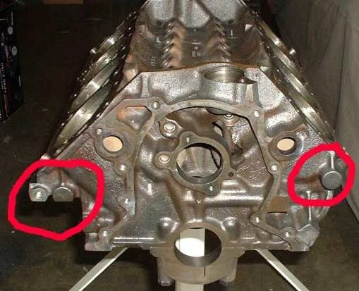

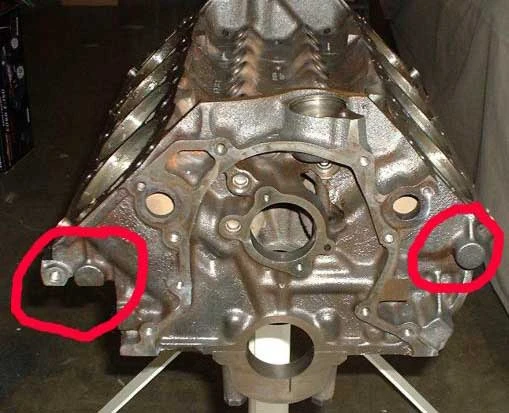

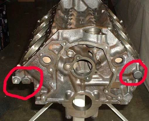

If its a true mexican block there should be a casting that says "Hecho en Mexico" (Made in Mexico) somewhere on the block... I forget where exactly. Maybe near the lifter valley?
So close to the lifter valley that its IN the lifter valley :D. Apparently they have these wierd bosses on the front too:
Also, they are NOT 4-bolt main blocks. On the whole, they are about on-par with a Sportsman(or slightly better), but cheaper and much harder to find.
"Sportsman" blocks are just based on early 302 castings. They are not rated at 600hp by FRPP anymore, but 450hp. Some have split even at 450 N/A.
I concurr - the only production 4-bolt main 302 was the boss 302 which had a lot more than just the 4 bolt main design.
