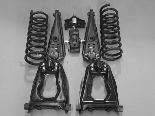

A V-8 conversion starts at the suspension. These V-8-type spindles should be installed as a first step on any V-8 conversion. Don't try and get away with using the smaller six-cylinder spindles with the V-8 engine. It's not worth the risk.
Although the control arms are the same for both six-cylinder and eight-cylinder cars, the coil springs are different. Replace the whole front suspension with new hardware.

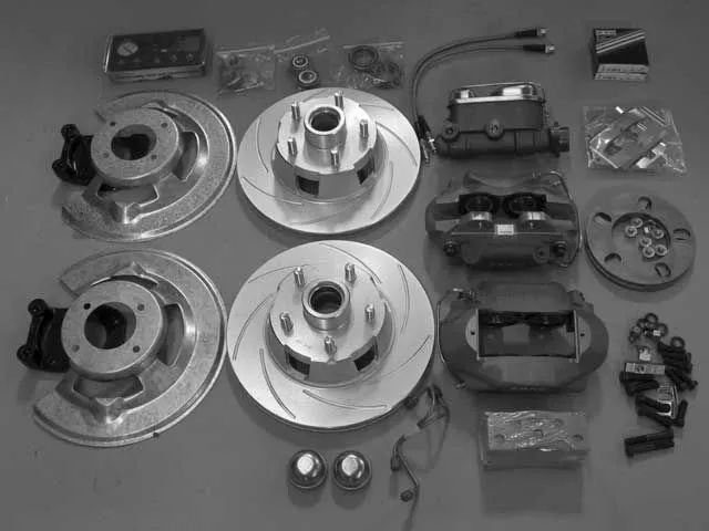

Five-lug wheels are needed for the V-8 suspension; as long as the five-lug conversion is needed why not convert to disc brakes in the process? The whole kit will bolt right onto the stock V-8 spindles, and you'll be adding a great deal to the operational safety of your car. You can buy this complete and excellent kit from Stainless Steel Brakes.

Your question. The easiest is to get some spindles off a 70s granada. They bolt right up and you have disk brakes. You do have to change all your steering as the i6 is smaller. The tie rod ends will go right through the spindle. Next get a dual Master Cylinder for disk/drum. That is such an easy install.

Adding front disc brakes is a great upgrade. I went with Granada stuff on mine, but the OE style setup is a good way to go too. There is really not much if anything to be gained by going to rear disc. The only reason I did, is because my Versailles rear end came with them factory.
