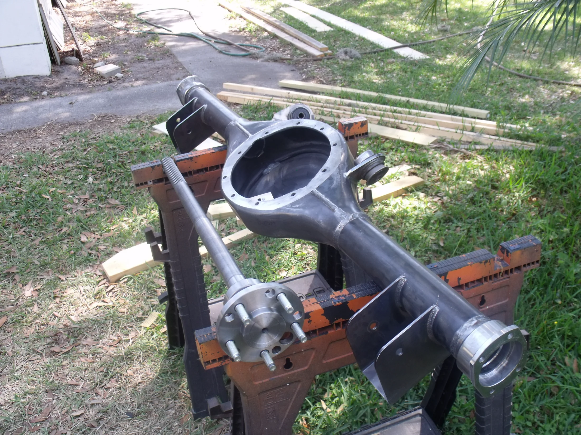

I purchased this from Speedway a few years ago and I can't remember the dimension but it
was spot on to the 7.5" that was original to the car ( 83) ....
