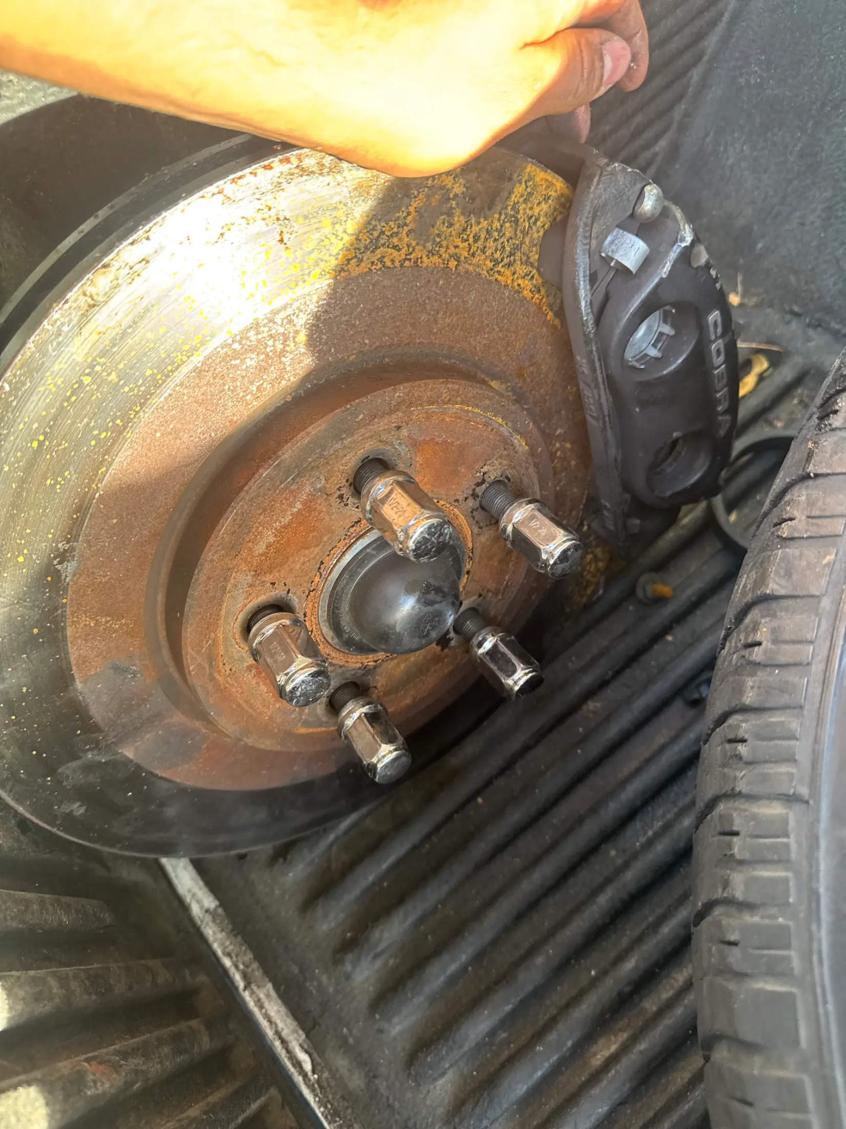

So I’m doing a 5 lug swap on my 84 5.0
Unknown spindles I just bought used the whole assembly with brakes
The only problem I’m running into is that one whole does line up with my shock but the second one is off by a hair
Already jacked it up and tries everything do I need sn95 shocks?
So struts from a 87-93 5.0 car will bolt right up to the SN95 spindles. Struts from a 79-86 (all variants) and 87-93 4-cylinder car will require a shim. The bolt holes should line right up or at least I have not had an issue with the few that I did back in the day.
All Fox cars with a Fox ball joint will require a 0.330” spacer between the top of the spindle and the castle nut. You can install SN95 ball joints in Fox control arms and then there is no need for the spacer.
