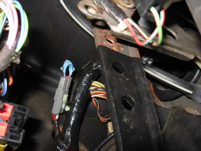

Chythar has a schematic of the starter interlock(?) circuit.there is a plug you have to pull out so the engine will not start with the clutch pedal not pushed in.
Yup, there's a plug above the driver's kick panel, up a bit high. This photo is up and to the left of the clutch:
It's the connector with the blue tape on it. Pull that connector and you won't be able to start the engine until you push the clutch to the floor.
