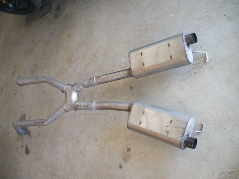

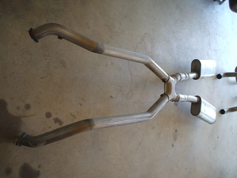

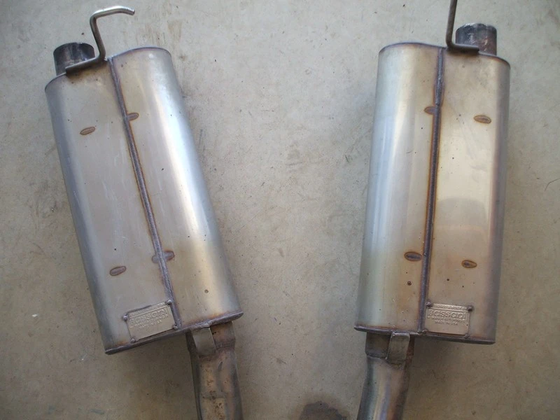

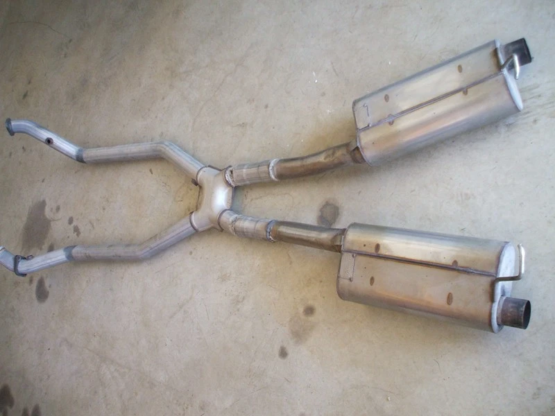

Thanks, heres a few pick of the one I was talkin about. What do you guys think. Its a BBK O/R mid pipe, and a Bassani Catback, but they've been welded together.
