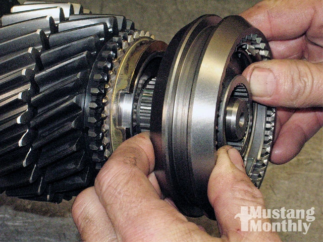

How much do you have to take apart?
Pretty much to the bare shafts. The synchronizers are mounted on the mainshaft adjacent to each gear. For instance (not a 3650 but same idea):
Getting at the components involves pulling the gears off the shaft. It's about as complete a disassembly as you'll find.
It's not "hard", really, but it does take some special tools and I wouldn't tackle it without at least a shop manual...
