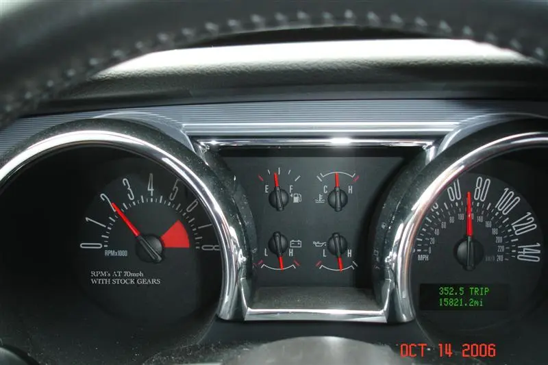

5 speed rpms at 70 with 373 and 355s

at 70mph
