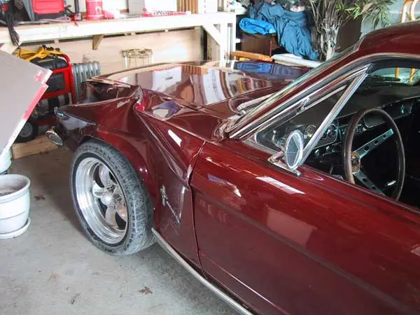

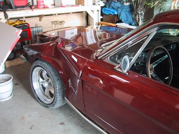

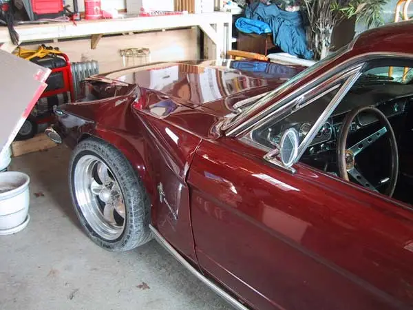

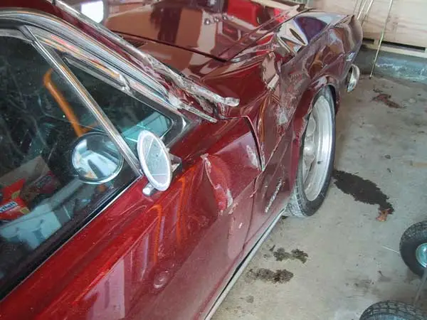

Here is what 400 RWHP looks like after bad weather and 70 MPH.
I've been using these 3 questions a lot in the last week....
1. What is the budget?
2. What is the use for the car? Street, Track, Both?
3. Aside from puffing up your chest and saying "I have 500 RWHP", what is the actually performance goal you want to meet?
you don't need 400 rwhp to do that kinda damage......:nono: .....70 mph, wet roads, especially newly wetted, the inherant handling (or lack therof) of the old technology canl get anybody there............don't beat yourself up
well maybe just a little for doing 70 in bad weather
glad your OK............

Dodgestang wrecked the car sometime back. It's been fixed for awhile.
My .02? That much hp out of a street car is only not usable but, a little unsafe. One mistake with the throttle and street tires turn into goo.
That much hp in a full on race car OK. Build the snot out of it. But as said before, full cage, suspention, tranny, rearend, brakes, driveshaft and some wheel tubs not to mention some MAJOR frame stiffening are going to need to happen.
The accident was back in Feb. do a search or go to my site...you can read all the details....driving under tractor trailers is fun.
All fixed...just ran 12.5s at the track with it. Just putting it up as an example....you spend $$$ on power, and you spend big money on suspension, and brakes, and wide tires, and then you might get a little overconfident about the car....add a little weather.....
