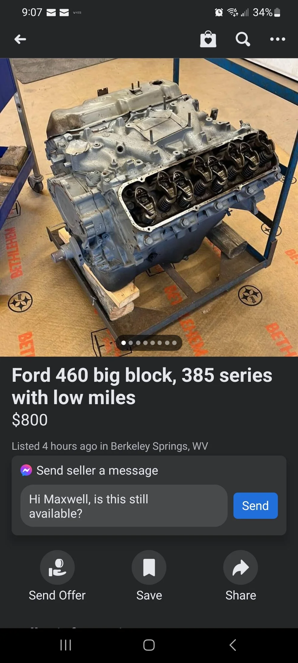

Ok. I'm bored and doing some thinking. A low mileage 460 bock has come up on FB for 800. It's an RV engine with 37k.
Heads are about 1300 from Summitt. Roller camshaft conversion about 1400. Intake about 400.
My brain is working on connecting it to my tko600. Has anyone here done this ?
With aluminum heads and intake it would weigh about as much as an iron 351. If I did this swap I'd get the engine punched out to a 501 with over 500lb.ft. torque.

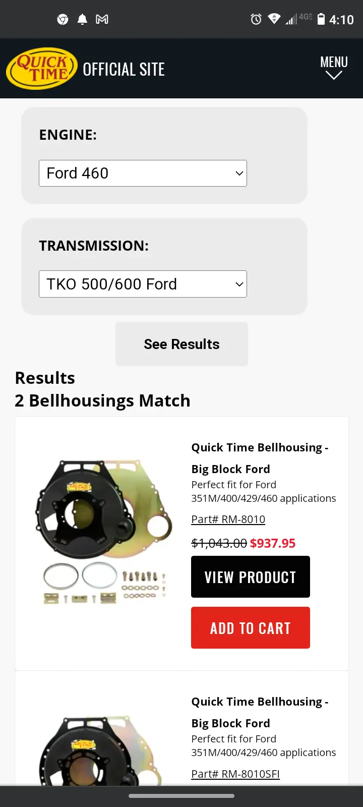

Right now, the hardest thing to sort out is everything needed to put the tko600 behind it. Might need to call Hanlon.

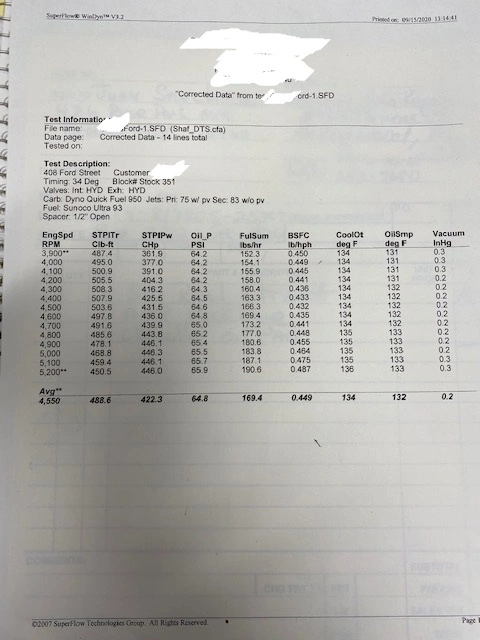

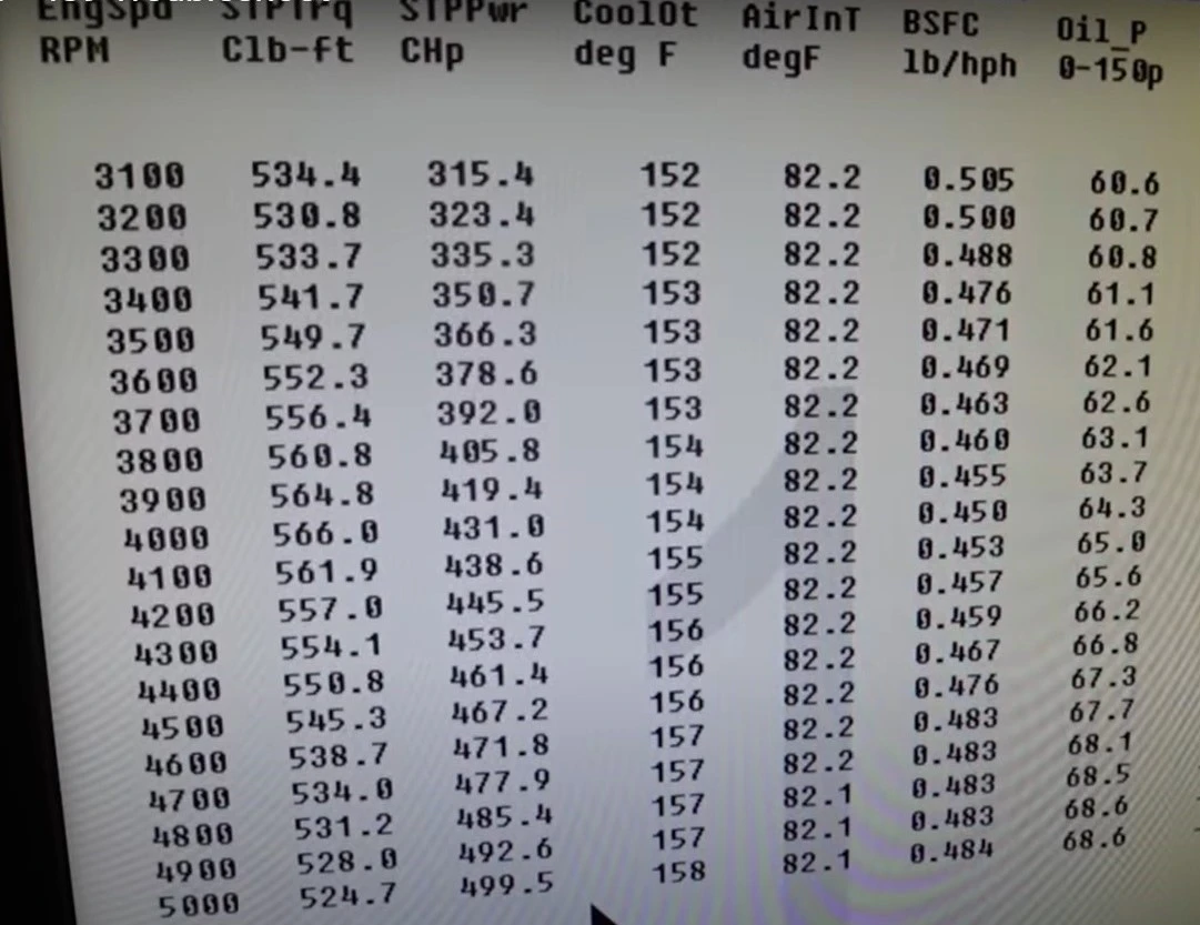

When I built my 408w its actually alot lighter than the stock 351w was ...LOL...
Two of my aluminum heads weigh the same as 1 cast iron head.........LOL
All of my pistons weigh 397 grams each and my stroker crankshaft is a few lbs lighter than stock......
This is just a dinky camshaft w/.477 .493 lift in a 408w on a carb. and Edelbrock E-Street heads w/small S/S valves........
On a rw dyno and EFI tuned on a chip with an intake designed to deliver 40-60ft lbs of extra torque and the same engine is putting out 566ftlbs of torque on a camshaft under .500" lift w/ Comp cams Magnum 1.6 ratio rockers....
Its the same as having bigblock power in whats essentially Fords midblock because it has a higher deck than a 302....
My setup has a TKO 600 trans and so far its holding up pretty well and I powershift it very often too and from some things that happened beyond my control due to a faulty Term X system and being sent 120lb injectors in a 36lb box its now a slightly larger 410w w/1.7 shaft mounted rockers...
When you build an engine where the torque and hp doesnt intersect you've built yourself one stout azz engine and mine is just a high torque low rpm application that will never see valve float......LOL
Even when it was stock it was pretty modified..It had a ported stock intake and throttlebody ,pedestal style stamped steel roller tip 1.7 rockers added ,,19lb injectors upgraded to 24lbers ,,MSD 6 box w/coil and timing adjust knob w/a custom tune burned into the speed density ECU by Kenne Bell done years back through Mustang Magic to reflect the changes and deletions and when dynoed it was putting down some pretty stout power too until blowby reared its ugly head at 565,000 miles..I modified it at 287,000 miles but as you can see the 408w kinda grew in size with that monster intake........LOL
