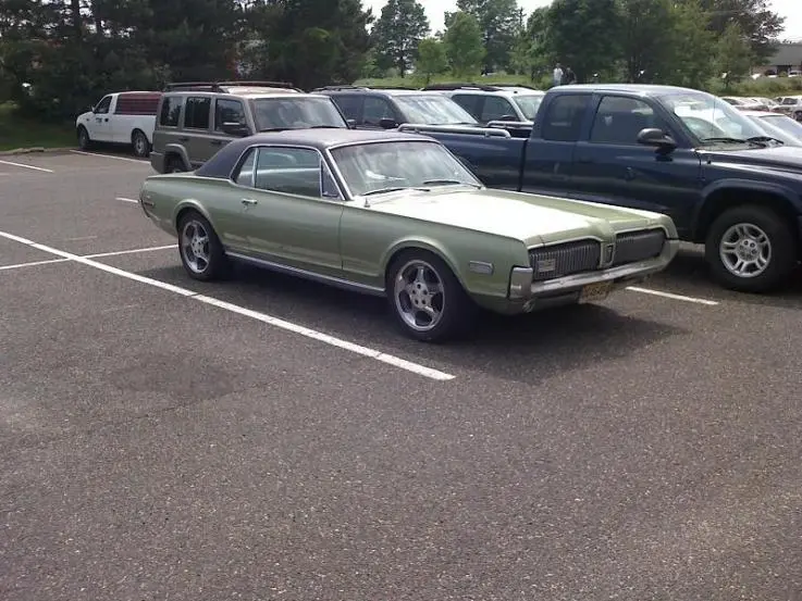

here's an idea of what 245/45/17 all around look like. This is my 68 cougar with 95 cobra rims (5.72 b.s.) and 1" spacers. I'm eventually going with 265/45/17's in the rear to fill it out more. I did roll the front fenders to be safe. The 245's will not fit in the front of a 65/66, I tried. 235's might fit but you'll need the Shelby drop, a really good alignment, rolled fenders and that's not guarantee that they won't hit on turns..
That's a mean looking cat you got! As of now I'm not planning to run anything bigger than 15" wheels/tires. Been looking at AR torq thrust d's with center's painted to match final color of car.:shrug:
