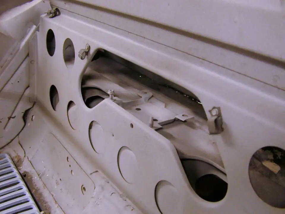

I am doing a manual to power top modification on my 65 Mustang. NPD sent all of the parts in just a couple of days. All the parts except one.
I cannot find the convertible pump mount. This is the bracket that connects to pump to the metal behind the seat. I have tried all of parts shops that I know of (7).
1. Does anybody know where I can buy this mount?
2. Does anybody have a picture so that I can make one.

Somebody must have a picture or at least a description of this darned bracket. I've looked in the factory manual and the parts manual. The closest thing I can find is in the exploded view in NPD's catalog.

IIRC, the bracket is part of all CV Mustangs. If nobody comes up with a photo by Monday, I'll snap one myself.

Better late than never. I always thought all Mustangs, whether they had a power top or not, had the bracket. The guys at the shop where I snapped this photo though so too, and they've been doing Mustangs over 30 years.

Thanks, this is a real help
I'm assuming that the 2 studs on the front of the bracket go through a donut washer fitted to the front "legs" of the pump.
I would guess that the 2 rear "legs" of the pump have a pointy rubber insert sits in the rear 2 holes of the bracket.
If the guy at the shop has a spare, I'd sure like to buy it.
BTW: Thanks, I have a much better idea now.
This is a great forum.
PJ
Yep.
Yep.
That's the odd part. They've never seen a convertible without one. I'll ask.
I suspect the bracket from any Mustang will do.

Thanks for the help
Getting the bracket from any mustang?
Close counts.
Once again, thanks for the help and thanks for checking.

Does anybody have a Convertible pump bracket they want to sell, or know where I might find one? I've googled for one and checked the parts companies. Nada

Try Glazier Nolan, they sell new and used parts, maybe they've parted a convertible recently. I've never seen a convertible without the bracket, your car must be a fluke- lucky you.
