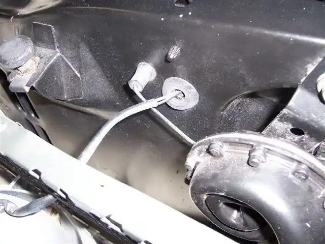

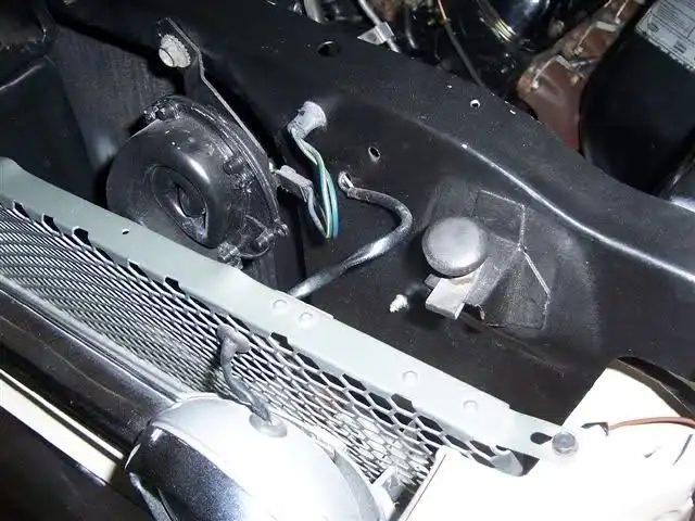

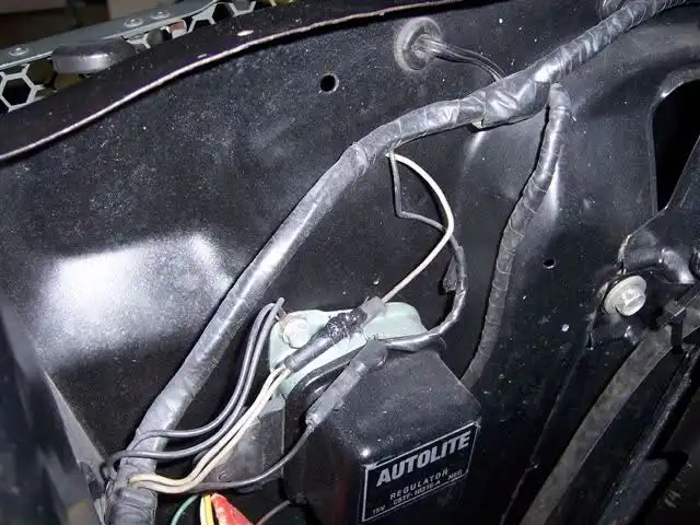

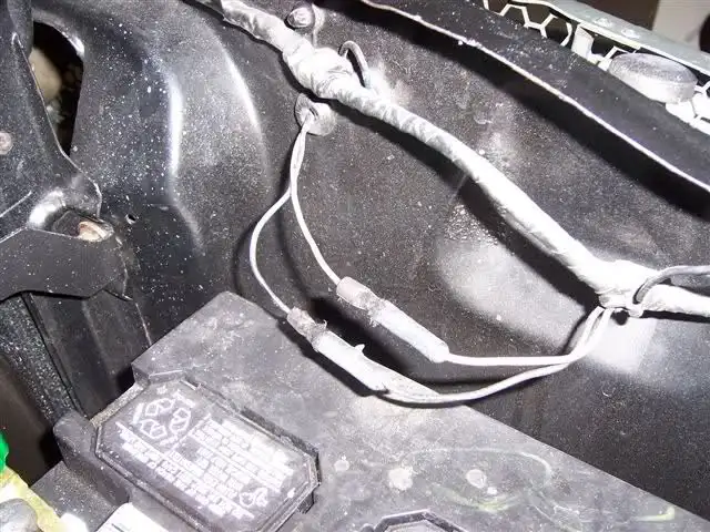

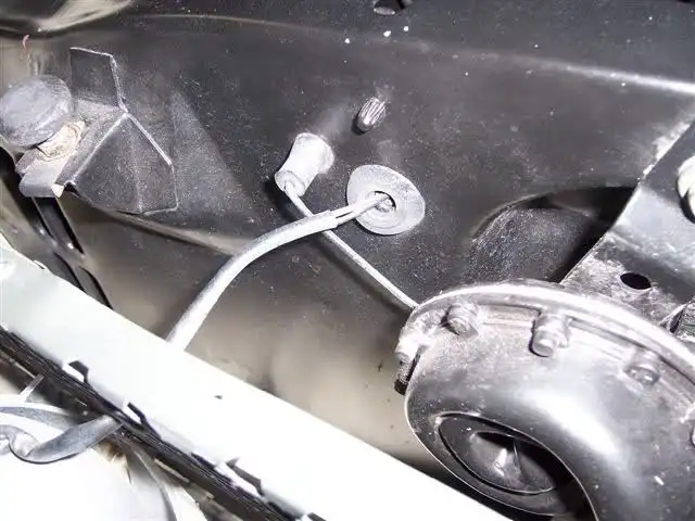

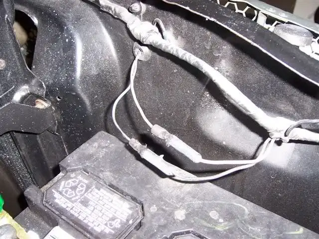

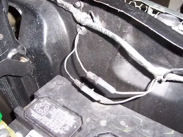

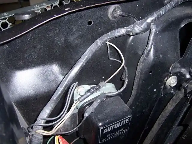

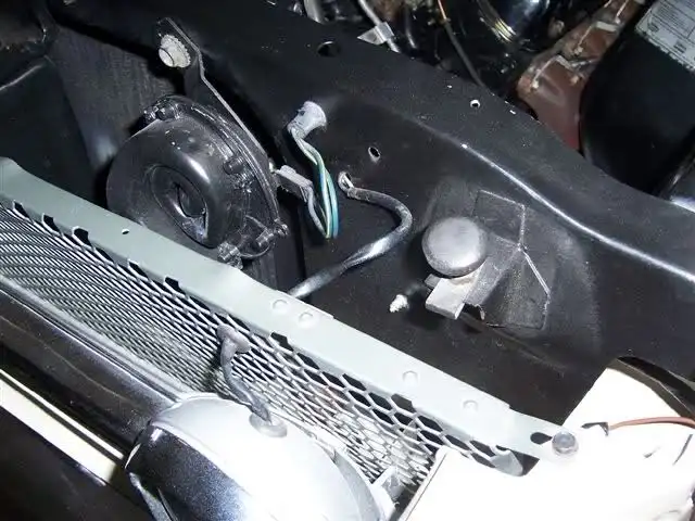

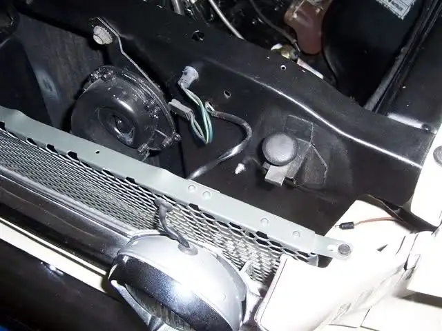

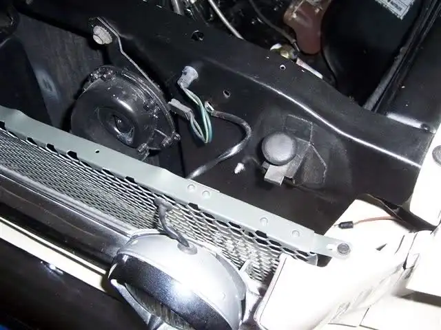

I have a 65 GT that at some time in the past had front end damage. Who ever replaced the radiator support did not route the wires for the fog lights properly as there were no holes. My question is, what is the proper location for these holes and what size should they be? What type of grommet did Ford use in the holes?
Hole is about 1/4 in diameter. Grommet is 1 1/8" outside diameter. Looks like I'm missing a grommet.

Yeah same here. I've been looking for them for a while too. Thanks for the pictures!
Does the fog light wiring have its own hole in the firewall? If your not sure thats ok.
I don't think there is a fog lite hole in firewall. From these pictures, it looks like fog lite wires are run out of main harness. I'll look at car tonite and if I suspect or learn anything different, I'll post another picture.
