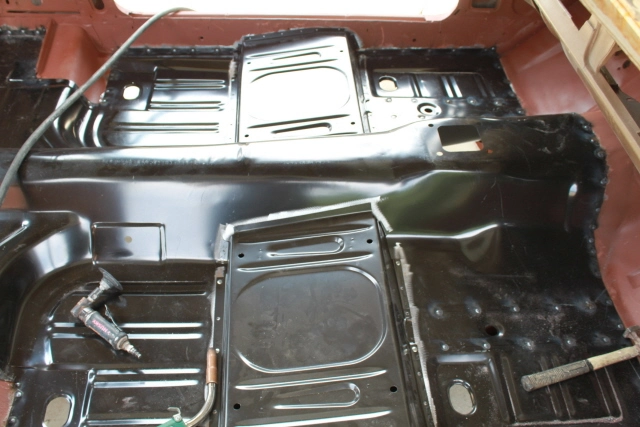

is it just a flat piece of sheet metal on the top inside layer?
it should look like this.
Yea, thats what I thought. Now that I've looked at the floor panels online, I'll have to look at it again and determine what is the original floor the outside layer or the inside.
It doesn't matter. From your description, it's all crap and 100% of it needs to be removed and replaced. The above photo shows a new one-piece floor, which is what you should do.
Yea that is the way I will go for sure. As far as the pic, I can't see it from inside the car. I'm only looking at it from under the car on a lift. The car has it's full interior still. So we'll see.
it sounds like your looking through the holes where you access the seats mounts and what your seeing it the bottom of the seat pan- the square bumps you see on the floor above.
That could be, I'll have to look at it again and see where this spot is in relation to the doors. I thought it was around the rear seat area, but I could be wrong. If it's right in the middle of the doors you may be right. This would be good, that means it never had floors and I don't have 2 issues to deal with.
