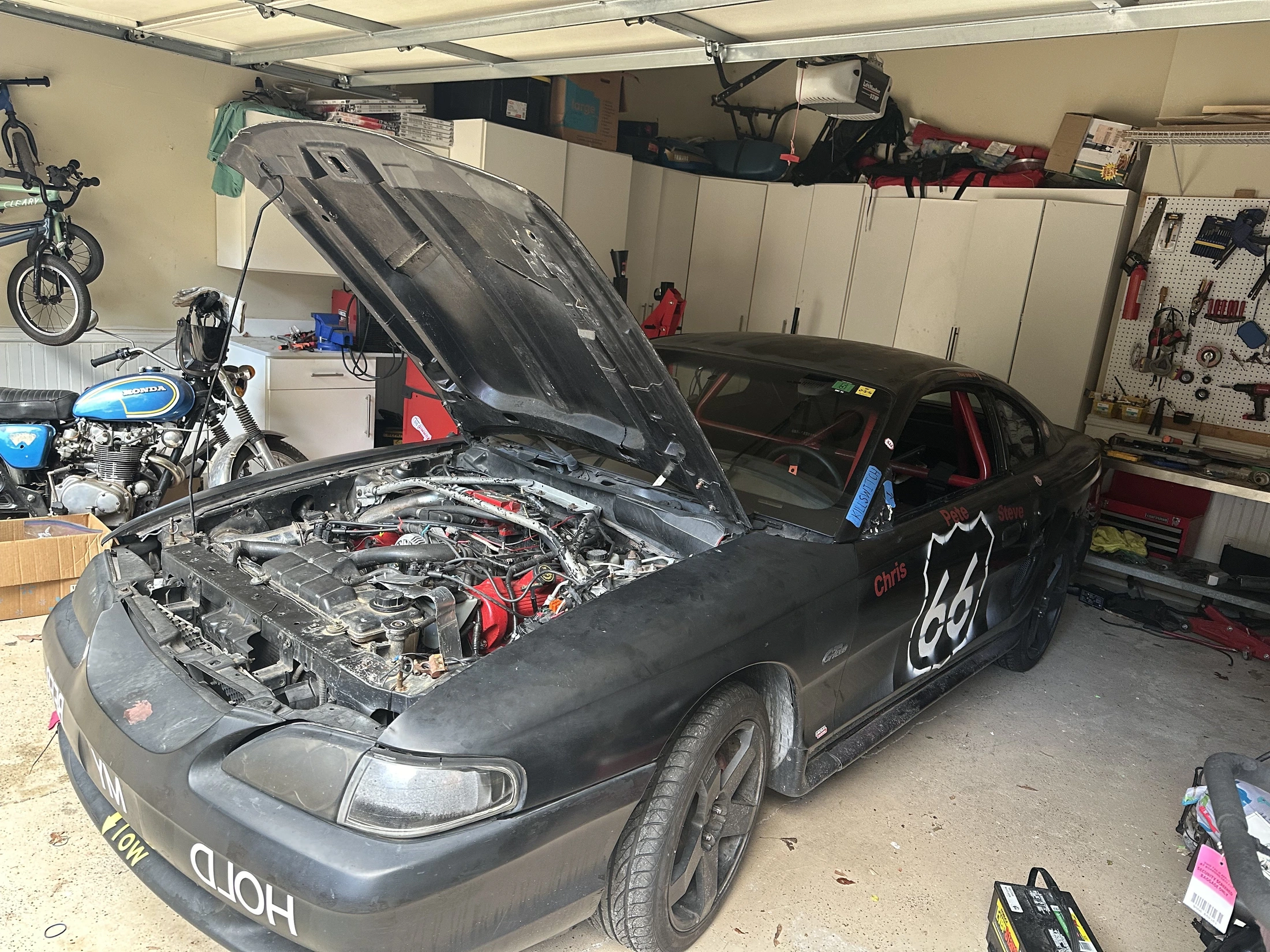

And here is a pick of the car, prior to taking out engine. If you zoom in you can just see the roll cage.
