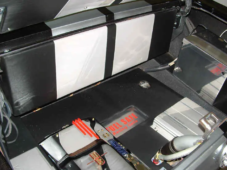

Here is how I did my trunk. The battery tray and aluminum box both bolt into a metal fram that is attached to the metal floor of the trunk.
No, I guess I should have clarified cuz it is confusing. I originally just had the tray in there with the battery and it looked funny, kind of unbalanced. So, I added the box for storage (tools, etc) and it balanced out the look.
Your trunk looks great gp001!
