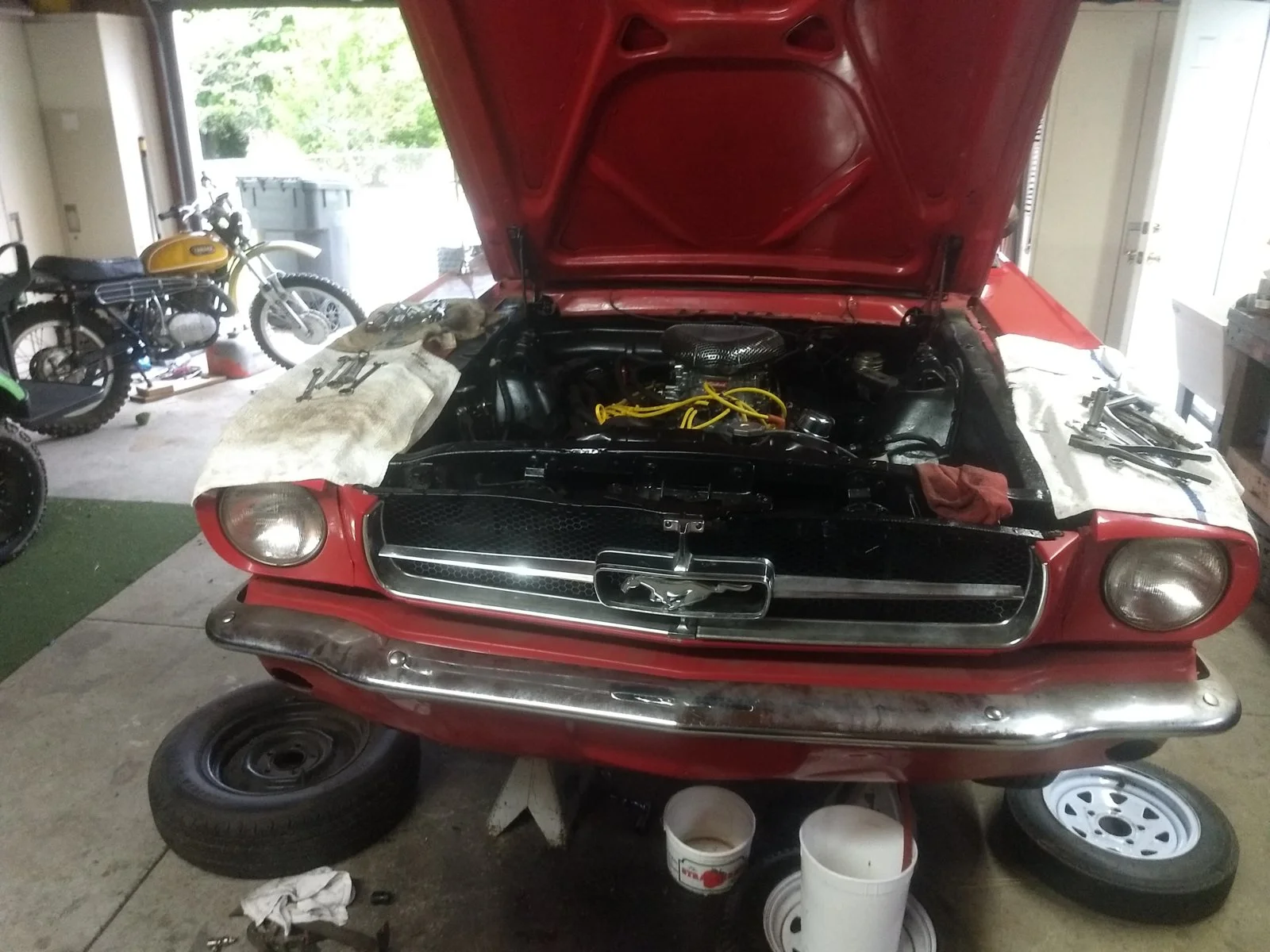

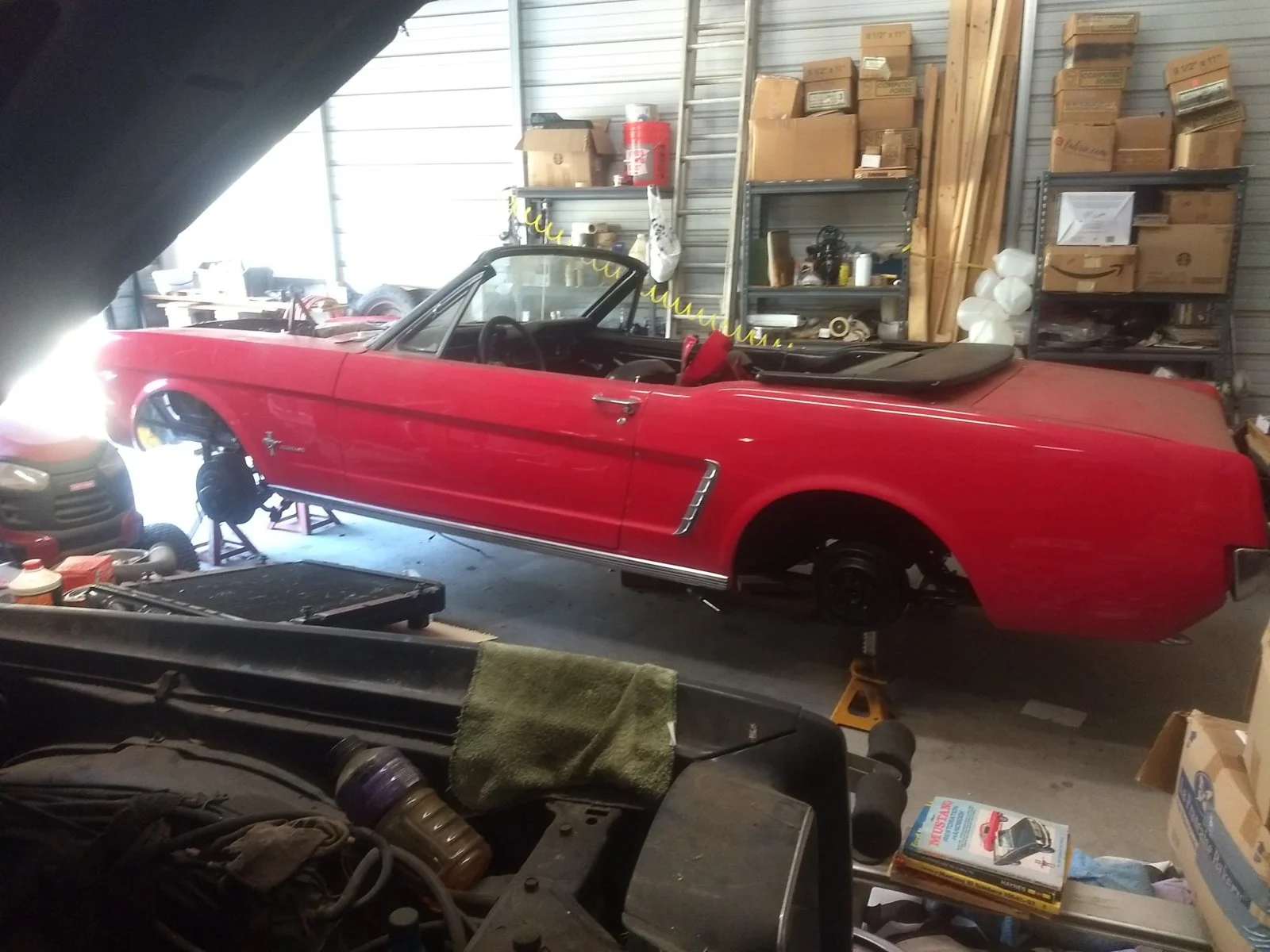

Getting there ..

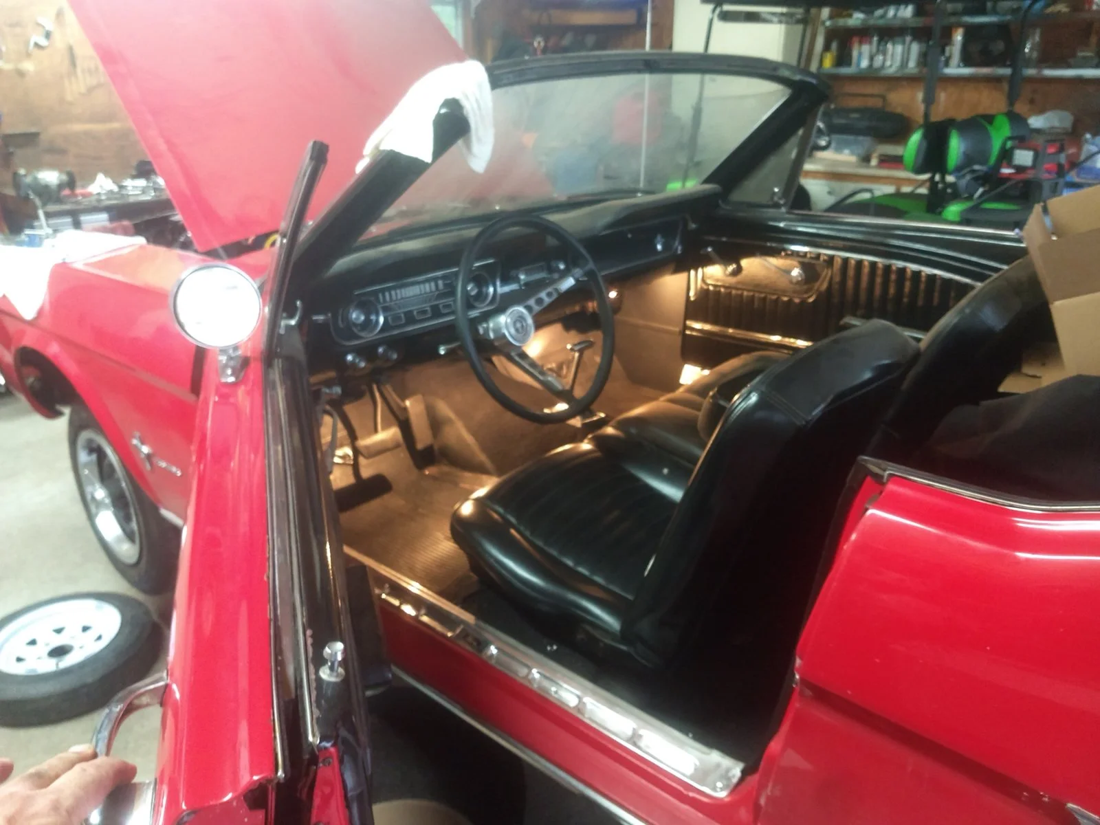

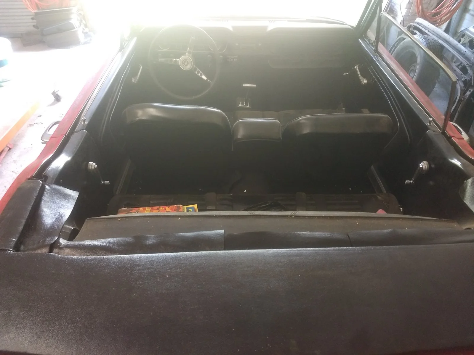

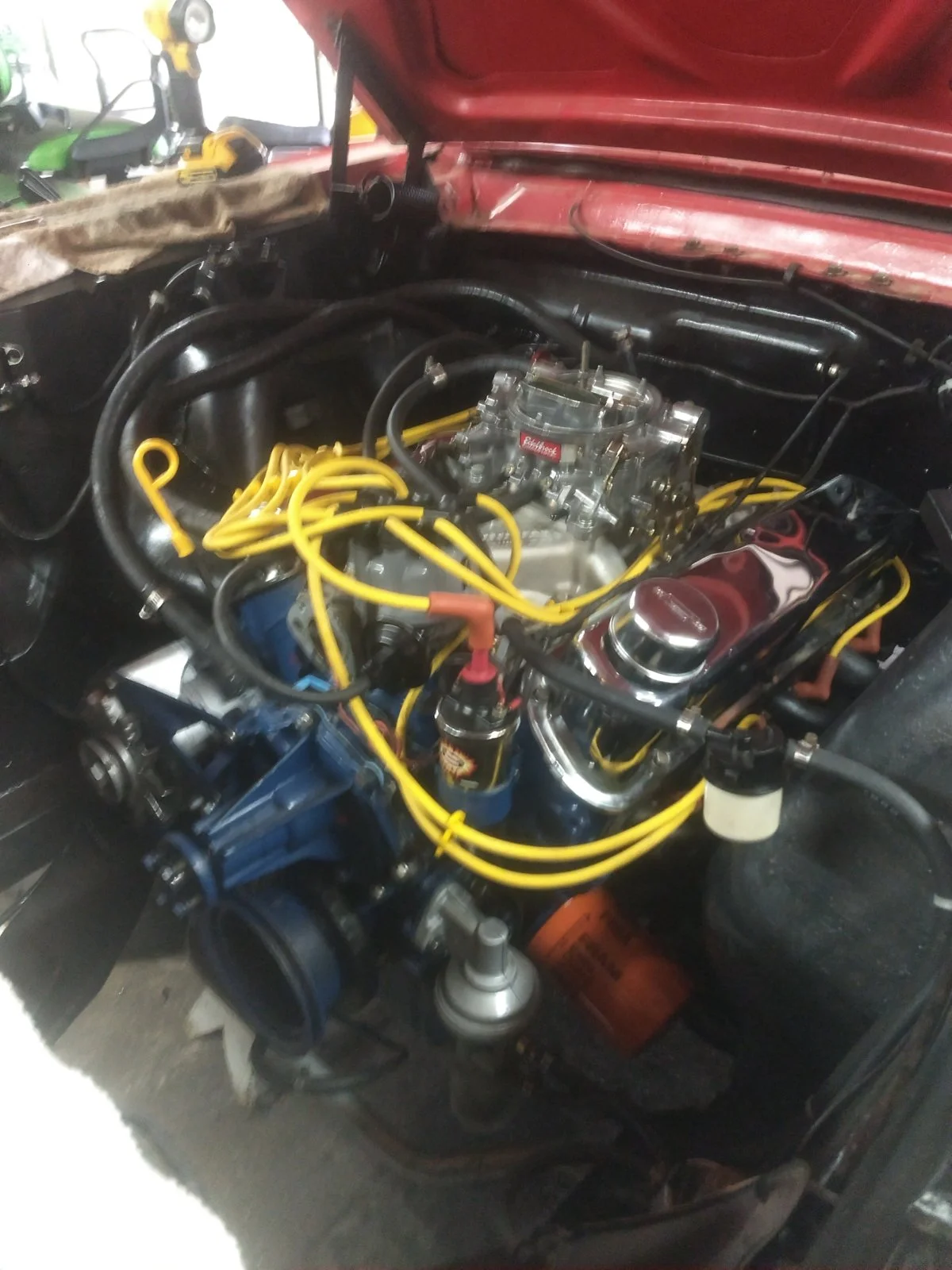

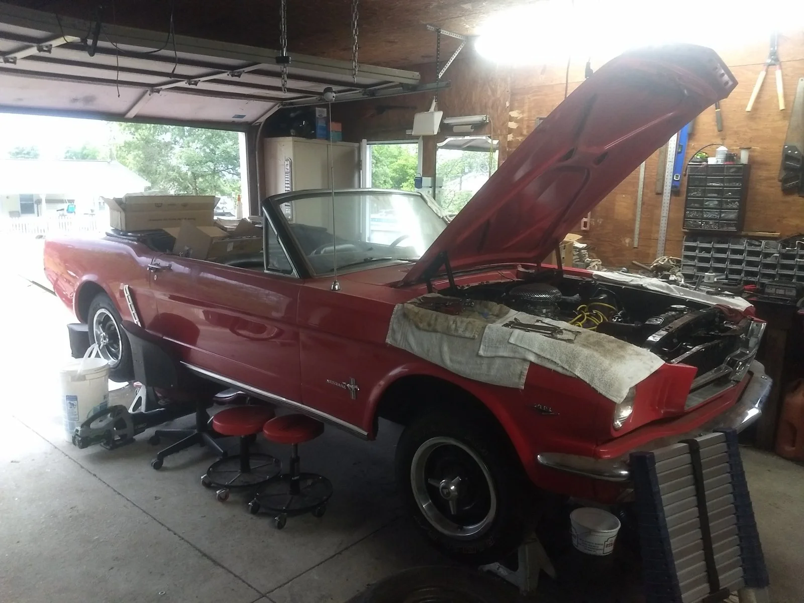

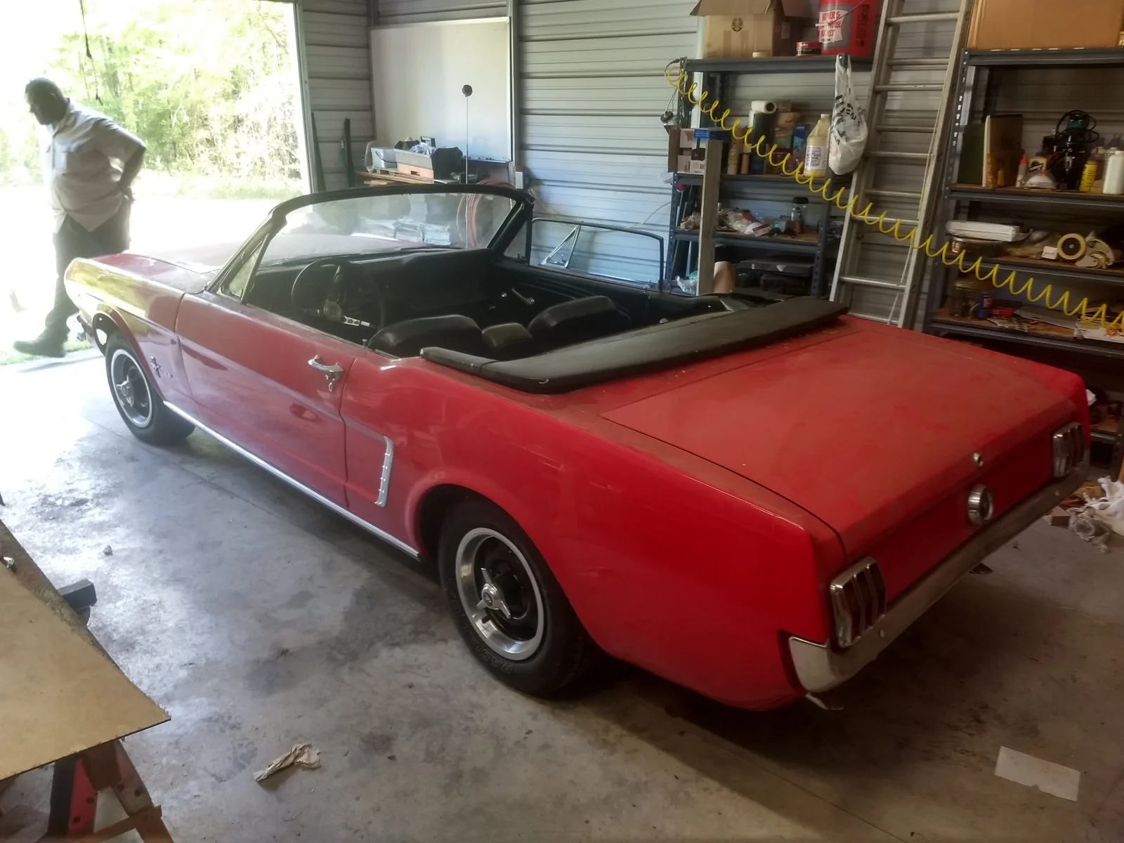

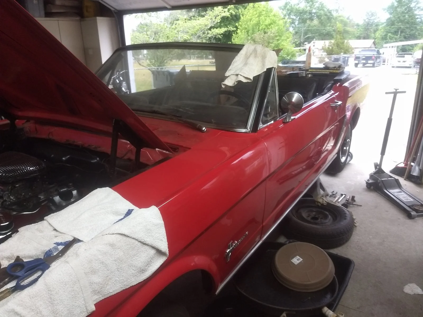

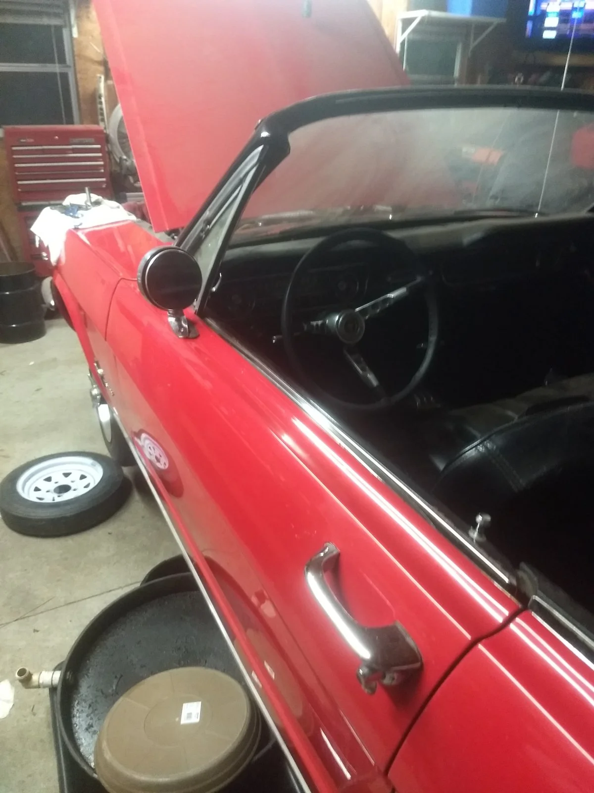

Recent pics. Waiting for fuel tank strai ER and will take her for a ride. Yes she's for sale. Accepting offers.
