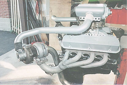

This went into a '67-'68. I know it is a little different. He used fox shorties facing forward.

The shorties work well, but they will not perform as well as a cast iron trubo manifold. That link with the mustang with the custom intake is a nice car but he did not opt for an intercooler. I wonder what his EGT'S are? Im sure they stay pretty hot. I would not even think about running one turbo with out an intercooler yet alone two turbos. The article did not get that in depth with his set up. I didnt even see a pyro inside there. If I was going to spend all that money you better bealive I would have at least one pyro in that car, preferable two, one on the down pipe and one pre turbo. Running with out monitering your set up is a one way ticket to a piston melt down for sure.
There is an awic on top of the carb. It is a Banks offshore model. EGT's do go up as a/f ratio goes up, but there are other variables that can cause the same thing. Wideband O2 seems the way to go.
