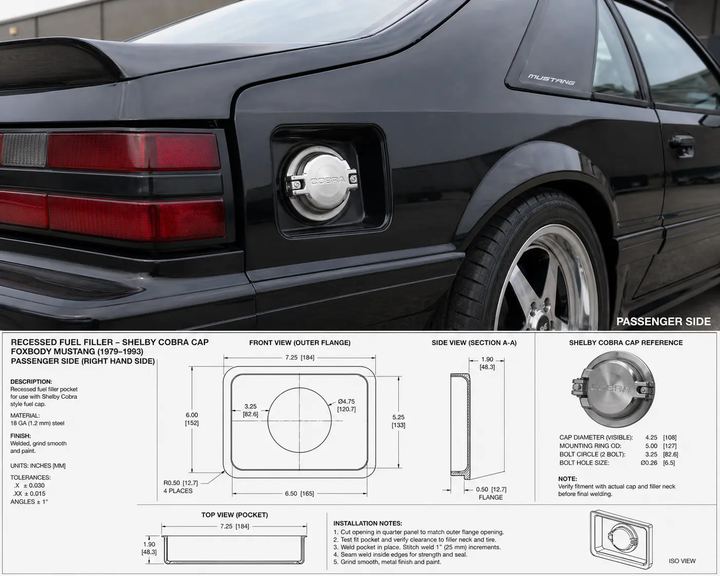

So I got to thinking about my ‘88 project today and wondered what it would look like if I removed the fuel door and added a Shelby style fuel cap ILO the factory setup.
I’m curious if anyone has ever seen or done anything like this before? I think it would be fairly straightforward but am I missing anything?
ChatGPT for the render.

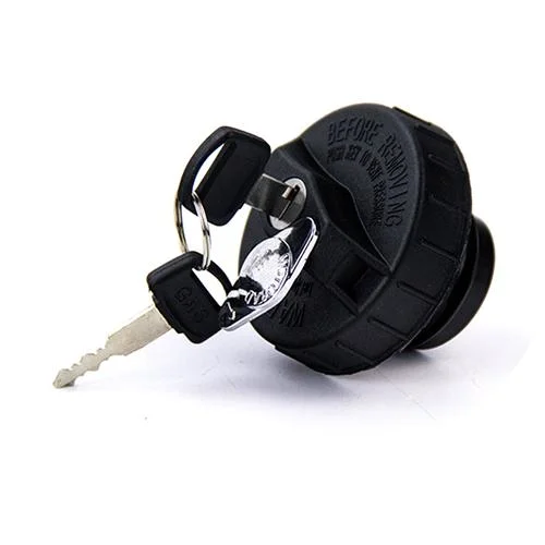

I put this on mine for peace of mind...
