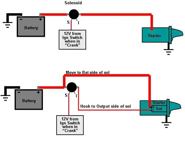

Here is a diagram of the before and after wiring for the starter.

  • #30
I think what we have been trying to say is that its easier to do it this way..
That is an easier way, but there is the potential issue of starter run-on. Here are a couple threads about mini-starter wiring:
