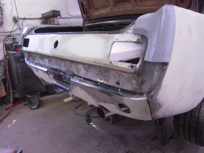

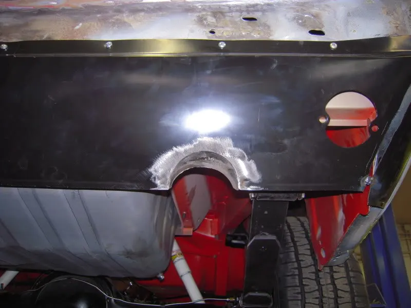

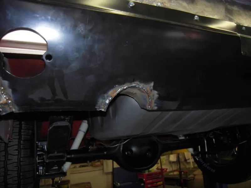

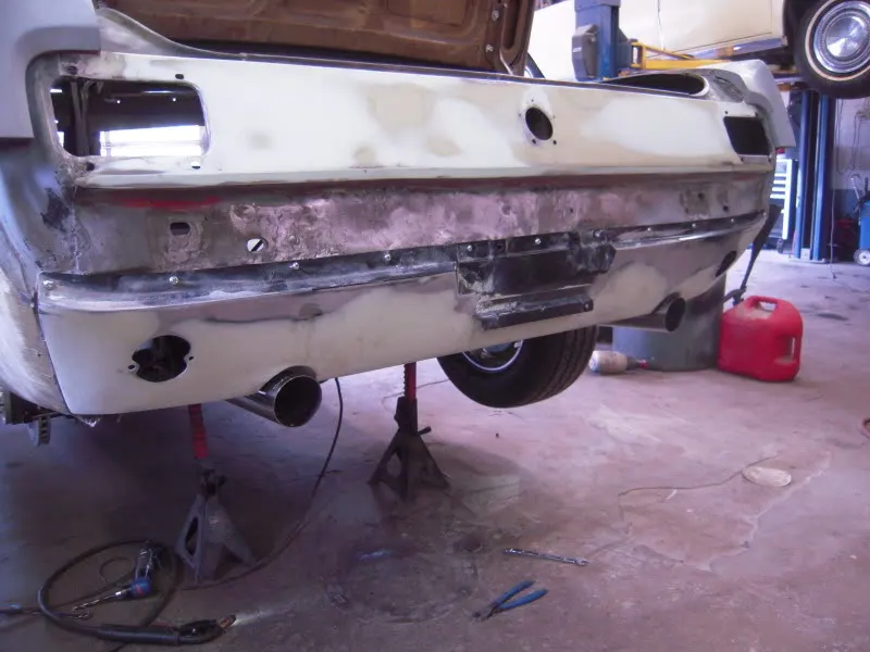

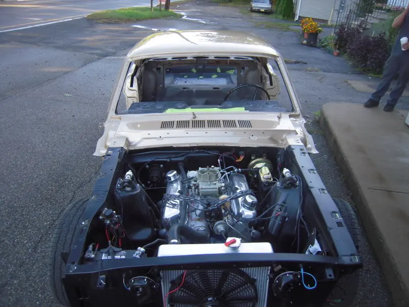

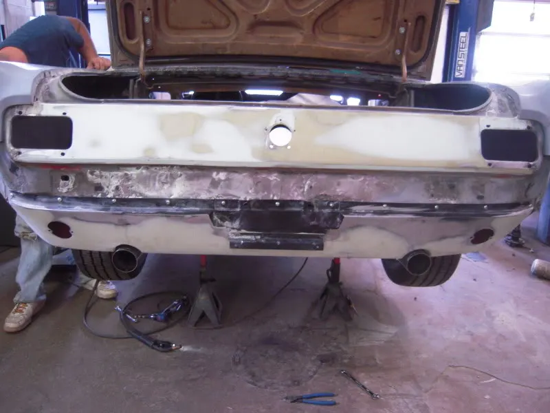

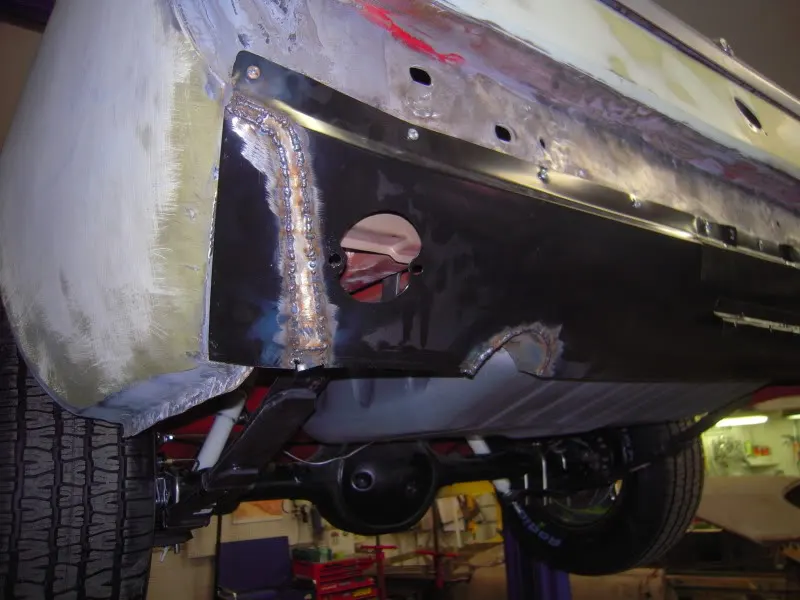

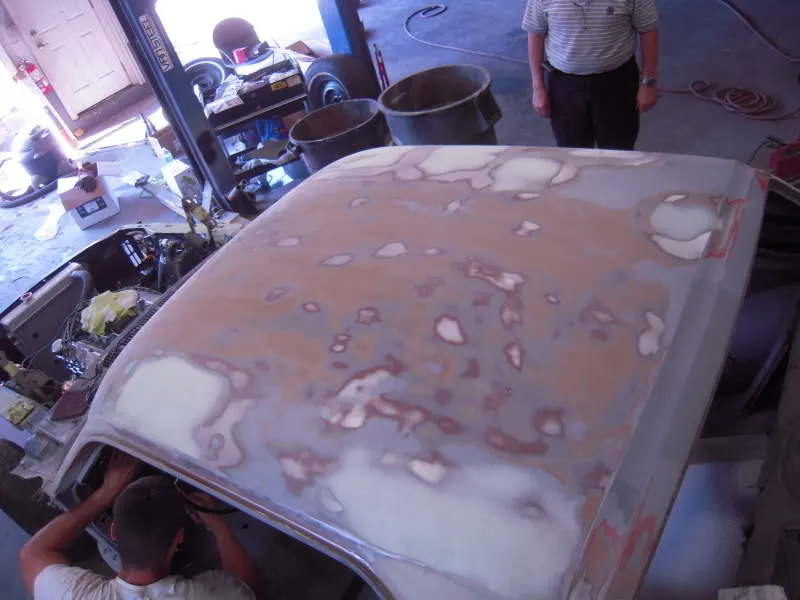

Hey guys, its been quite a while since I've updated this thread so here ya go. The motor has been run in at the engine builders but we are about the fire the beast up very soon. We've also been working on the body work for a little while and doin a "custom" rear valence and were very happy with the end results of that. It really cleans up the back end. We took some spare exhaust tubing we had and made tunnels for the exhaust and then welded them in and hammered the 1/4 inch "strengthening" hem on the bottom for a smoother look and had to extend each side out to match the quarters. These things fit horribly! It should be in polyester filler by Friday and then in prime next week! We can't wait to see this thing in color!

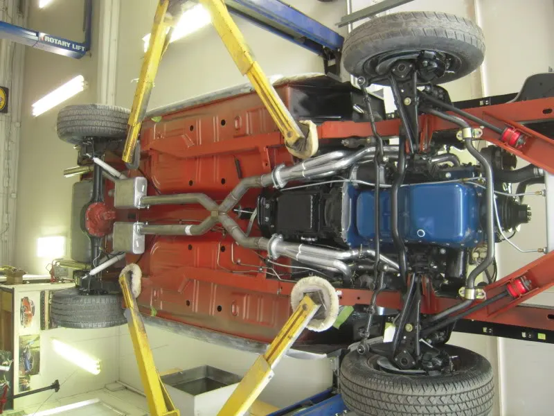

The engine is a 331 stroker with Pro Comp heads. Should be good for at least 350 horse. We re used the stock trans but had our trans guy beef it up with a shift kit. We also put a nine inch posi unit in the factory 8 inch rear. We're hoping in will hold up to the new found power!

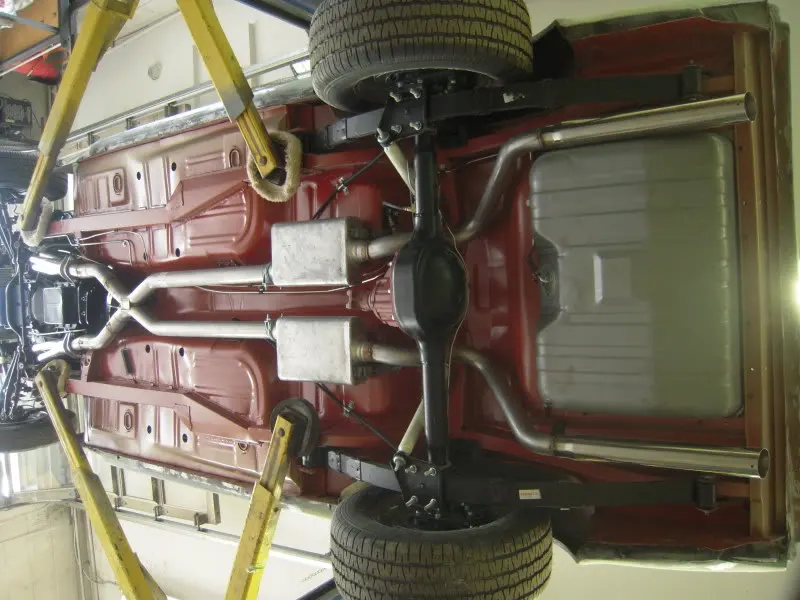

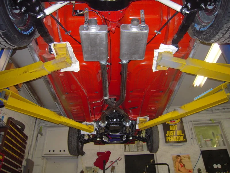

The exhaust set up is MAC long tubes into a universal Pypes X pipe (which worked out PERFECT for us) into MAC mufflers and flowmaster tailpipes with 3 inch Magnaflow tips. We can't wait to hear this thing fire up.

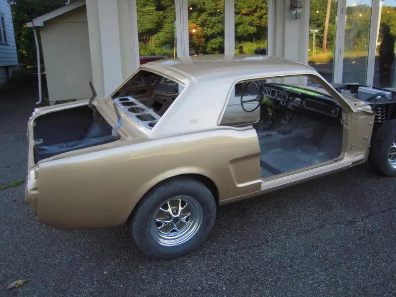

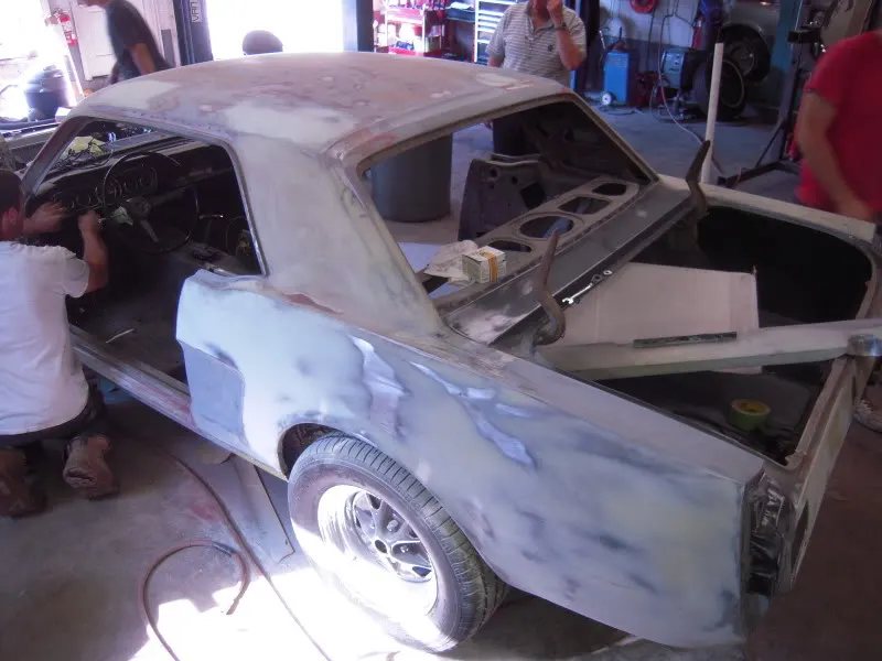

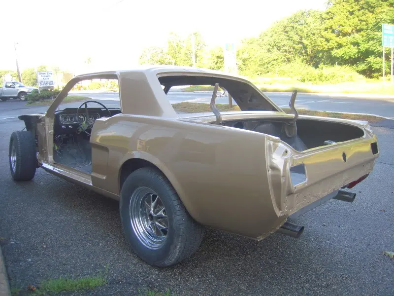

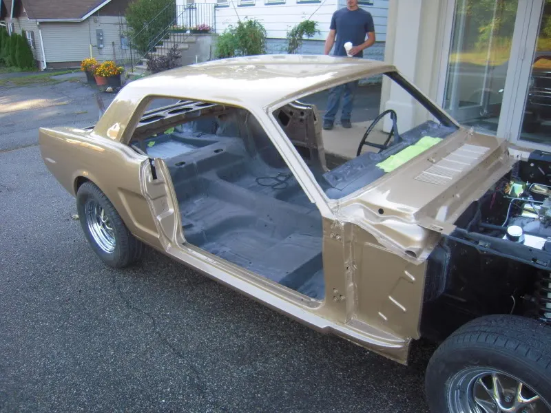

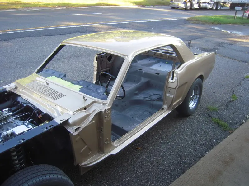

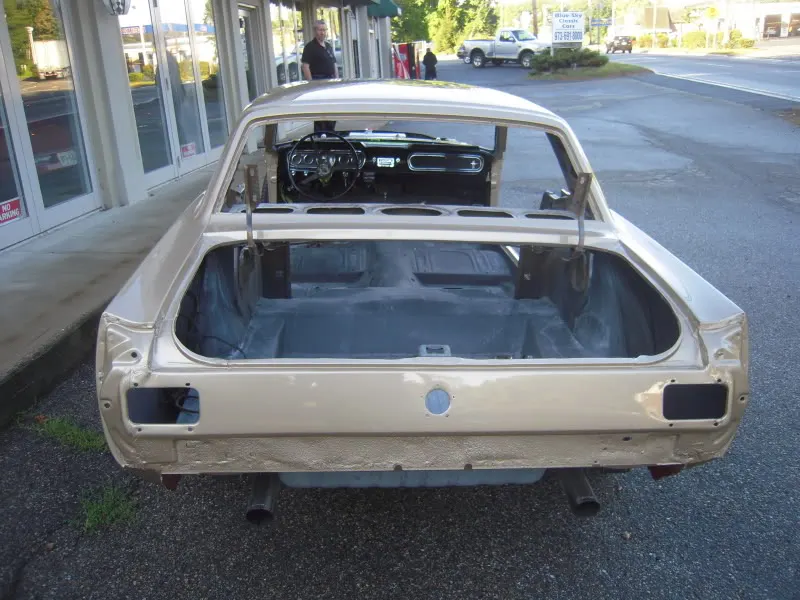

Ok guys, after a couple months of blocking and sanding, the car is shot! The parts are being painted today and the car should be re-assembled next week! We feel the color is perfect for the car. This car is going to be a beast when its all done!
