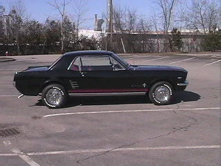

My backup lights don't work, the bulbs are new. I know there is a backup light switch and I think it is on the transmission but not sure, does anyone no where it is located. Also do these typically go bad or should I be looking at the wiring first?
