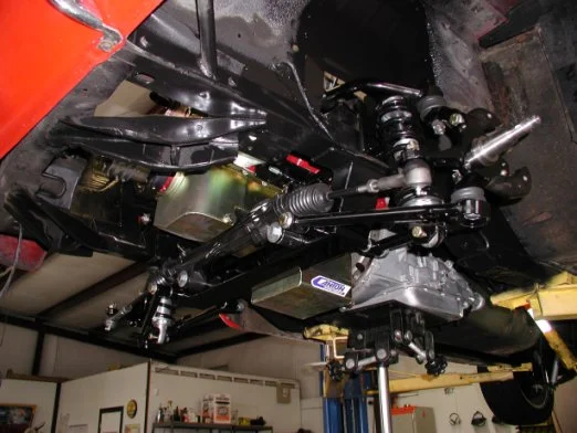

mtbdoc,
do you have any pics of your MII install? can i see how you did under the hood to make more room? Did you put new sides in the engine bay after the towers were removed?
Also your running 12 inch tires in the rear, what did you do for that?
I have a 68 Fastback that i am going to put a MII front in it, redo the engine compartment so it looks like there never was towers, then i wanna put a 9" in the rear and run 12 inch or wider tires WITHOUT ruining the interior with a tub. I still want the backseat to be fully functional.

Doc, nice rear subs, but the underside of that car is really rough. I would change the whole darn floor...
Did a recent article on our MII install last year. One of the magazine co's have been sitting on this for some time. Hope it helps...
http://www.mustangdepot.com/graphics/RoomforMore.pdf
Those are OLD pictures...lots of changes since then! Nice and shiny now.
