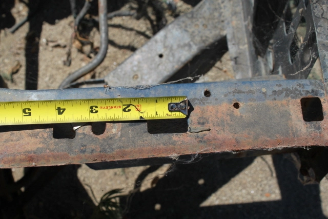

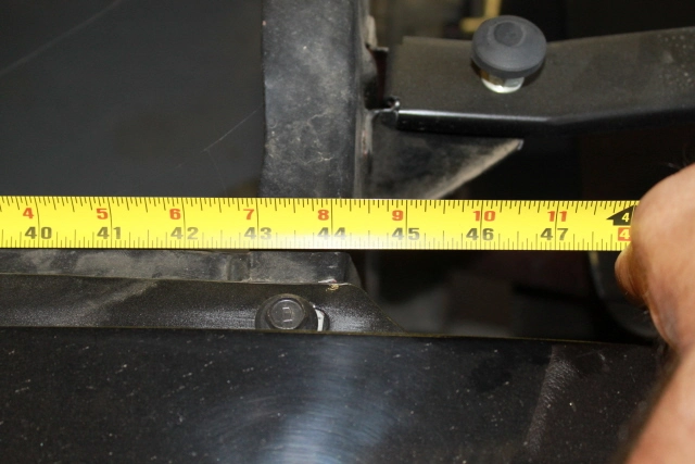

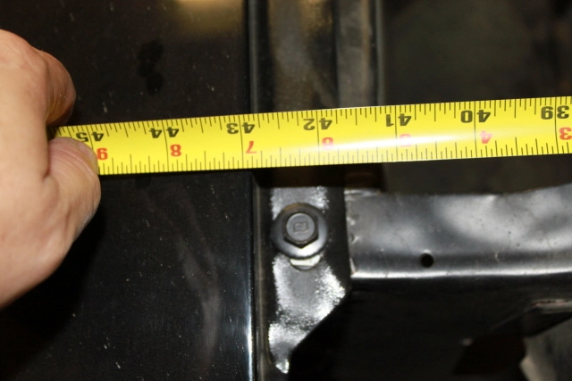

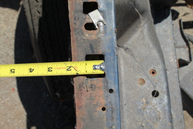

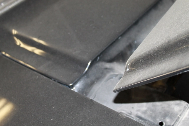

i took pictures but they may be hard to see,starting at the cowl top about 2 inches from the edge were the litle rise is measure to the front of the radiator support is 44 and 1/4 inches,across the front at the radiator support is 40 and 3/4 inches
at the cowl behind the hinges side to side is 40 inches these are all inside the panel measurements except the radiator support that is to the front of it. the cut outs for the hood bumpers are 1 and 1/4 inches long and 1 inch side to side wide , i measured three cars and believe it or not they all have different measurements, but all within a 1/8 inch one way or the other so if your with in an 1/8 inch of these measurements you should be good

That's helps quite a bit, thanks for the reply. I know that the actual location may vary depending on how the fenders and hood fit, but I at least wanted to get the holes the right size since I don't have an example to look at.
