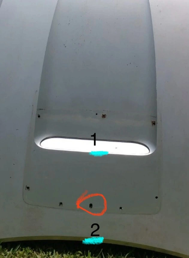

Putting an 01-04 scoop on my ‘00. I can make a template but need to know where to locate it.
Does anyone have a hood with the scoop off and can get either dimension below for me?
I want to locate the hole circled in red to either the back edge of the hood of the lip of the little scoop as shown. Anyone got a good kicking around?
If it ever comes up in a search, the answer is the hole circles in red is 6.25” from the rear edge of the hood. Center it, drill this hole and then you can work everything off this location.
