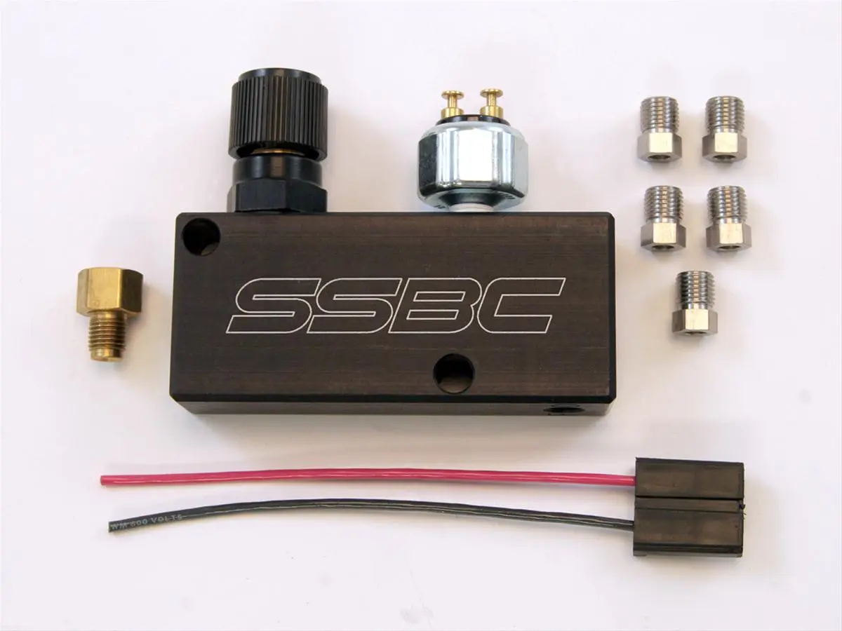

I lean towards these
Post pics of your car please.

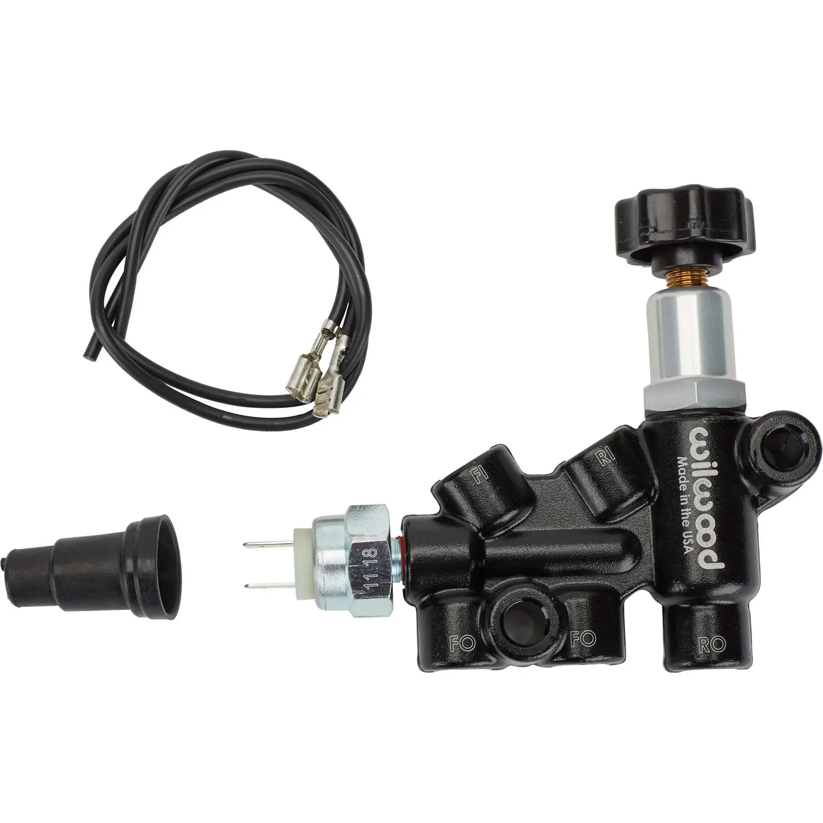

Sorry to hijack the thread but I have a quick question regarding disc swaps as well that doesn't really warrant its own thread. I currently have the Wilwood prop valve and am planning to run drums in the rear (discs in the front) until I pick up a new rear end when i'll go to discs. Can i just run the prop valve adjusted for the drums for now then readjust the flow rate for the discs when i perform the swap? I don't see why this wouldn't work, however on other threads guys were basically saying you have to have a special master cylinder for disc/drum which doesn't make a whole lot of sense to me, since the prop valve will limit flow rate to the rears for now... Just looking for the thumbs up before I proceed.

Comes down to MC bore, bais, and volume of fluid pushed.
There is often a different size Master cylinder bore for the kind of calipers (read volume needed) you use.
Having the wrong MC bore can make a power system have a harder pedal than a manual system.
What kind of car / weight is involved. Is it power now? Will it be in future? MC higher than brakes?
ie. the 67 mustang disc/drum master won't push enough fluid to rears to work the old Lincoln Versailles 9-inch rear-disc swap.
Bottom line you need a MC to match your system component choices.

It is a 1" wilwood master cyl attached to a 7" booster. I based the master cyl bore off of other disc kits and disc/drum kits having 1" bores. Front discs are 4 piston dynalites, rears will probably be either explorer discs if I go ahead and narrow an 8.8 or whatever comes with QP Performace 9" rears if i do that.
