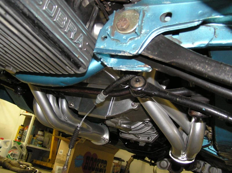

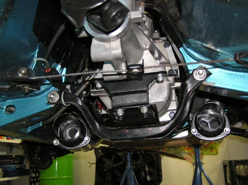

Hello,
i use hooker competition long tubes ceramic coated (#6901) in my 67 fastback. Engine is a 331 stroker with tremec tko. The headers fit absolutely perfect. My are polyurethane motor mounts from prothane (#6-503) and they fit with the headers too.
But, cable clutch is a no go. I use a JMC hydraulic clutch setup.
