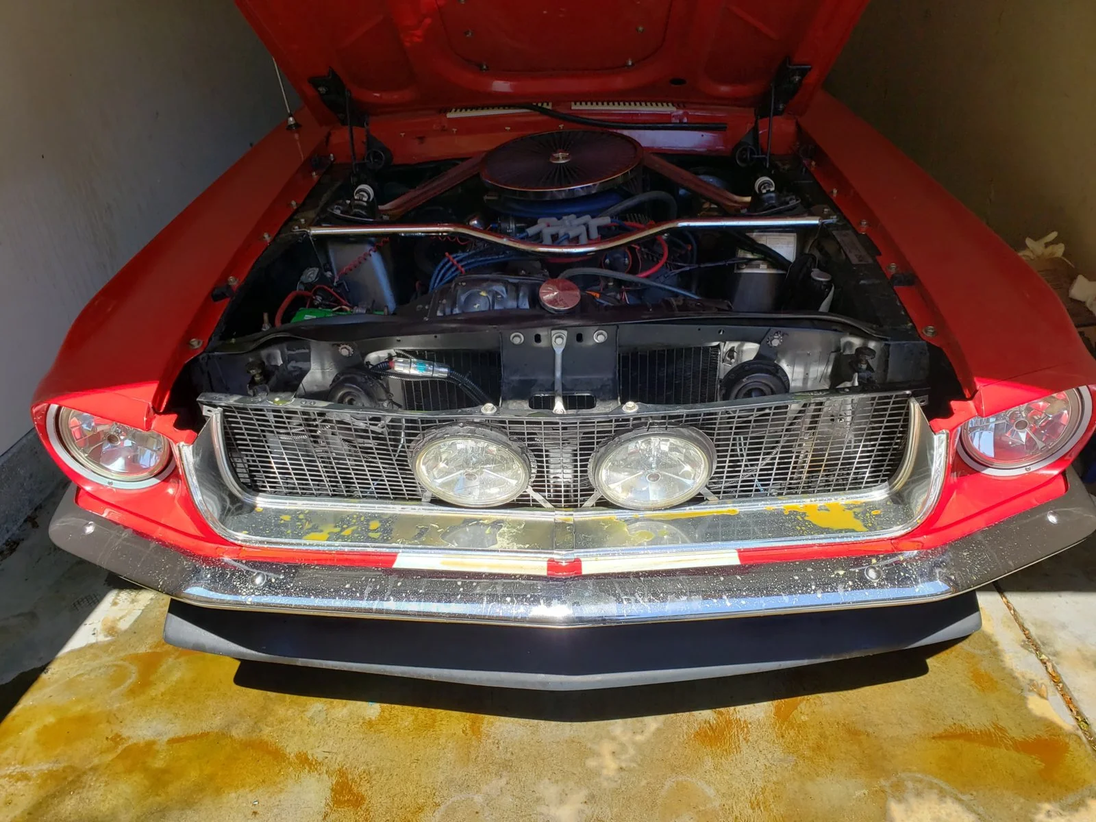

I own a 67 289 Mustang and I've been having some pretty major cooling issues. About a month ago I was washing my car and I noticed the battery sounded low on startup. So I was letting it run to see if I could charge up the battery and after about 10ish minutes my radiator proceeded to explode... literally. As i was turning off the car i noticed the water temp was sitting at about 230 which is maxed on my cars gauge. (usually I'm sitting at about 165-175 or 180 to 185 if I'm hotrodding around.)
So I decided to replace just about everything I could think of. New aluminum radiator(3 row), new water pump(something I was planning on doing soon anyways), new thermostat and thermostat housing, and new hoses and clamps. I used Permatex Grey on all my gaskets. I went with a 60/40 Prestone coolant mix and started her up. I let her idle for about 10 mins before taking her around the corner and in a span of about 60 seconds the water temp went from 170 to 200 and by the time I was back at my garage it was 215 and rising still.
I'm looking for any ideas as to what could be causing this. I plan on going to get the system flushed as soon as I can.
Thank you for any help.

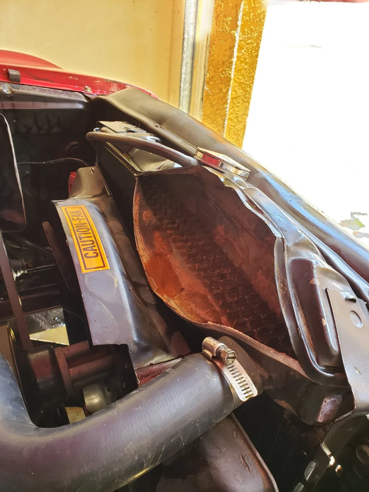

Radiator shroud appears to be cut, or modified. Shroud should be a 360 degree circle with proper shroud to fan blade clearance, fan to radiator clearance, blade angle, proper blade rotation direction & correct shroud depth.

Thank you for the response!
I've been doing a little research and I'm now thinking I have a blown head gasket. I'm getting white smoke out of the exhaust and my coolant level is going down even though I don't have any leaks. I'm assuming there is a breakage in the gasket between my coolant channel and combustion chamber which would explain both of these symptoms.
I regards to the fan shroud. They are actually cut like that so they make room for the intake and return for the radiator hoses. if you look up new ones they have the same cuts. The new radiator I bought has a 13lb relief so i have that covered now.
Thanks again for the suggestions!
-Matt

Roger that regarding your shroud.
