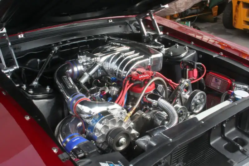

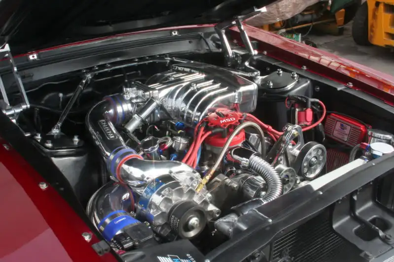

Has anyone ever stuffed a Procharger under the hood of a classic Mustang? I have a P600B Procharger kit and was wondering how it would fit in my 67 Mustang on the new 331 Stroker. My engine is out at the machine shop and was trying to figure out what I may need to make it fit in my car. If anyone has any pictures of their setup and would like to post them that would be great.
I have a Vortech blower on my car. It is not a direct bolt in. It will require some fabrication skills to deal with alternator clearance (interferes with strut rod support) and the air inlet. Not that bad but just takes some time and thought.
