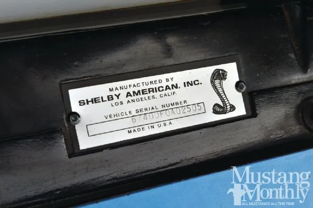

Hi, you can usually look UNDER the fender at the Ford VIN from the bottom side, and possibly scrap off some paint/undercoating, to read the VIN without damaging the visible paint on top of the VIN. However, a 67 Shelby Mustang should have a Shelby VIN, different from the Ford one, stamped to a plate which came riveted over top of the Ford VIN.

Additionally, if it seems you actually found a Shelby, contact the Shelby American Auto Club (SAAC) 1967 Registrar as he can confirm the authenticity of your newly discovered car:
