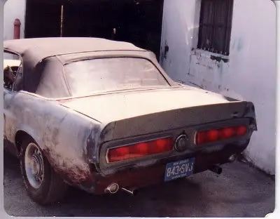

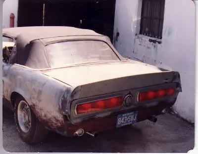

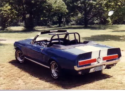

Like this?
Before paint...
When I did this back in 1983, I had to sabre saw most of the taillight panel away, as the Cougar tailight housings are very deep. The original Shelbys had a new panel welded in to mount the back of the taillight assemblies. If you can, find a 67 Shelby, and see how it was done. I also am guessing you will be replacing your trunklid & caps with Shelby-style parts, as the stockers will not fit.

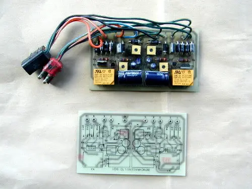

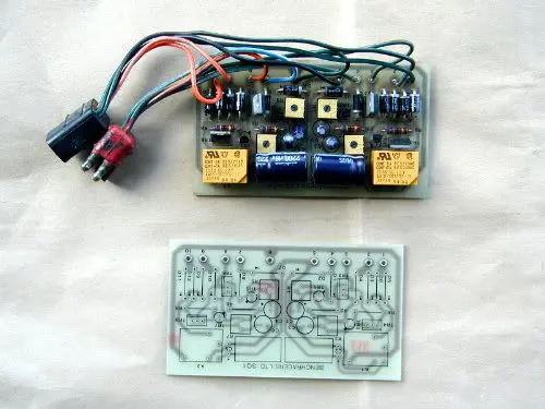

Also, I have been selling for years a sequential unit that mounts in the trunk, and will make your lights work sequentially. Same size as the 69-73 Cougar unit, without the wiring hassle! $80.00 + S&H. Here's the unit:
