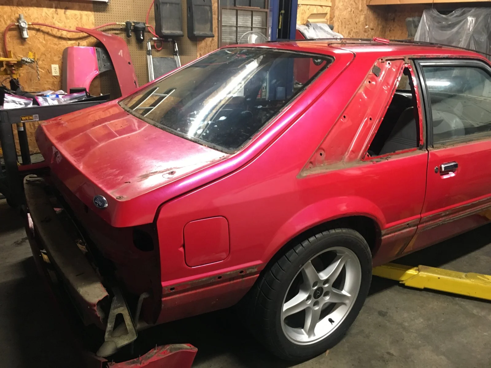

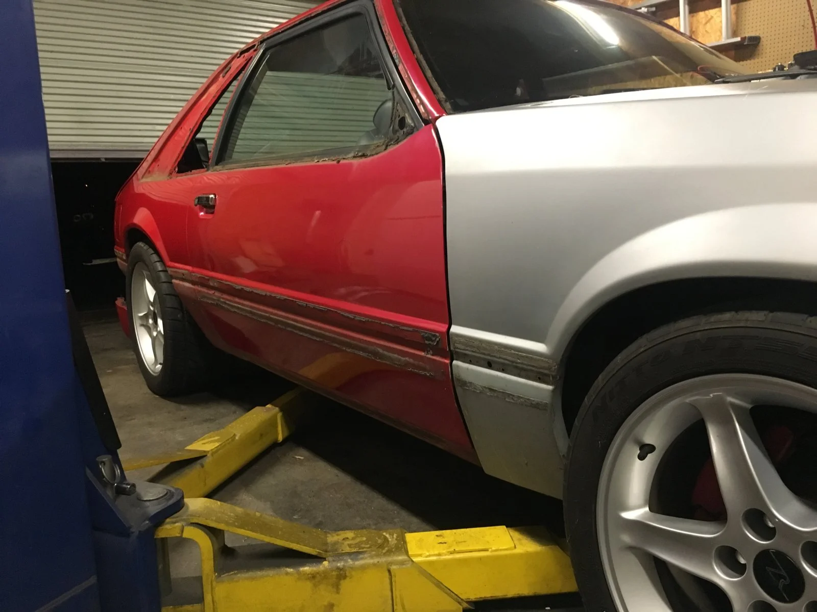

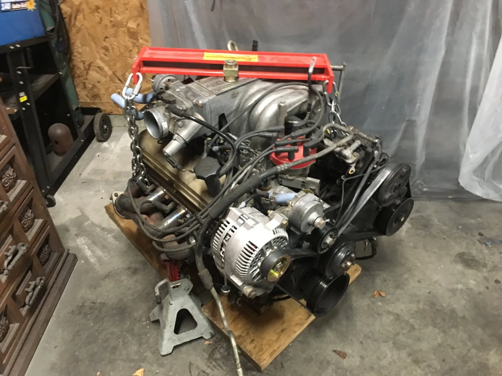

Lost the last 5 days due a pretty bad head cold. Feeling better now. After a full day of work, we removed all GT ground effects, front and rear bumpers, quarter windows and most of the trim.
Engine is coming out tomorrow and we may even start some body work.

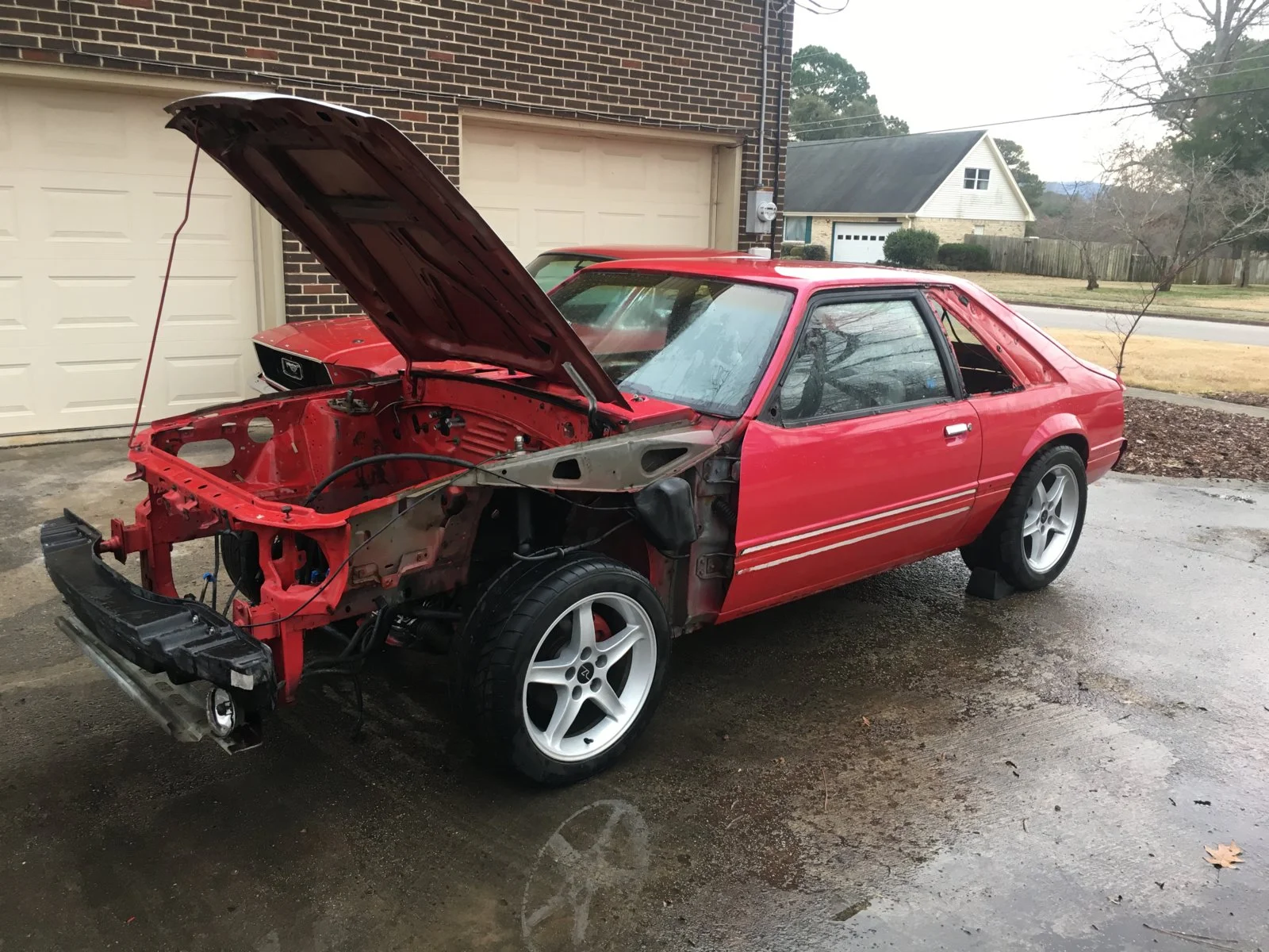

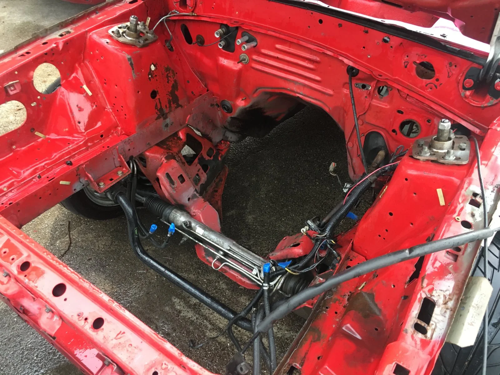

Haven’t had a chance to update our progress. We’ve been putting in some pretty long days.

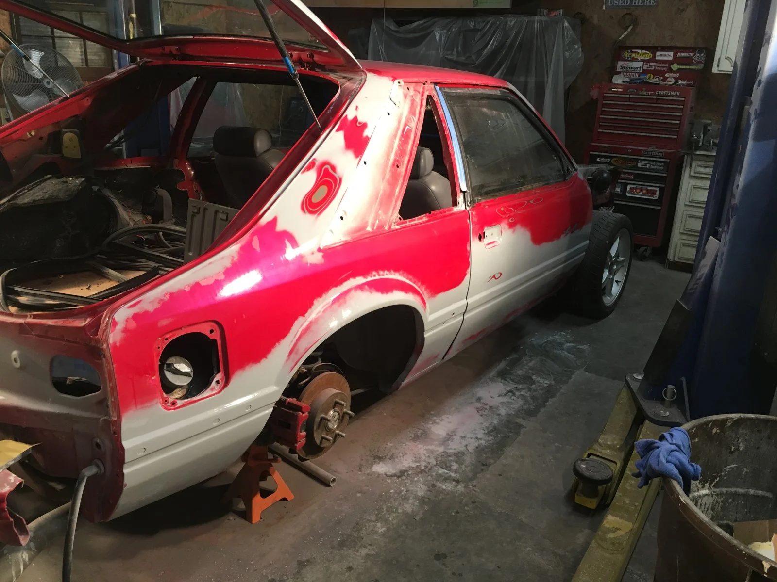

We’ve finish disassembly. Engine and transmission are out. Engine bay is stripped and power washed.
The holes for the GT spoiler have been welded up, body worked and shot with DTM.

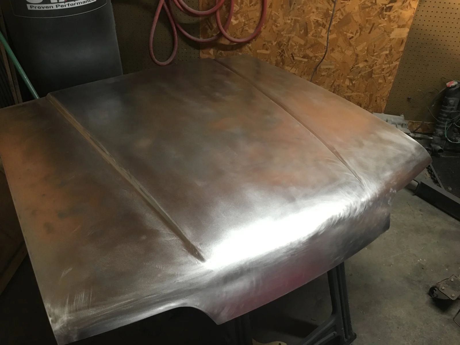

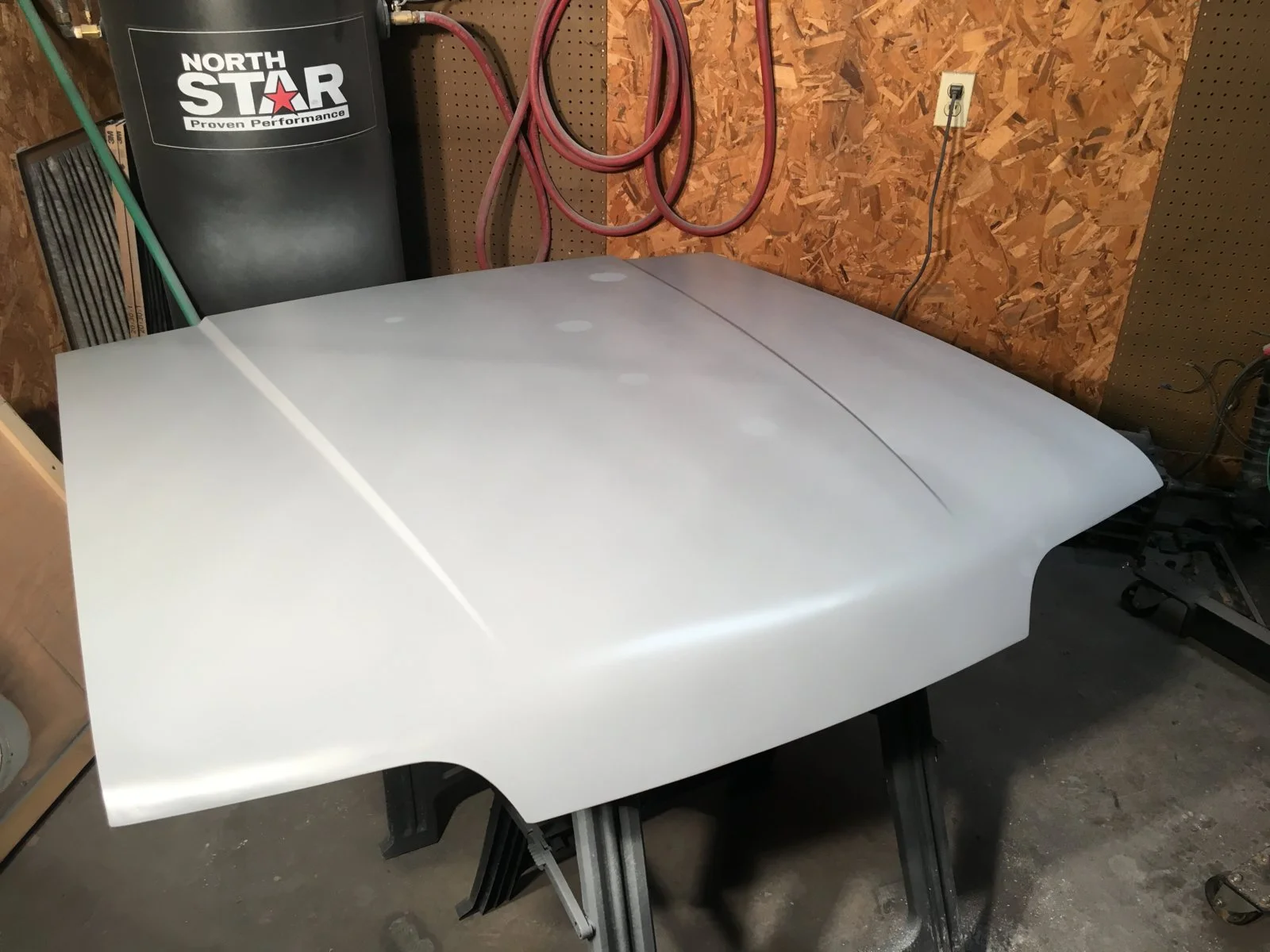

Yeah. We were feeling overwhelmed after the problem with the hood. But much better now after stripping the old paint, filling a few dents and finally getting a good coat of DTM on the hood.
Got a little more prep to go before spraying the body worked areas with high build primer. Hope to have that finished this weekend. After that, it’s prep for sealer then we’re ready for color!

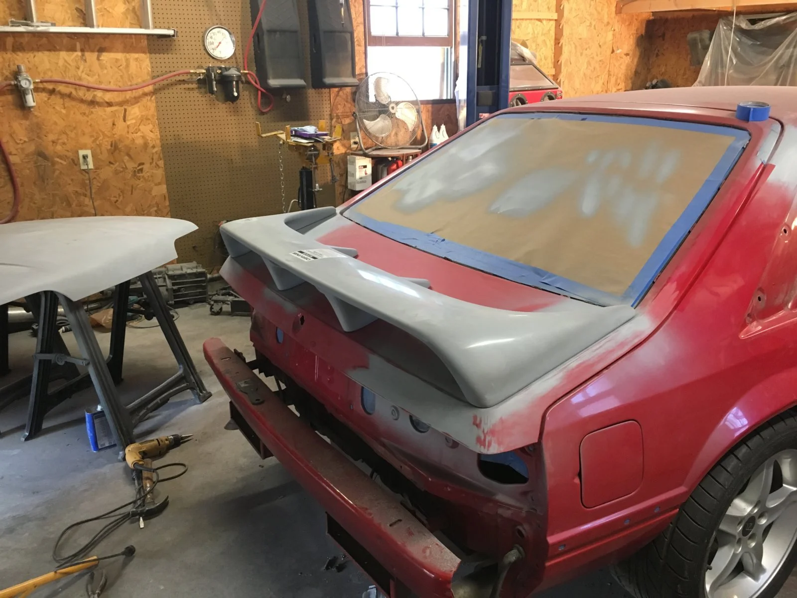

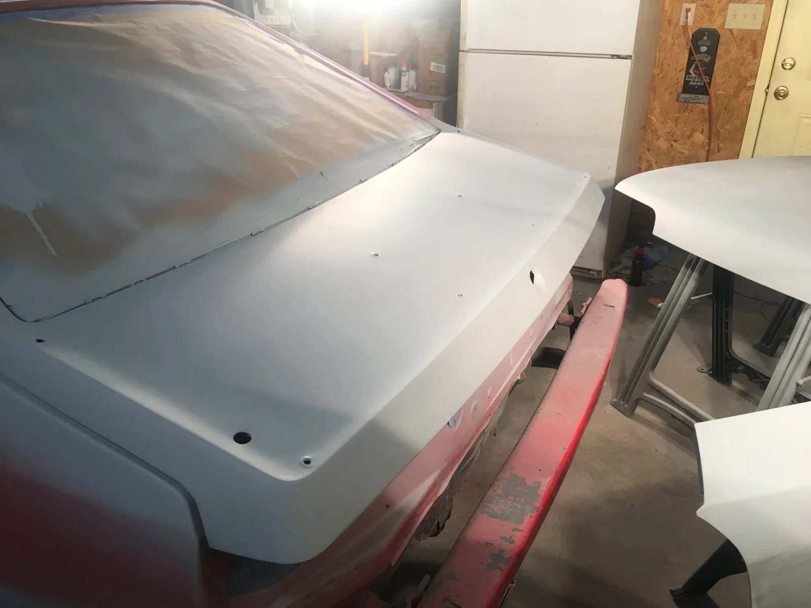

Cobra spoiler is mounted. Glad this is finished. Have way too much time and stress for just mounting a new spoiler!

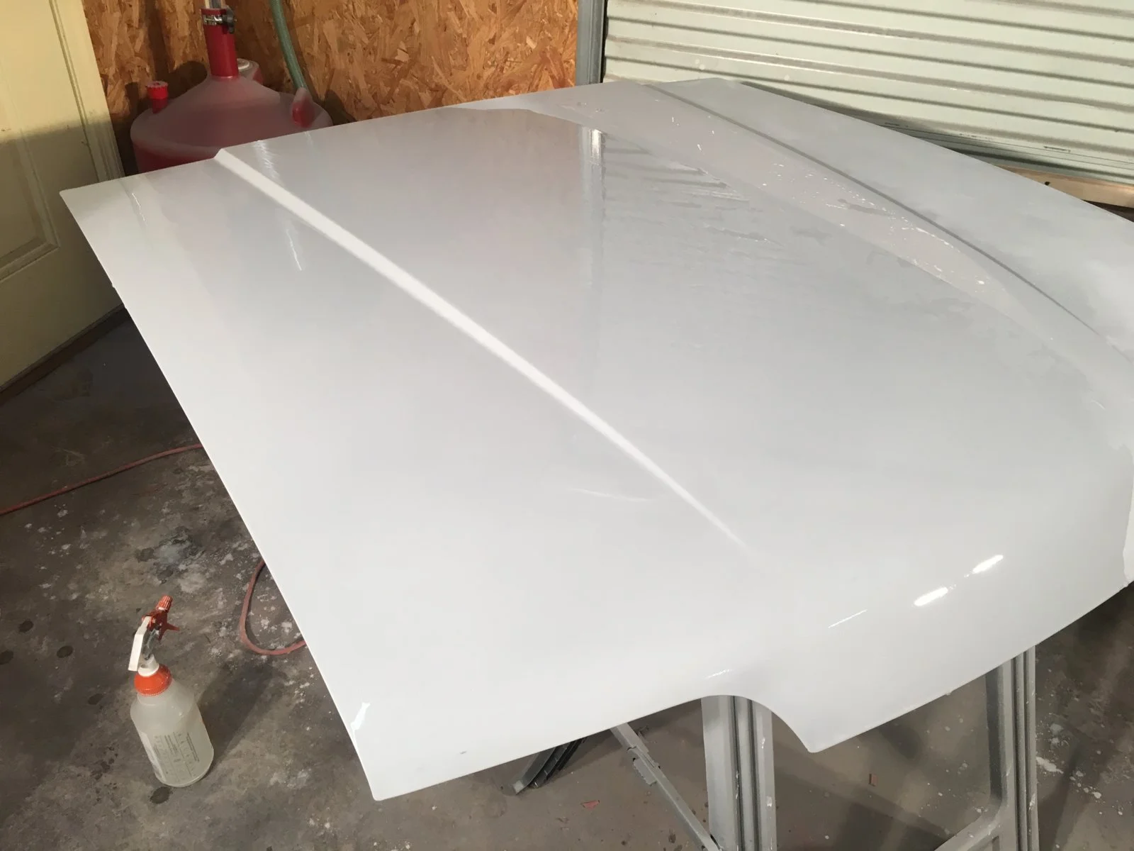

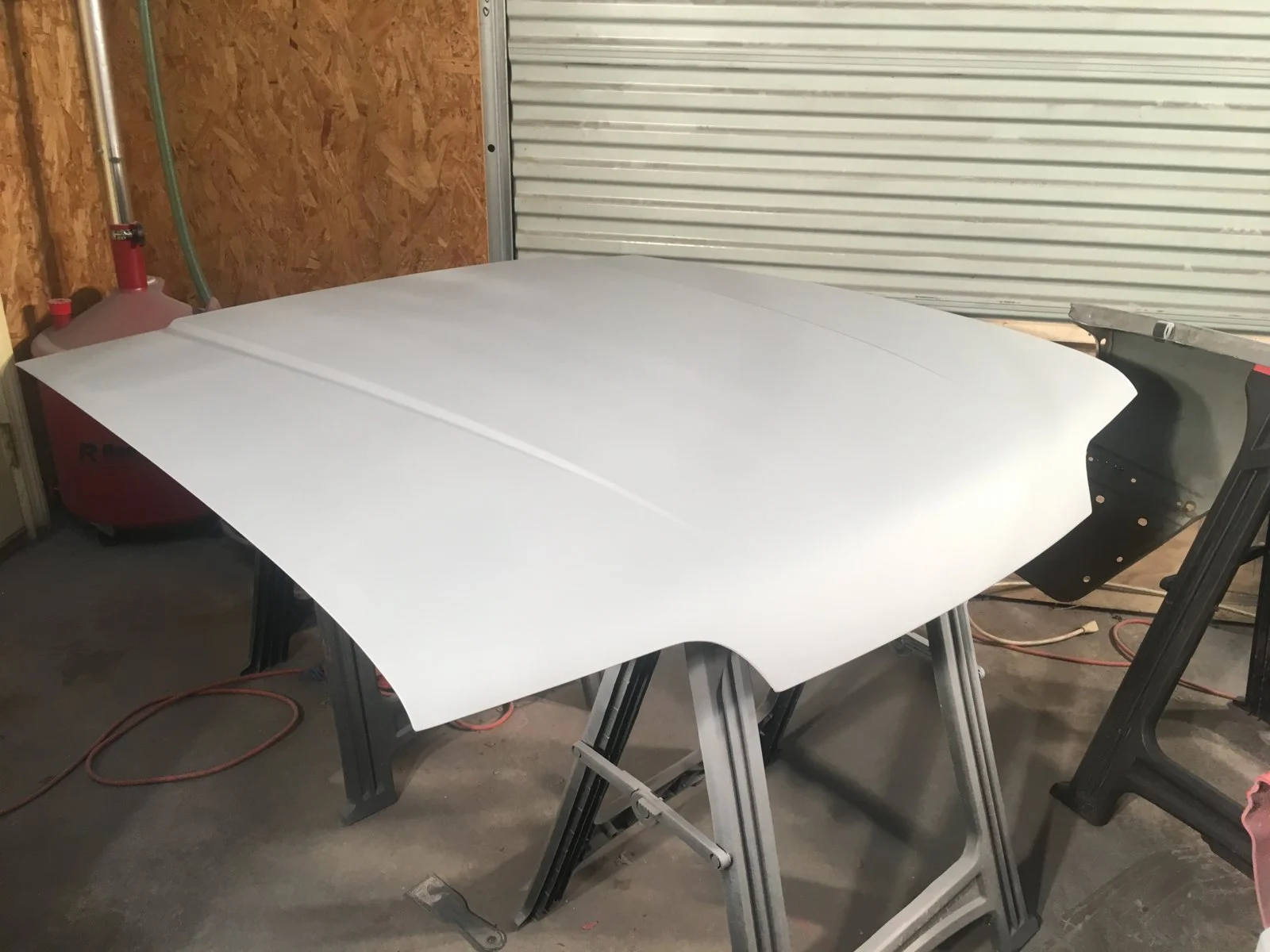

Three coats of high build on the hood. I think we finally put this behind us!
Also covered the metal work and filler on the hatch.

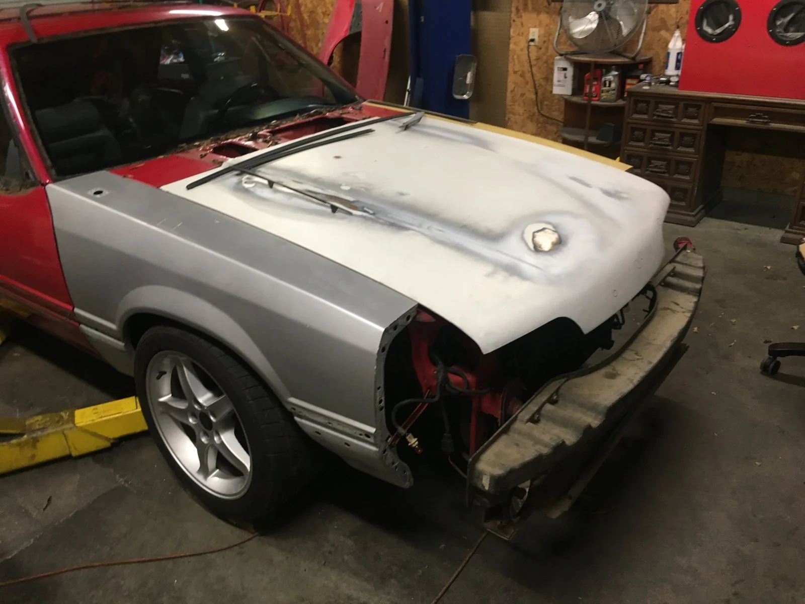

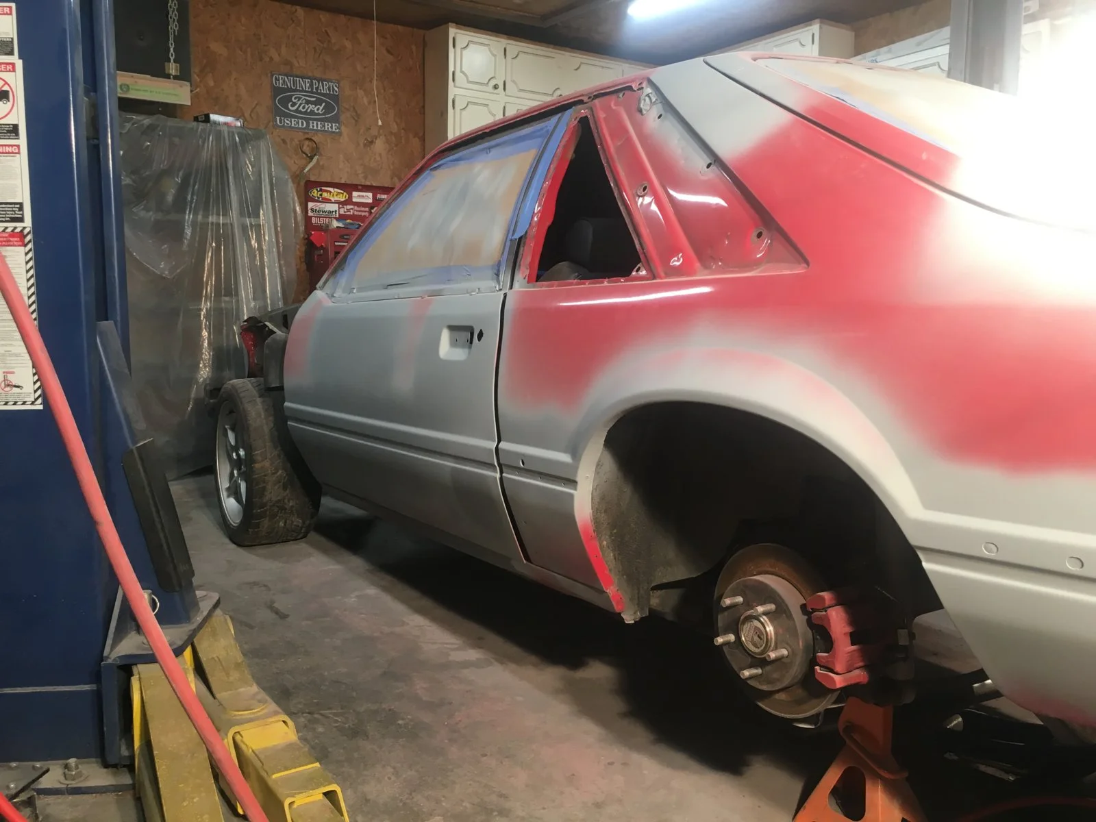

The owner wanted to delete the antenna holes for a smooth right front fender.
Just a side pic showing some of the areas that used to have minor dents/issues.
Most the body repair is behind us. Next up is prepping the engine bay and body for sealer!

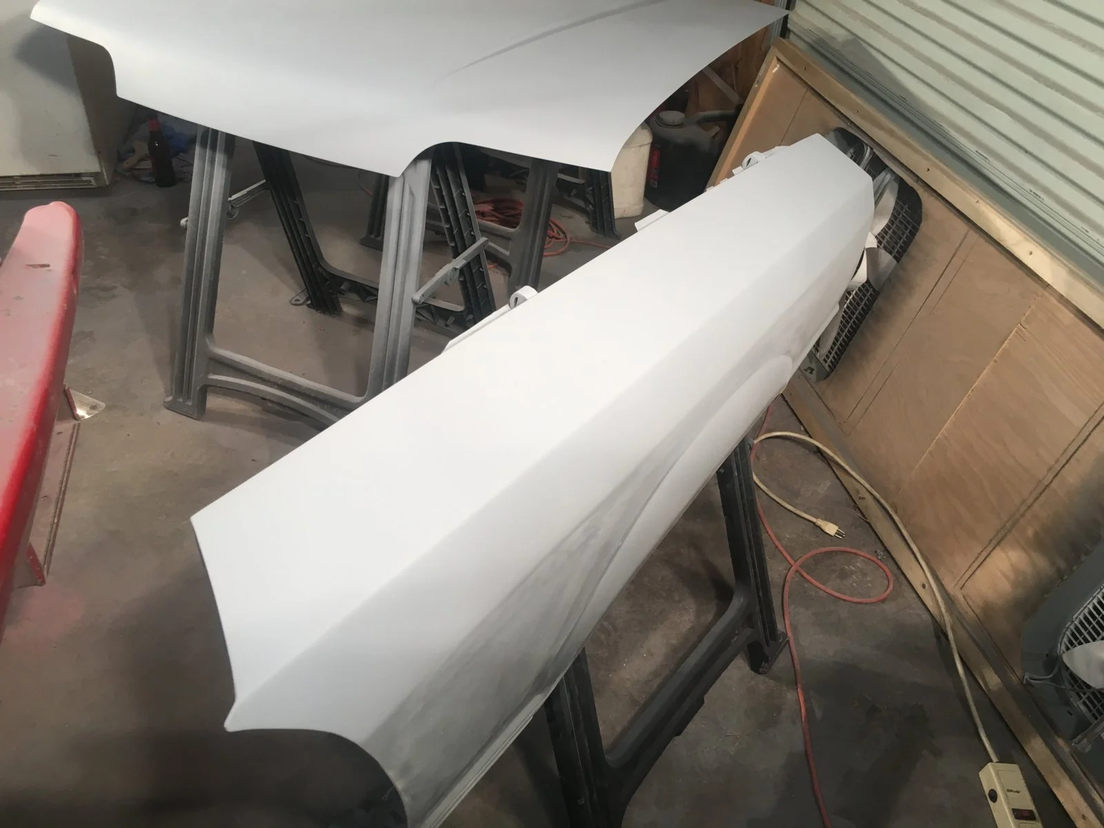

Finished sanding the high build primer, engine bay and the jams. Also made a minor adjustment to the hatch.
He’s a look at the hood while wet sanding the primer. It is coming out very flat. Glad we started over and took it down to metal.

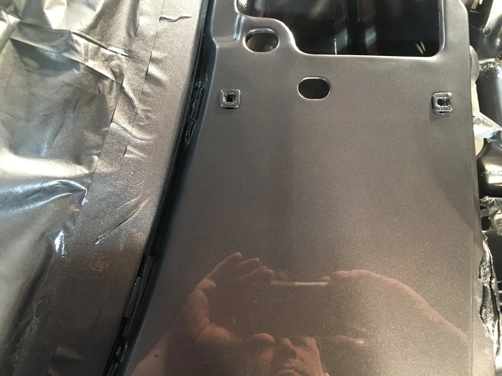

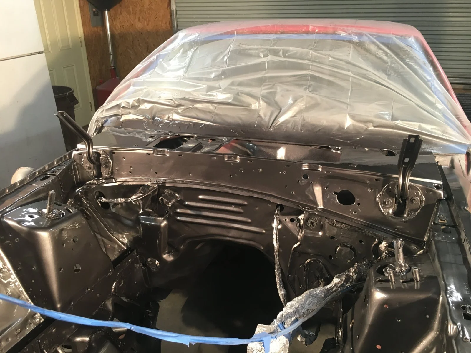

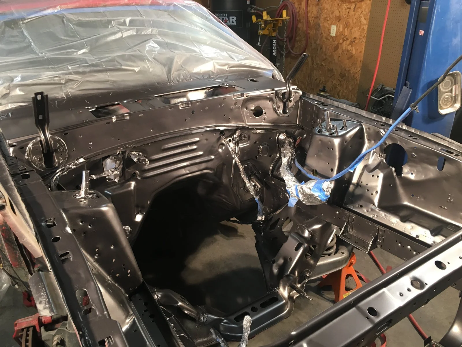

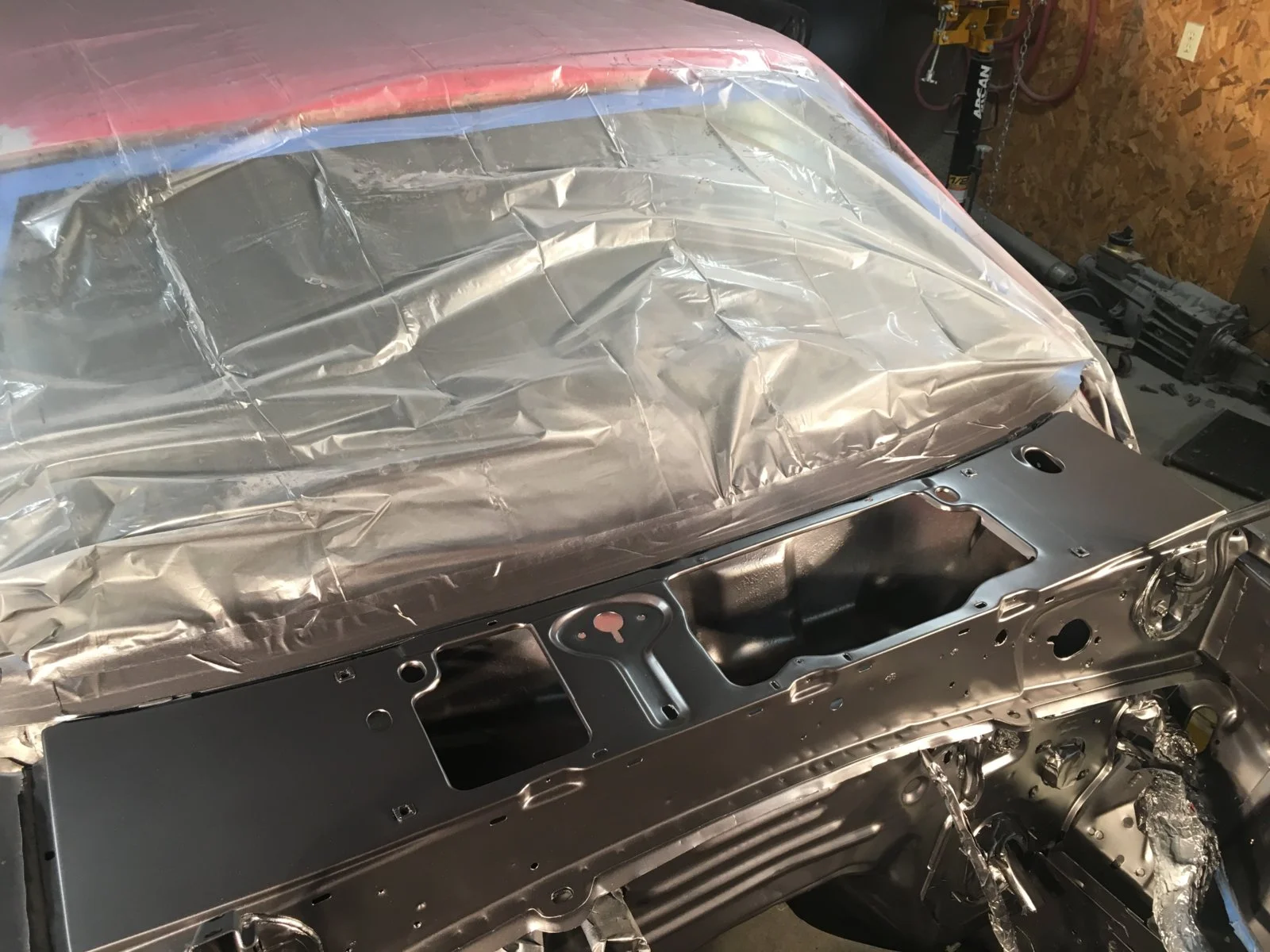

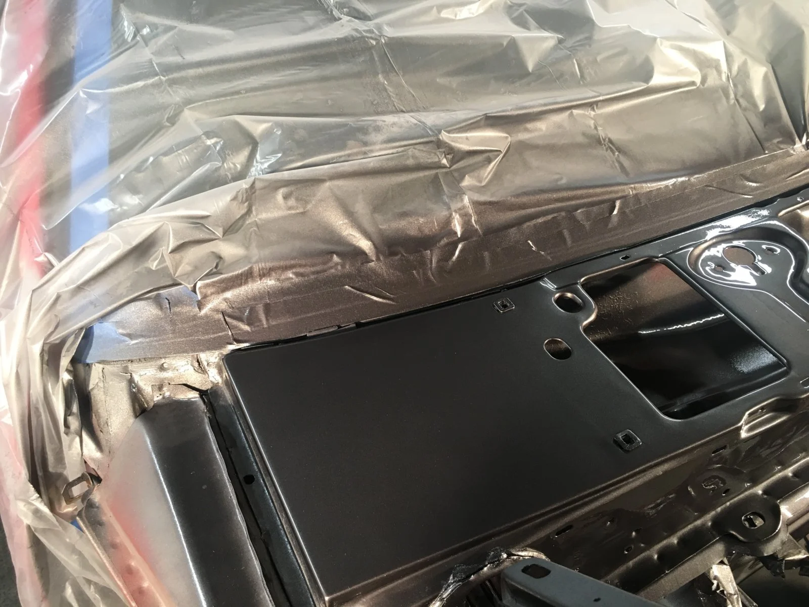

With conditions being good but marginal, we decide to paint the engine bay and cowl only. Decided on this mainly because we could position the car away from the leak spot and the only surface at risk that matters is the cowl. This way, at least we can assemble the drivetrain while we wait on another good day to paint.
Metal temp stayed above 65 degrees. No real problems. Had a run near the back side of the passenger strut tower. But we’re leaving it because it won’t be seen.
After two coats of base.
And three coats of clear.
Color is sterling grey if anyone is interested.
We do have a couple dust inclusions on the drivers side cowl. But zero orange peel. Will those require a wet sand and polish or could we try polishing first?
Reactions: Davedacarpainter
Wet sand those areas with 1200 grit, go back over them with 2000 grit then polish. Just wait until the whole car is painted and do it all at the same time. I usually use a block to sand those out. A Paint stick works well to keep the spots small, just round the edges a little. If the orange peel is too heavy, wet sand the panel with a foam block using 2000 grit, leaving some if it to achieve a factory look. Or, you could sand the clear coat down a little more and polish it to make it look like glass.
That’s what I thought. Was hoping we could do less since there’s no orange peel.
We’ll probably do it today while the paints still soft.
