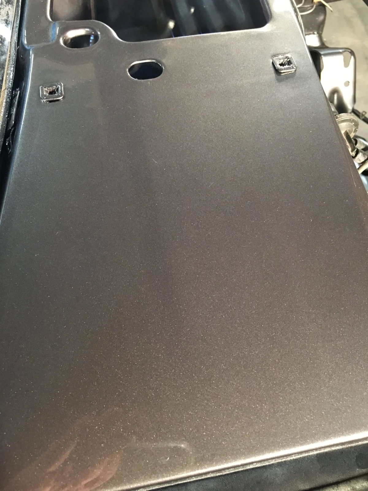

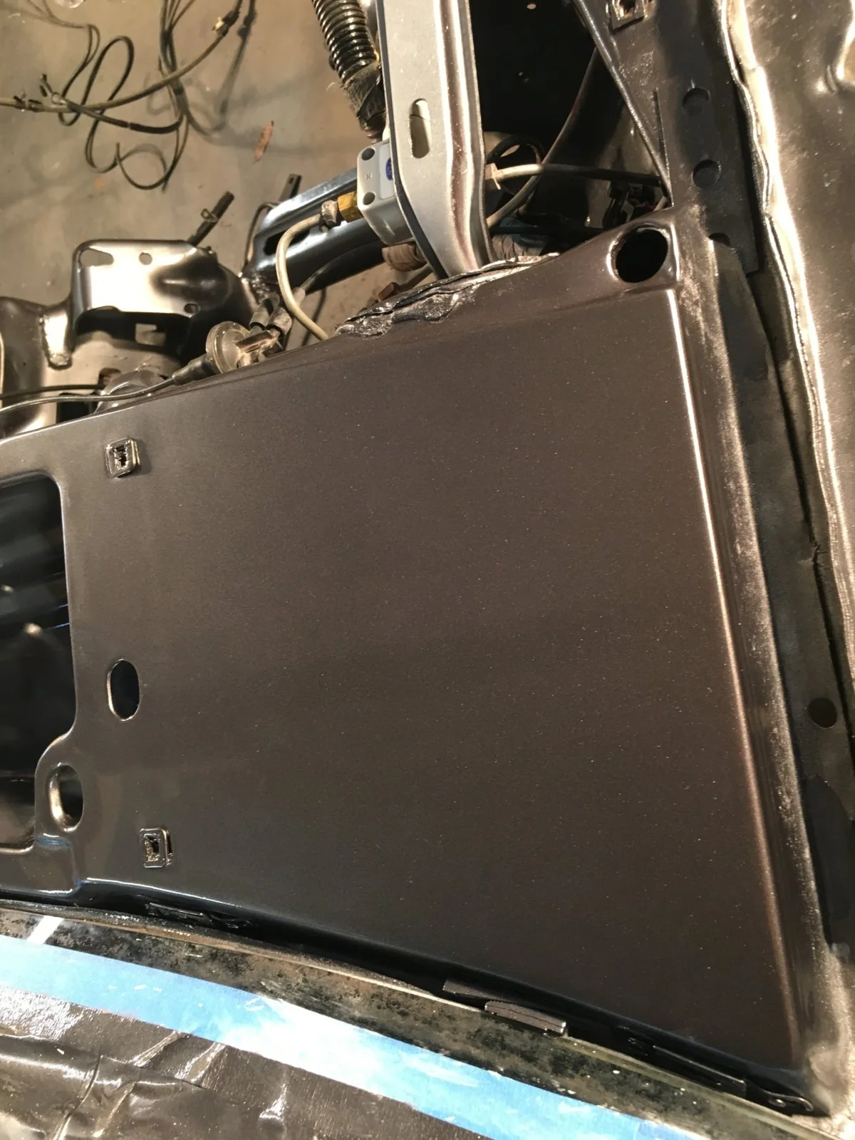

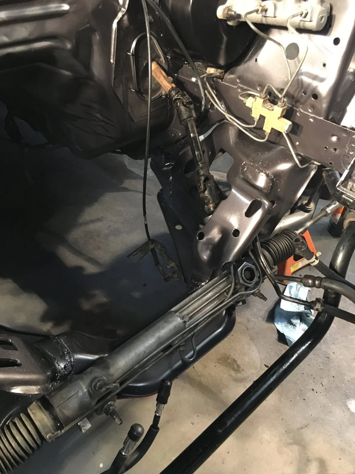

Spent some time on the 93 yesterday. We were able to sand most of the dust particles out. There’s one or two left that are clearly in the sealer coat or the base coat. My friend (car owner) is fine with it. So I guess we’ll leave it as is. It still looks really good. Lesson learned for the rest of the car. Picture below is of the good side.

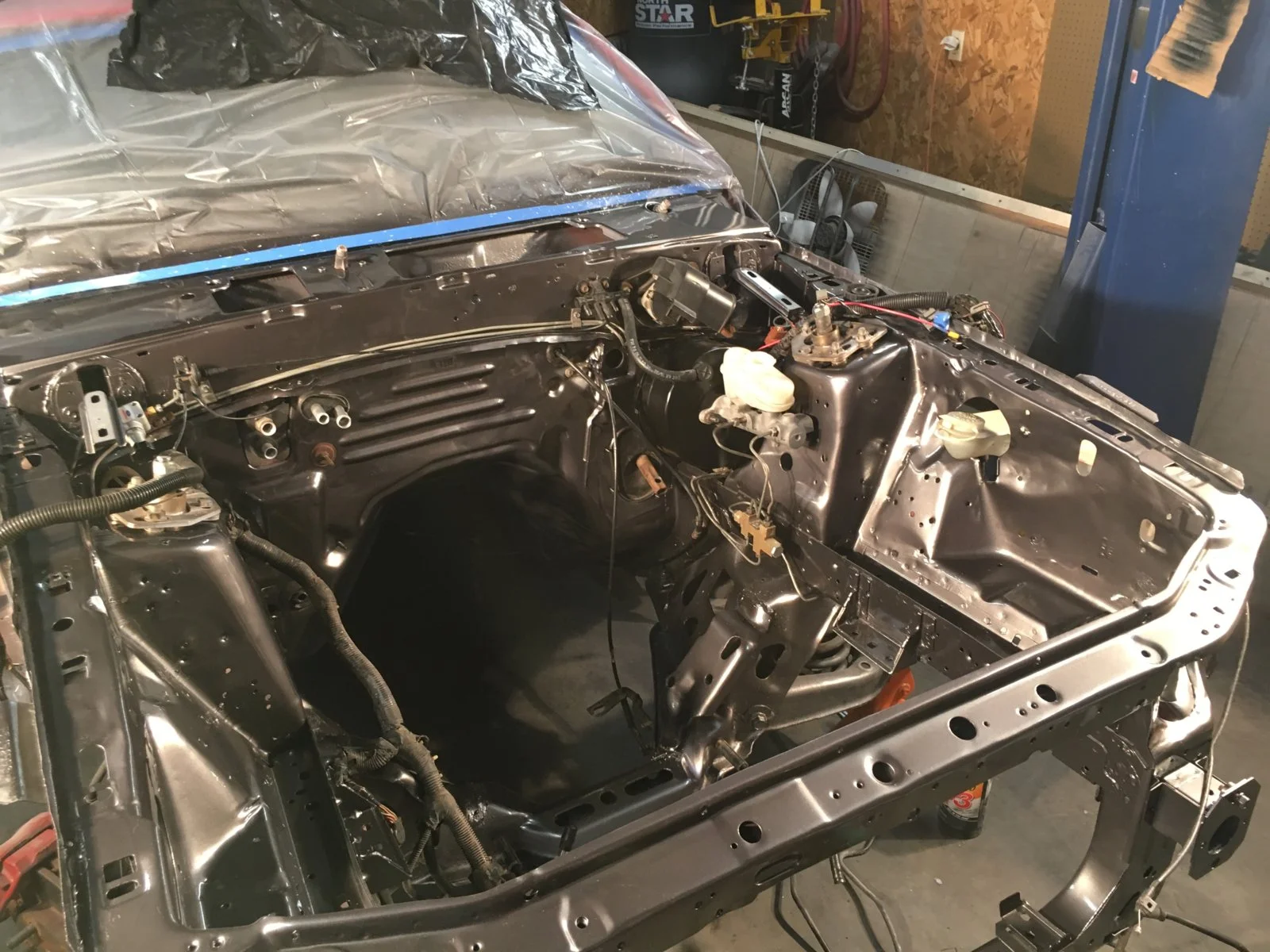

Started installing engine bay components. Haven’t mentioned it until now. But we also did a rear disk upgrade before all the disassembly for paint. Installed a 94-95 v6 booster, cobra master cylinder and the necessary 3 to 2 port conversion.
CC plates are back on. All brake lines are in and we’ve started installing the wiring and the rest of the engine bay accessories.
Going to bleed the brakes, install my old steering rack and MM steering shaft (more on that below) and then we’ll be installing the engine! Should be a good day.

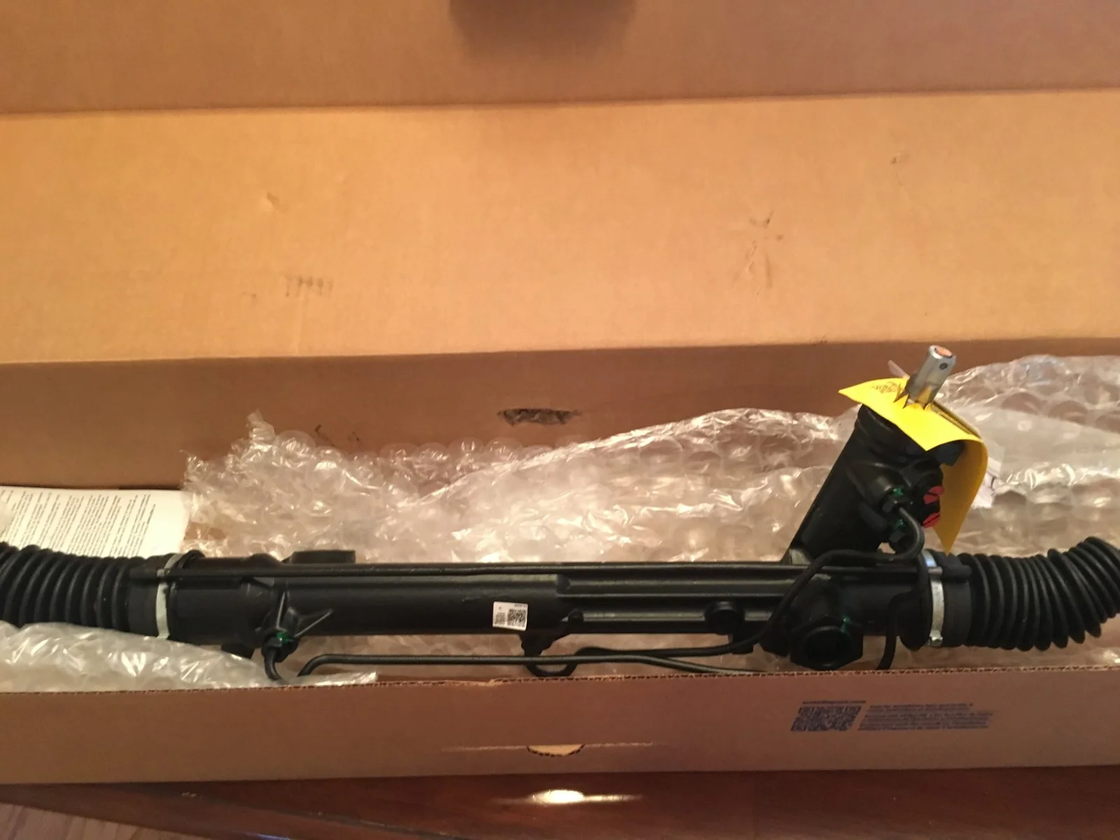

After the cobra swap, my AGR steering rack became so over assisted the car was kinda scary to drive at its power level. I’m assuming the 4.6 power steering pump operates at higher pressures because of the hydro boost. At any rate, I’ve had the the SN95/Crobra rack upgrade on my list for a while. Picked up a remanded 03-04 cobra steering rack.
It’s a Cardone 22-2000. The housing is stamped SJ. Hopefully is has the correct internals (t-bar, limiters, ratio). Worst case SJ checks out as a V8 rack. From what I’ve read it’s still a major improvement for both assist and on center feel.
Reactions: Davedacarpainter

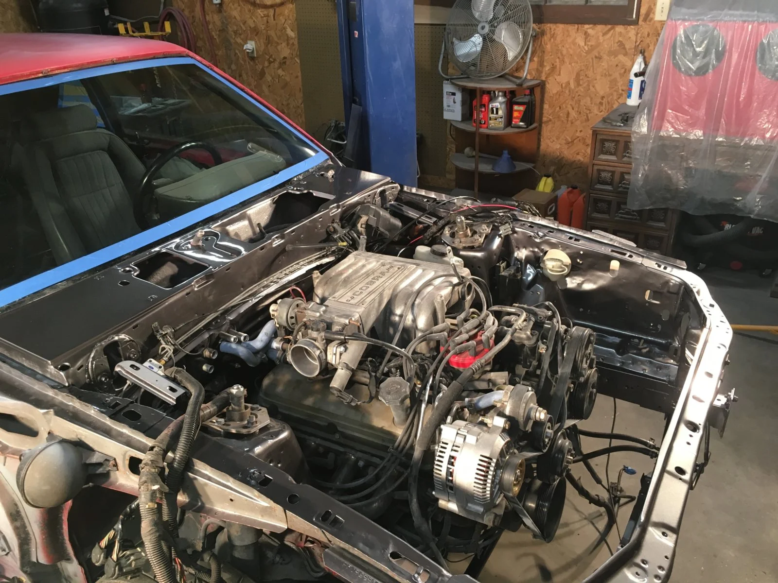

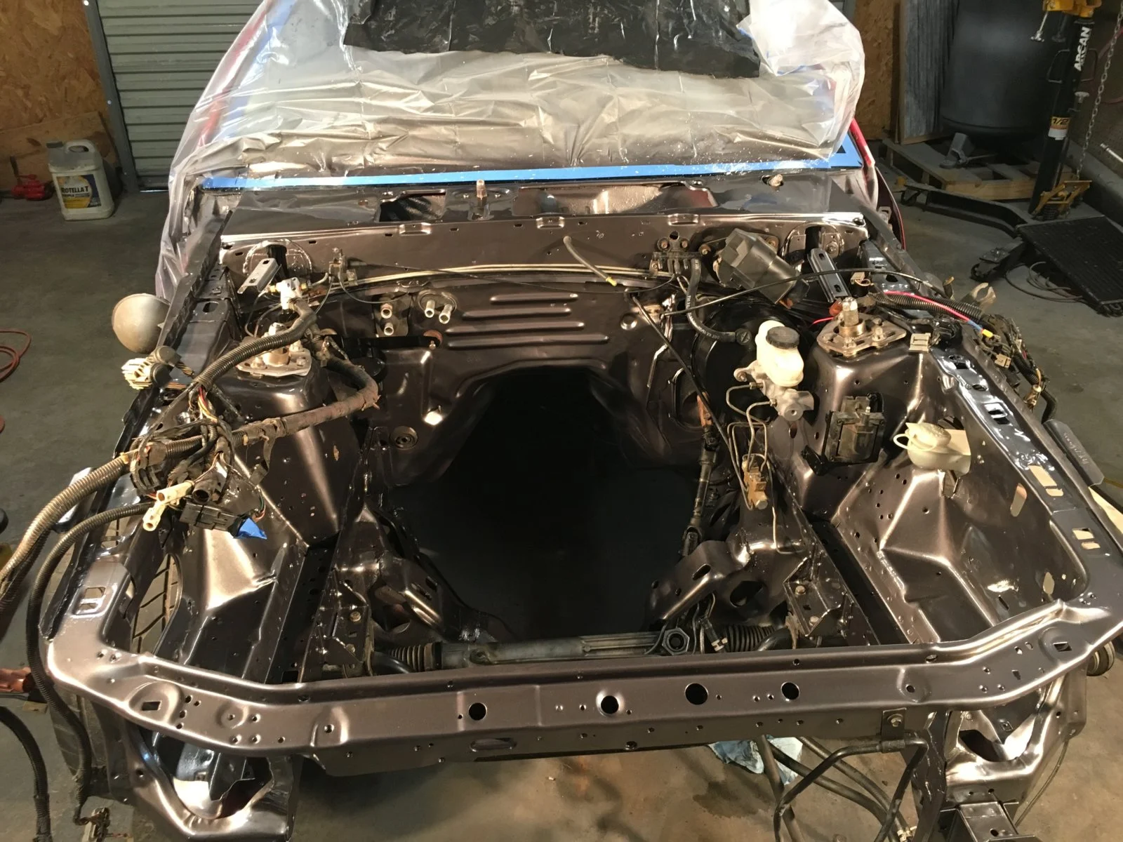

Another long but productive day.
AGR steering rack and MM shaft were installed.
Engine bay ready to accept the motor.
We took our time installing the engine. Didnt want to scratch the freshly painted engine bay and...
We got it done without a scratch! A little stressful at times. Just went slow and took our time.
Next up: clean up the wiring and we’ll probably paint the valve covers and intake.
