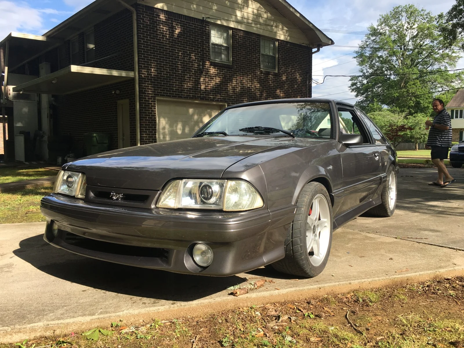

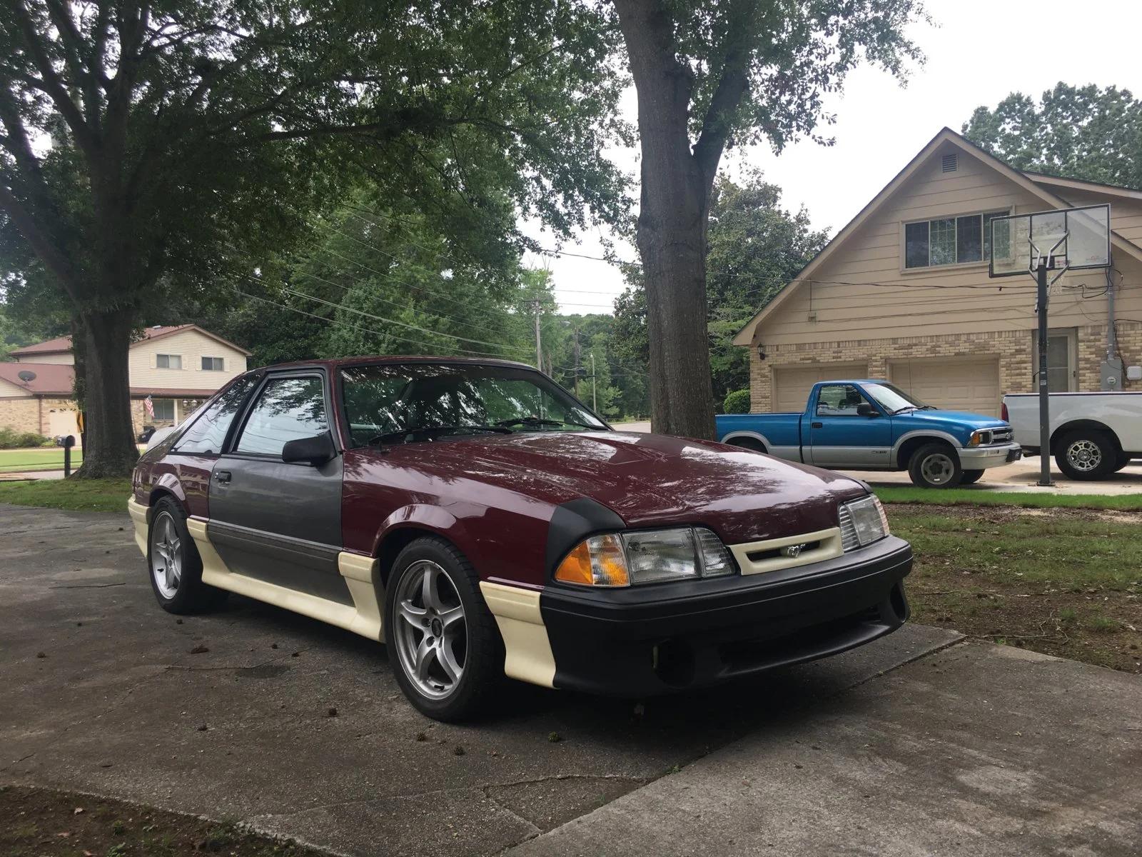

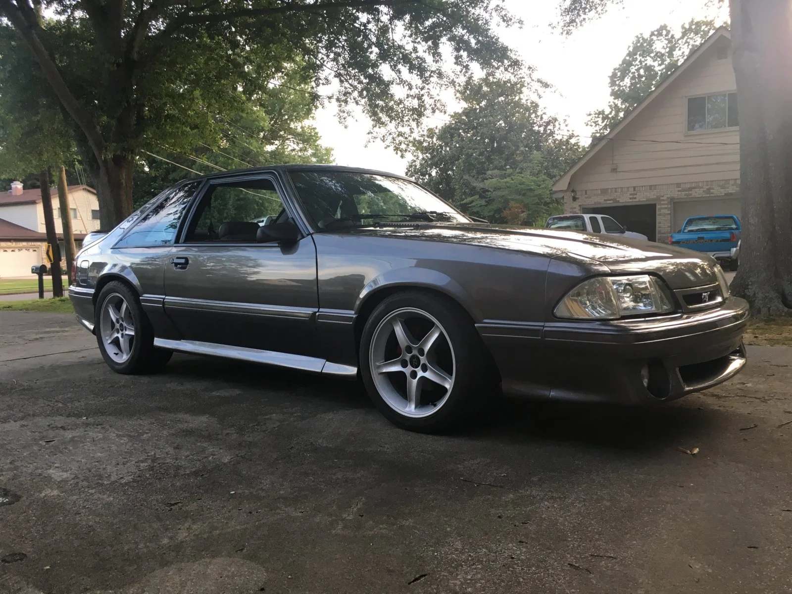

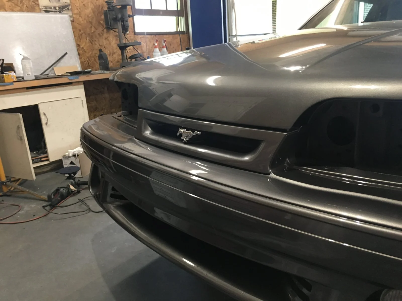

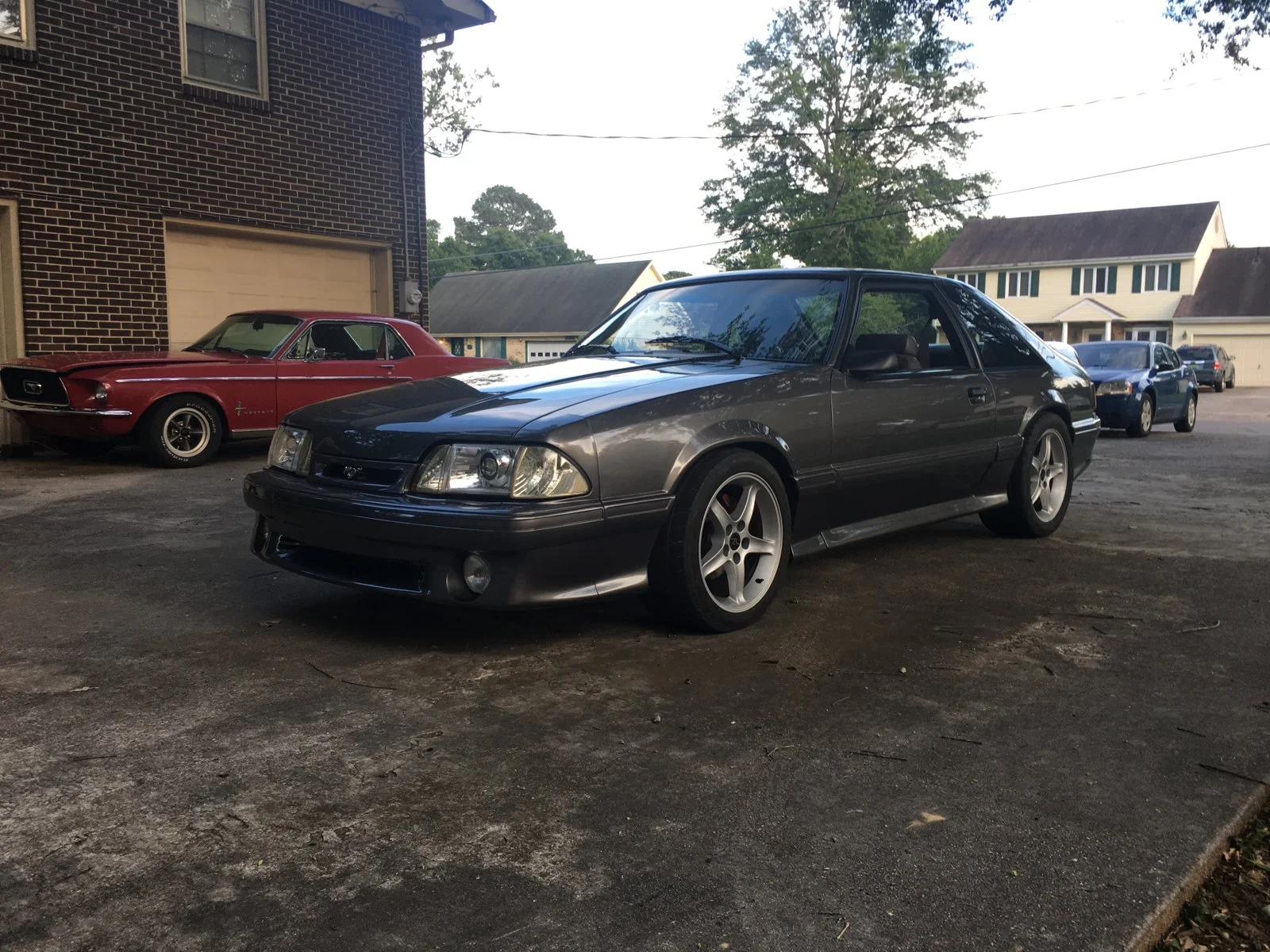

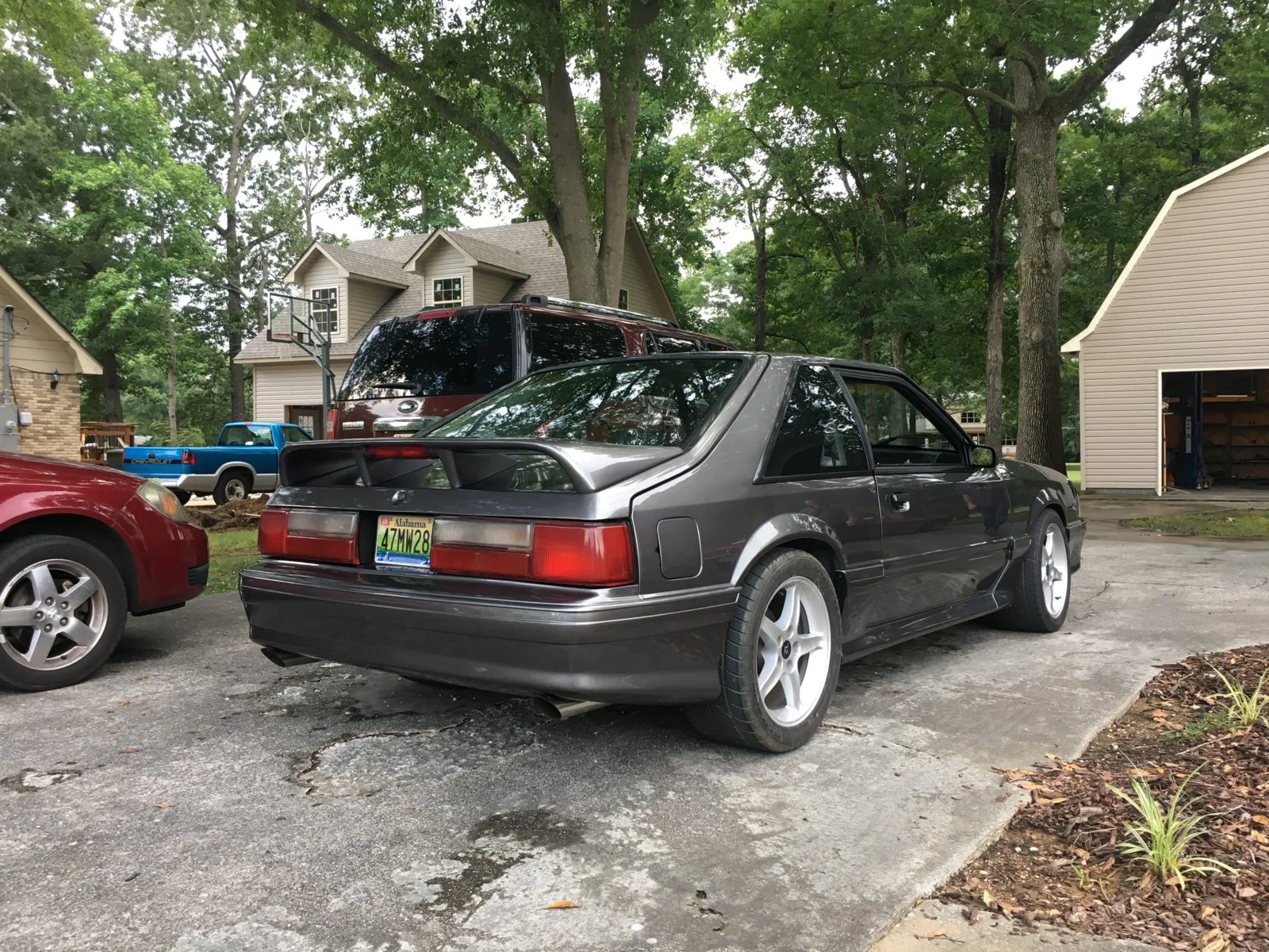

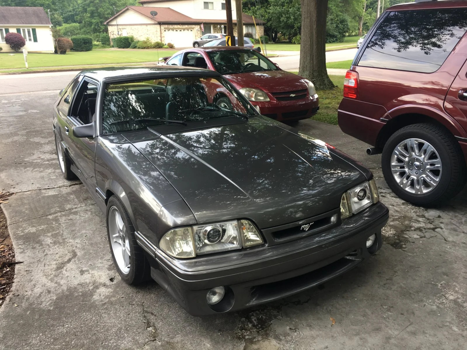

Another productive Saturday ,everything is done but the door moldings. Installed the front bumper, cobra grill insert and the headlights.
Then pulled it out into the sun. Needless to say, I’m pleased. It looks outstanding.
Then gave it a quick bath and drove it for the first time in 7 months.
The new (budget) rear disks made a huge difference. The car has much more braking power. More importantly, even pressure to all wheels.
Only have a few items left. Some minor toe adjustments, fill the a/c, and install the door moldings.
Adjusted the alignment and filled the a/c during the week.
Tonight we put the door moldings on. That was actually pretty painless. I was stressed about having problems or screwing it up. But we thought our way through it and came up with a fail proof method.
And with that, the car is officially done. Complete!
Time to relax with my favorite beer!!!

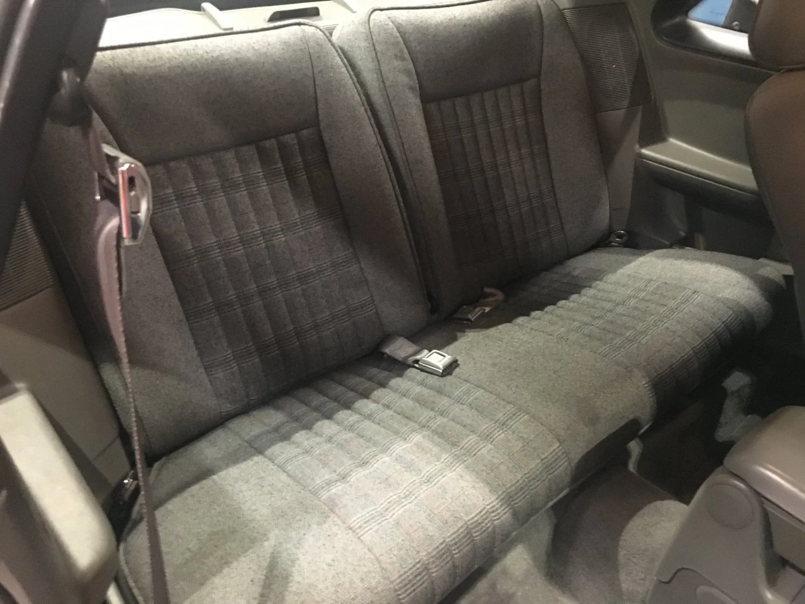

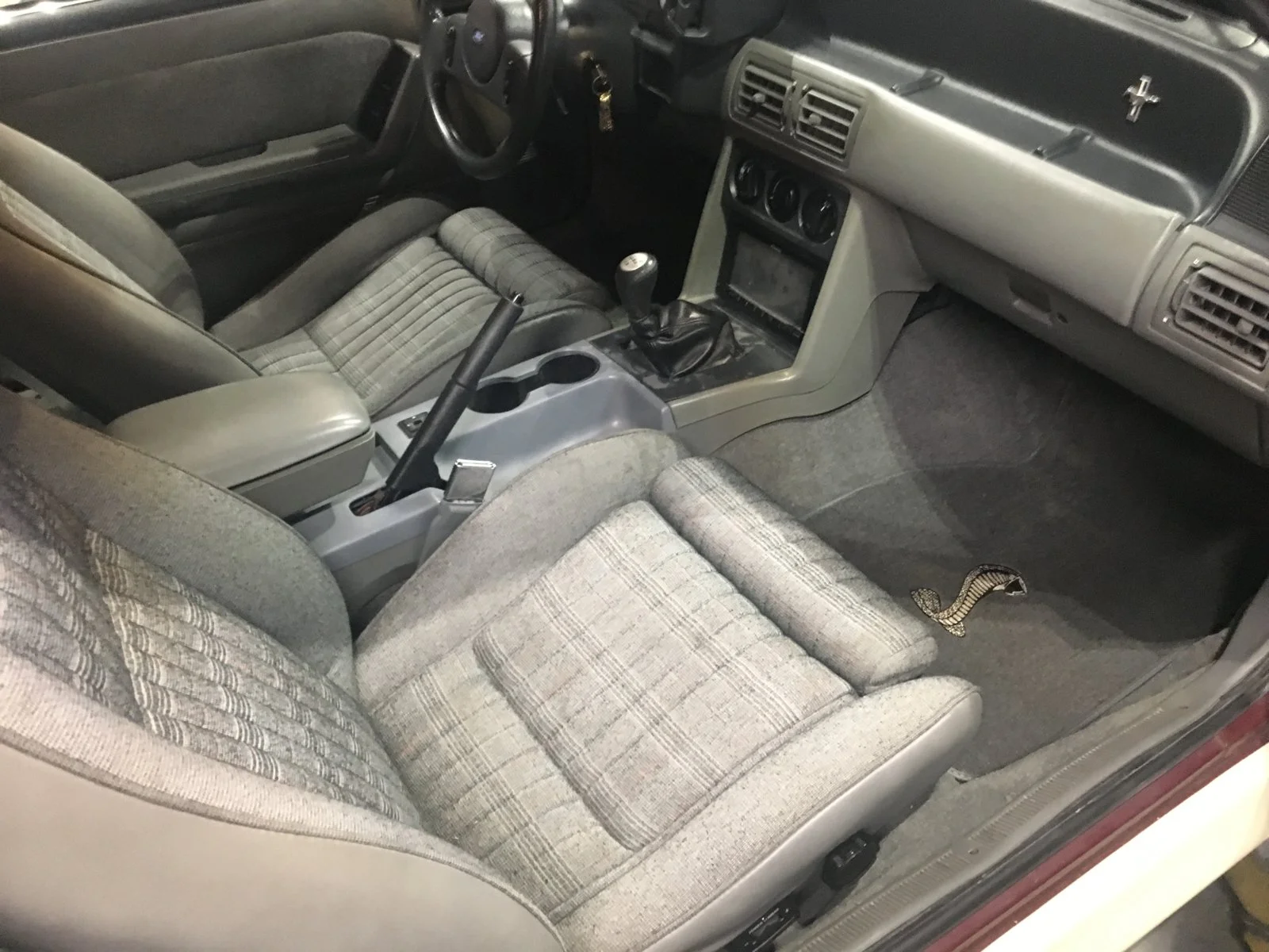

Interior is fully assembled, extended 3rd brake light harness and installed the light, and mocked up the cobra kit.

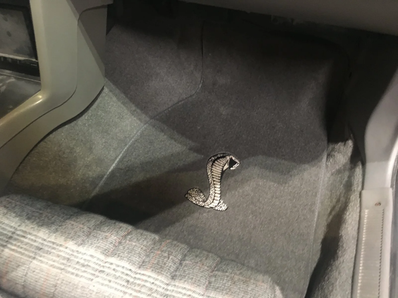

Since the carpet is new, I decided to buy some new floor mats. 03 cobra motor + 93 cobra kit = cobra floor mats. I really like these.

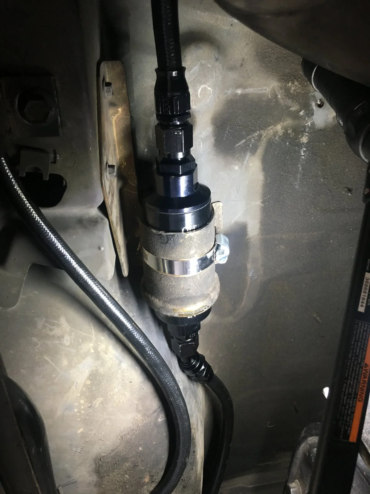

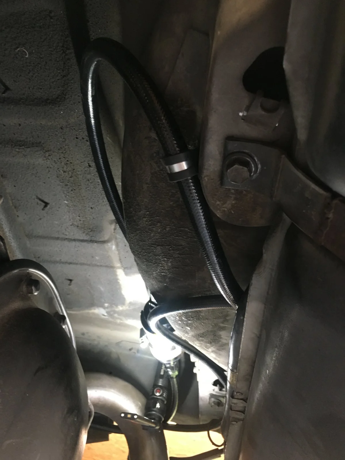

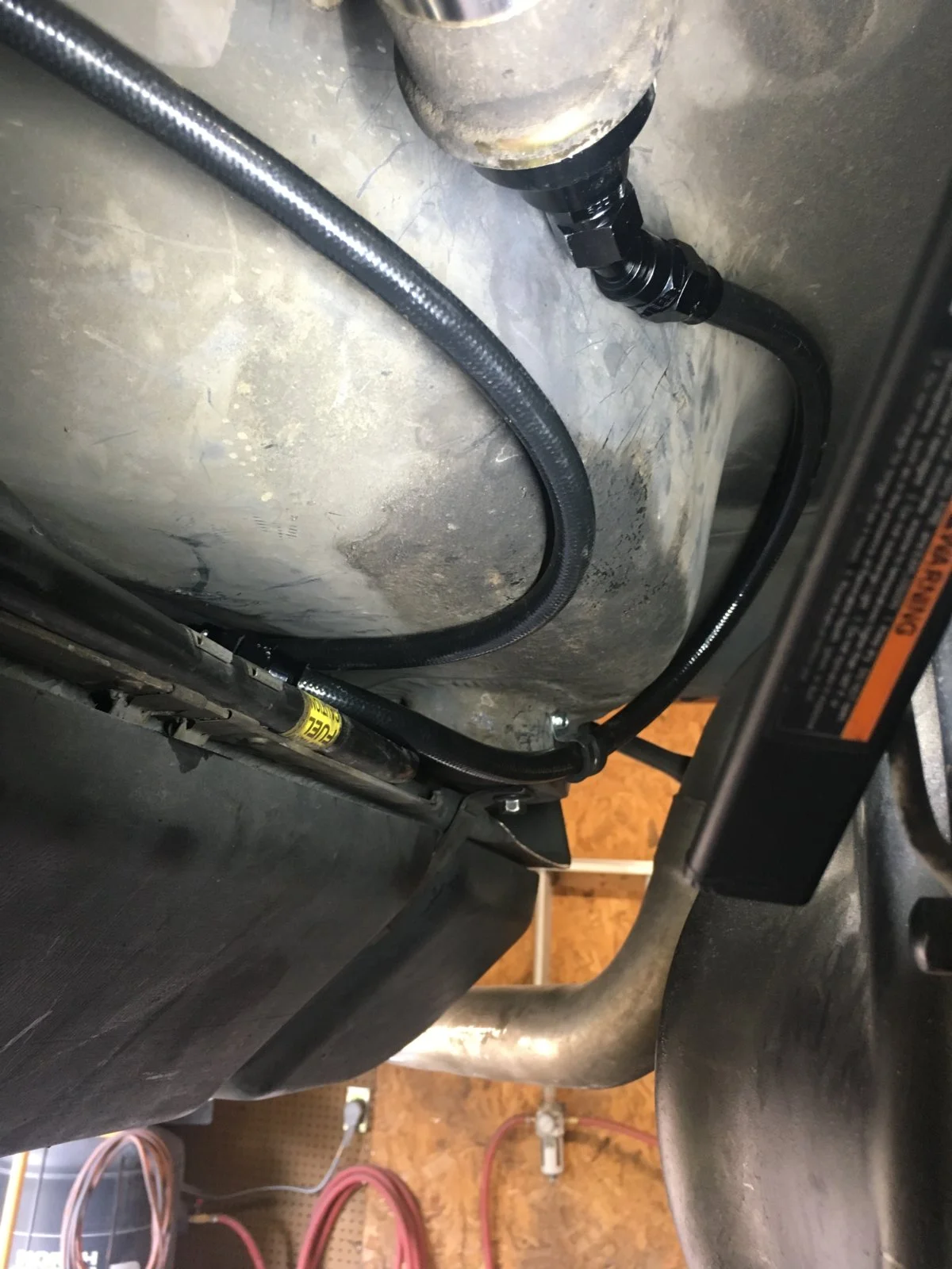

Last year before cruisin the coast, I decided to tackle a fuel heating issue that was giving me problems. Rough hot starts, really loud fuel pumps, and some power loss in hot weather.
The system was two 255 LPH pumps plumbed through the factory lines and fuel rails. The regulator was mounted at the end of the fuel rails, where the unused fuel was then returned to the tank.
That created a major problem. With two pumps that size, at light load conditions, all 15 gals of a hypothetically full tank would be cycled through the 190 degree fuels rails every 7 min!!! No wonder the pumps would get so loud I thought they were failing.
I had to put the regulator before the rails, that way the unused fuel would be returned before passing though fuel rails.
I did all that prior to cruisin the coast but managed to forget one item, the fuel filter. Had to add a high flow AN style one.

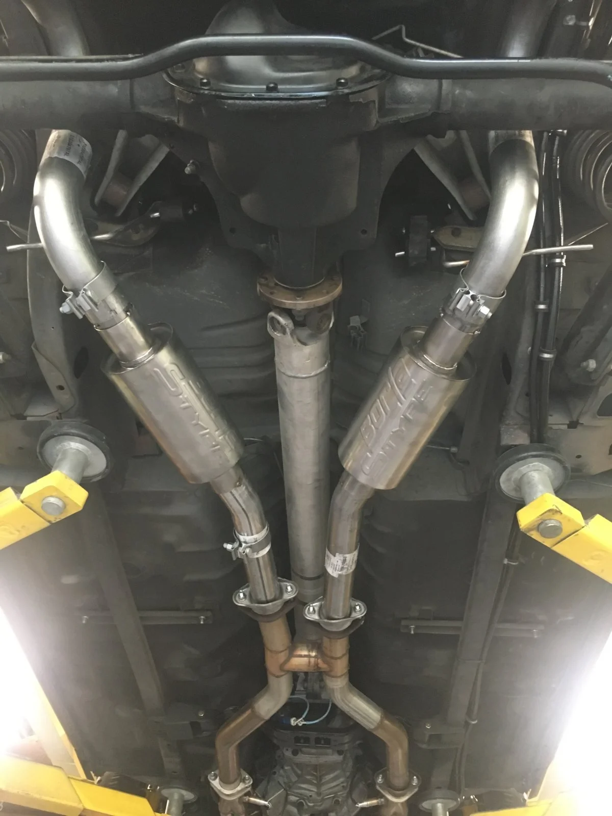

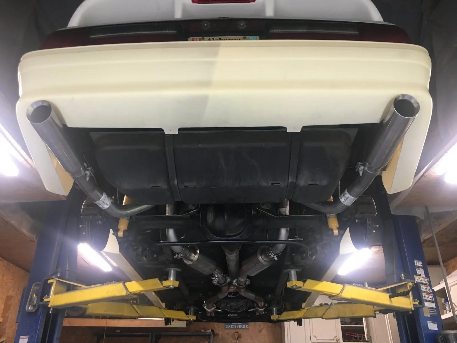

Then it was time to upgrade the exhaust. I’ve had flowmasters on this car for 15 years. Love tge sound on a 5.0, but they really dont work well with mod motors. After searching YouTube, I settled on Borla Stingers. Got it all mocked up. Need to remove and finish weld. That’ll have to wait until tomorrow.

Exhaust is fully welded. I then dropped the h pipe to add some wideband bungs.

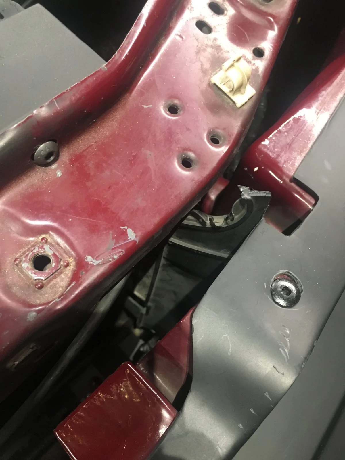

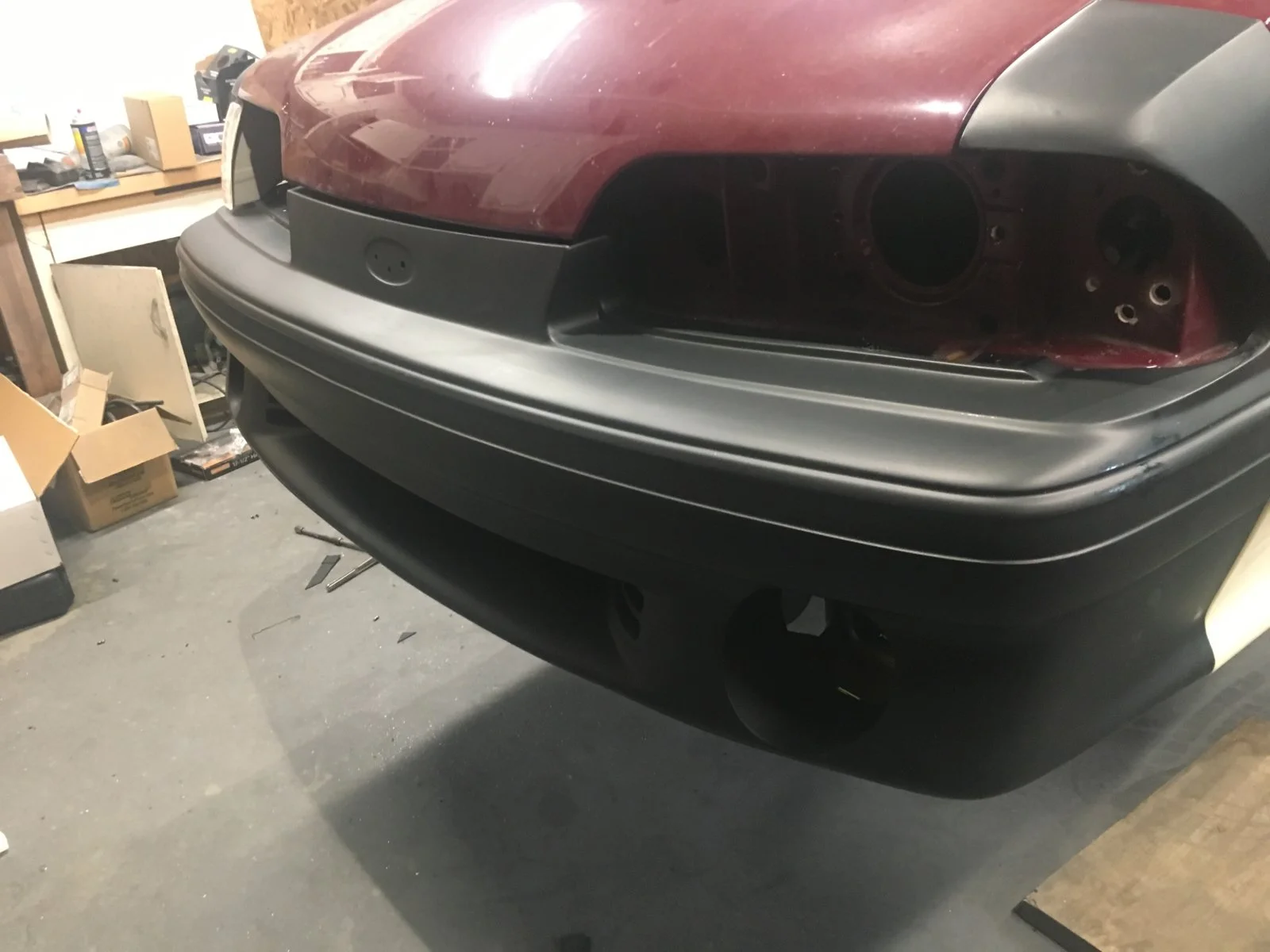

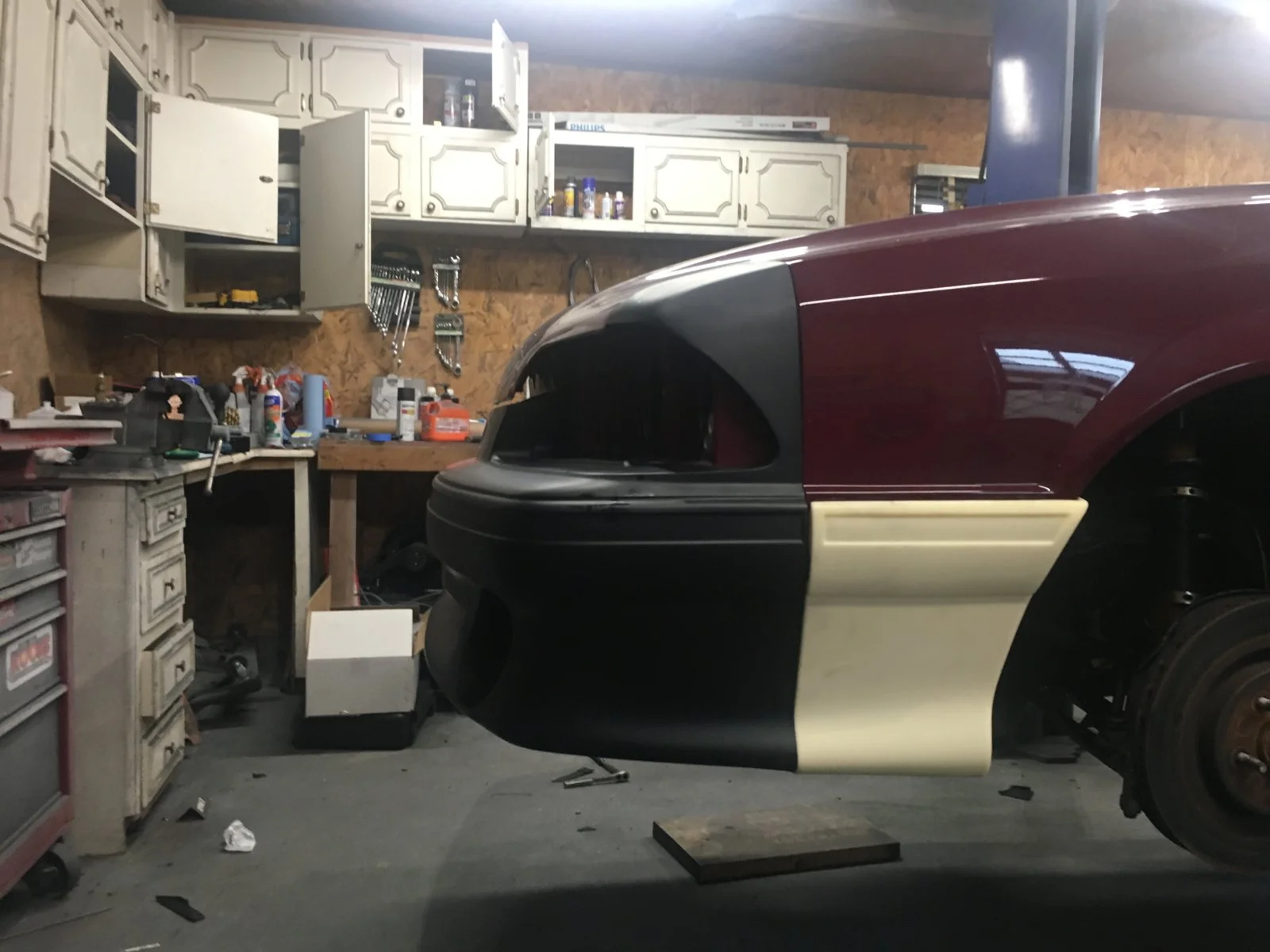

Have an issue and question concerning the front bumper for the body and paint guys. I drilled out the rivets holding the header panel to the LX bumper, then rivetted it to the LMR GT bumper. Overall fitment is okay. But the outer parking lights are way off. If I slot them into the pins in the header panel, they contact the bumper in multiple places. I can’t even force then to slide in all the way.
I rivetted the panel to the bumper on the shop floor. Should I have loosely bolted the header panel and bumper to the front end before riveting?

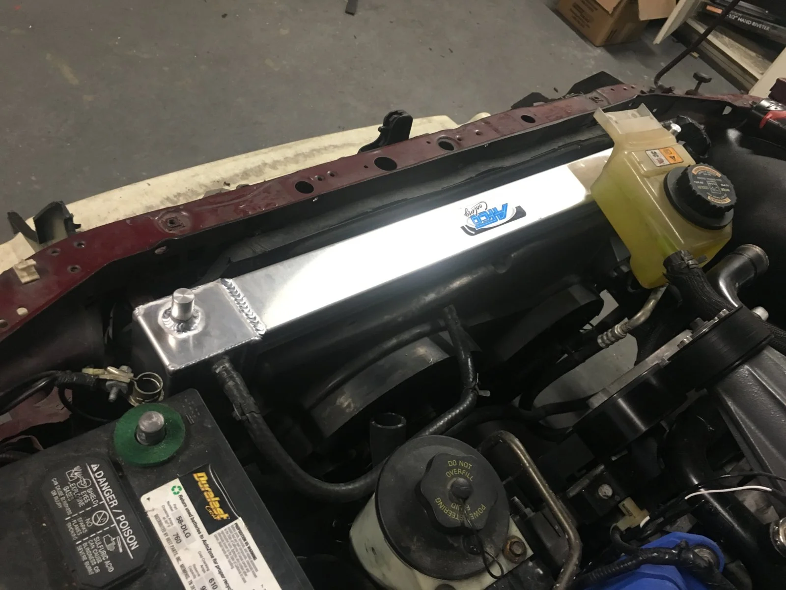

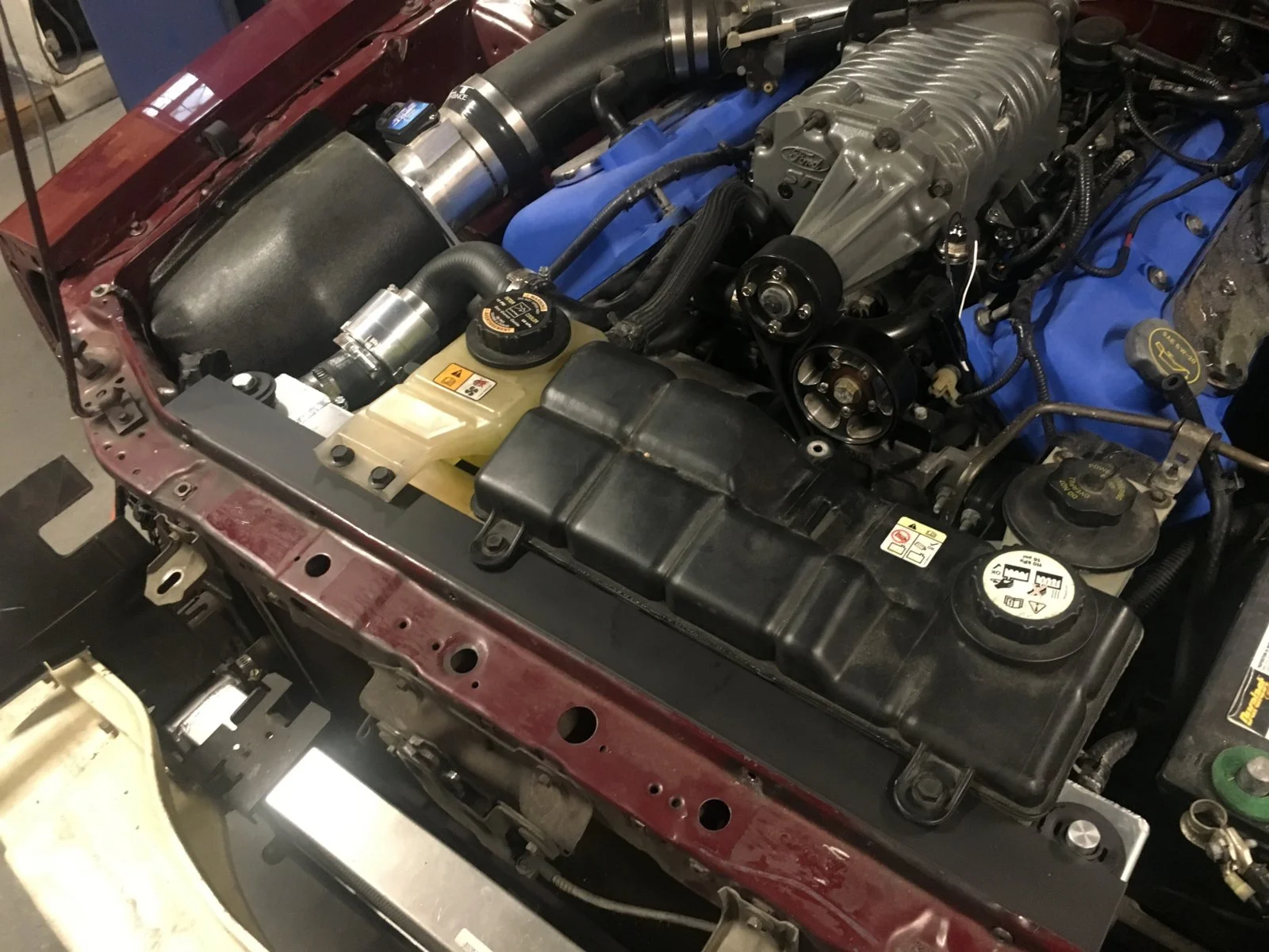

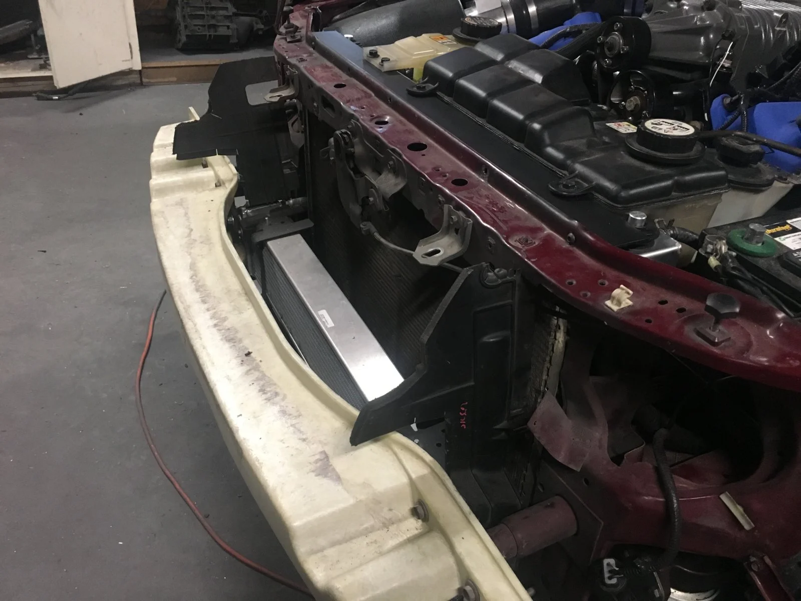

A little background before the updates. This setup has always suffered from considerable powerloss in hot weather. Some of it is probably from the pulleyed heaton. But I think most of it was the marginal factory cooling system. After it ran so hot on me during traffic at cruisin the coast, I decided to tackle this while the car is down for paint.

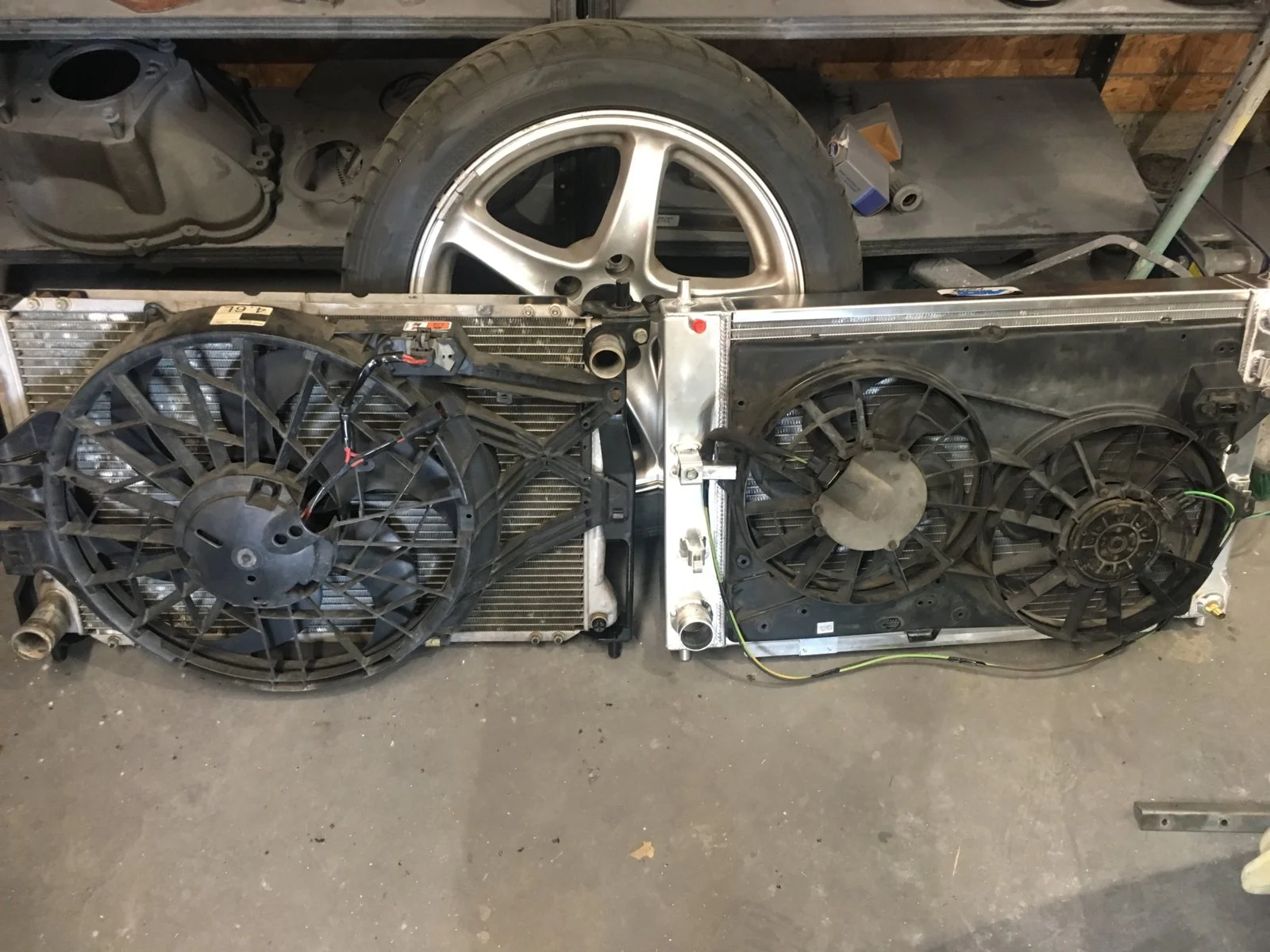

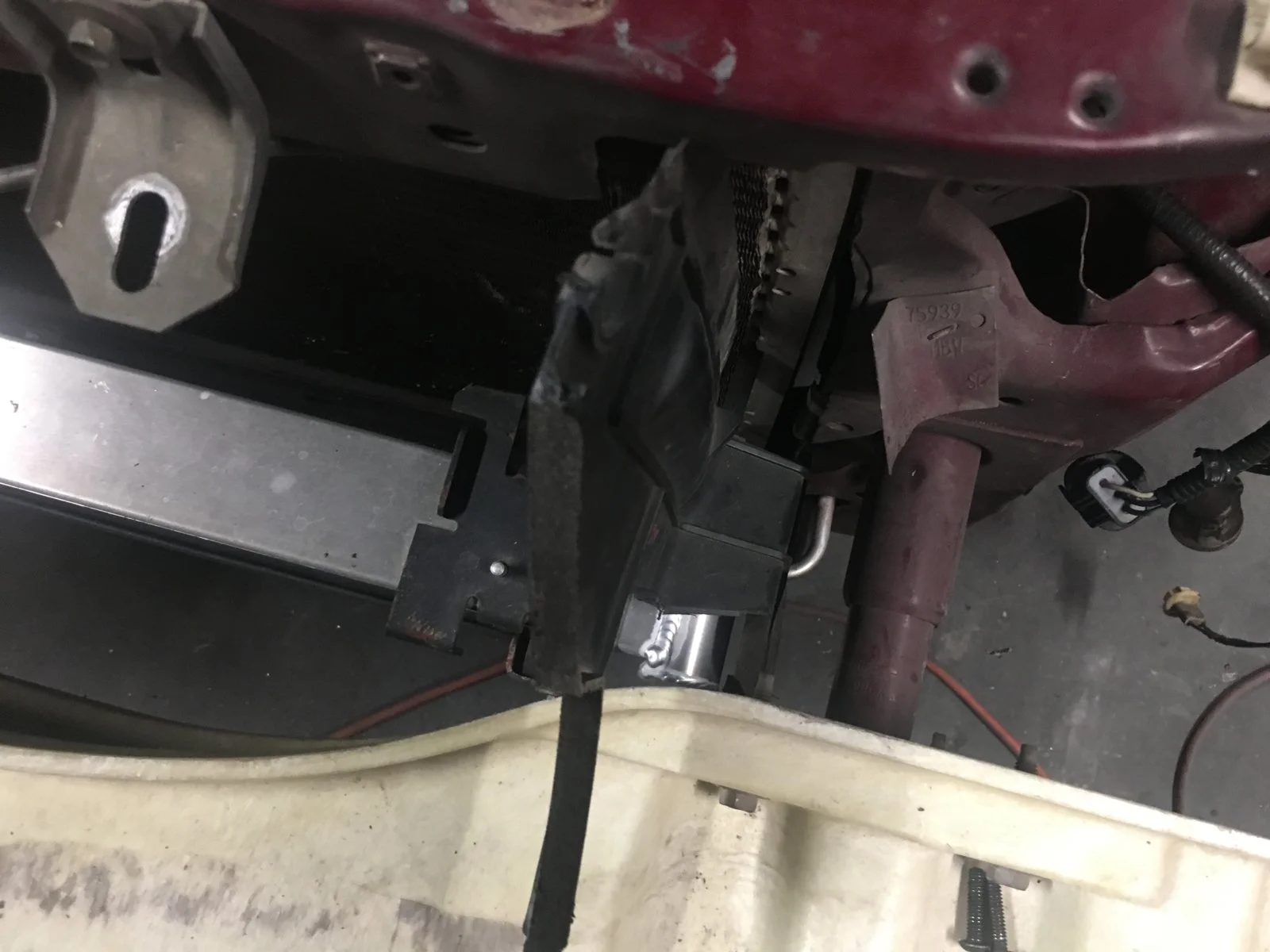

First thought was to get a real radiator. The factory radiator was laughably thin. I was planning on using the factoy fan, but then stumbled across a contour fan at the junkyard. Here a side by side with the contour fans mounted.
The new radiator is 2 core with 1” thick cores.

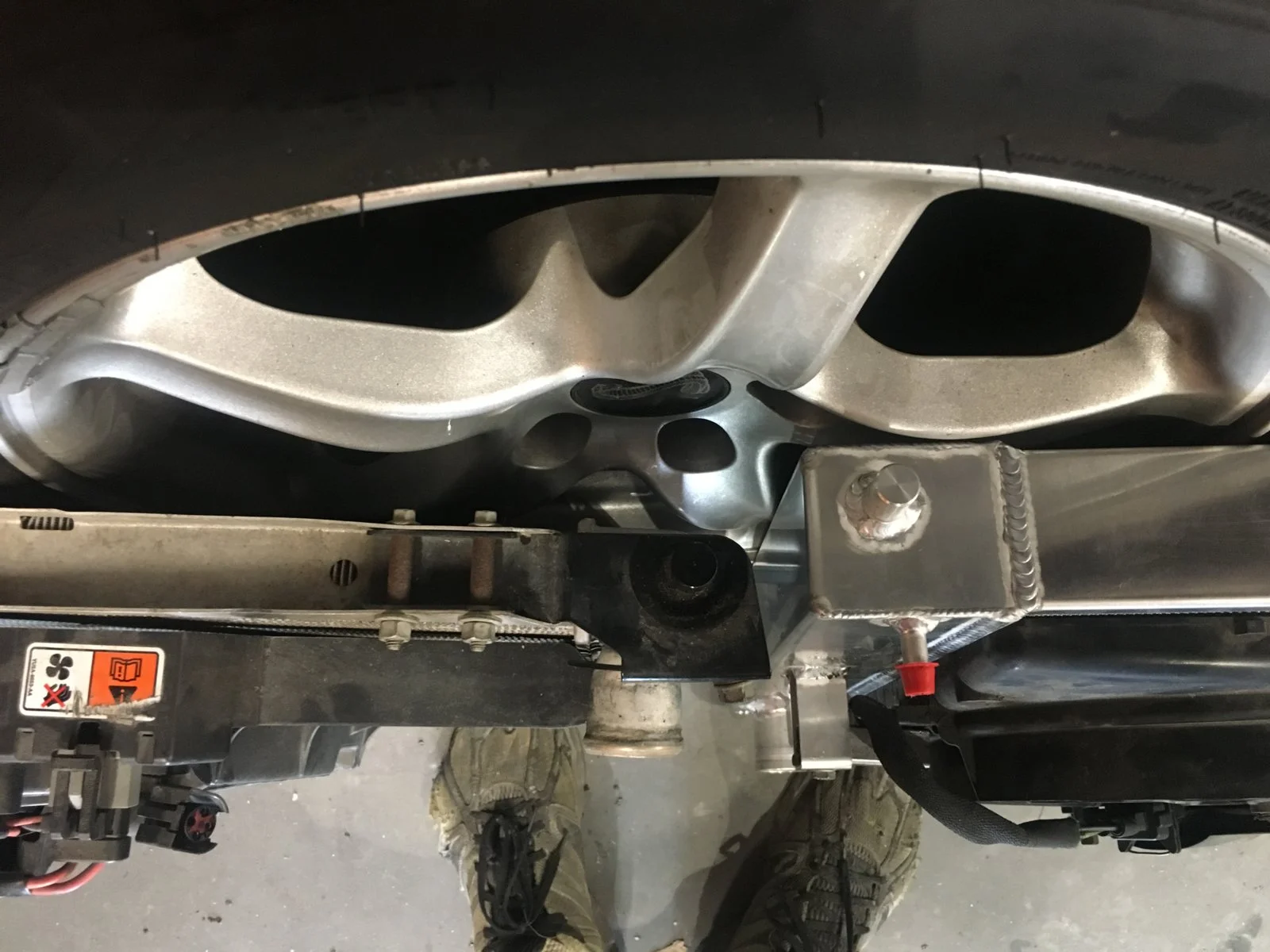

Of course the thicker radiator didn’t just drop right in. Nothing on this car does. Had to fabup a new upper mount.

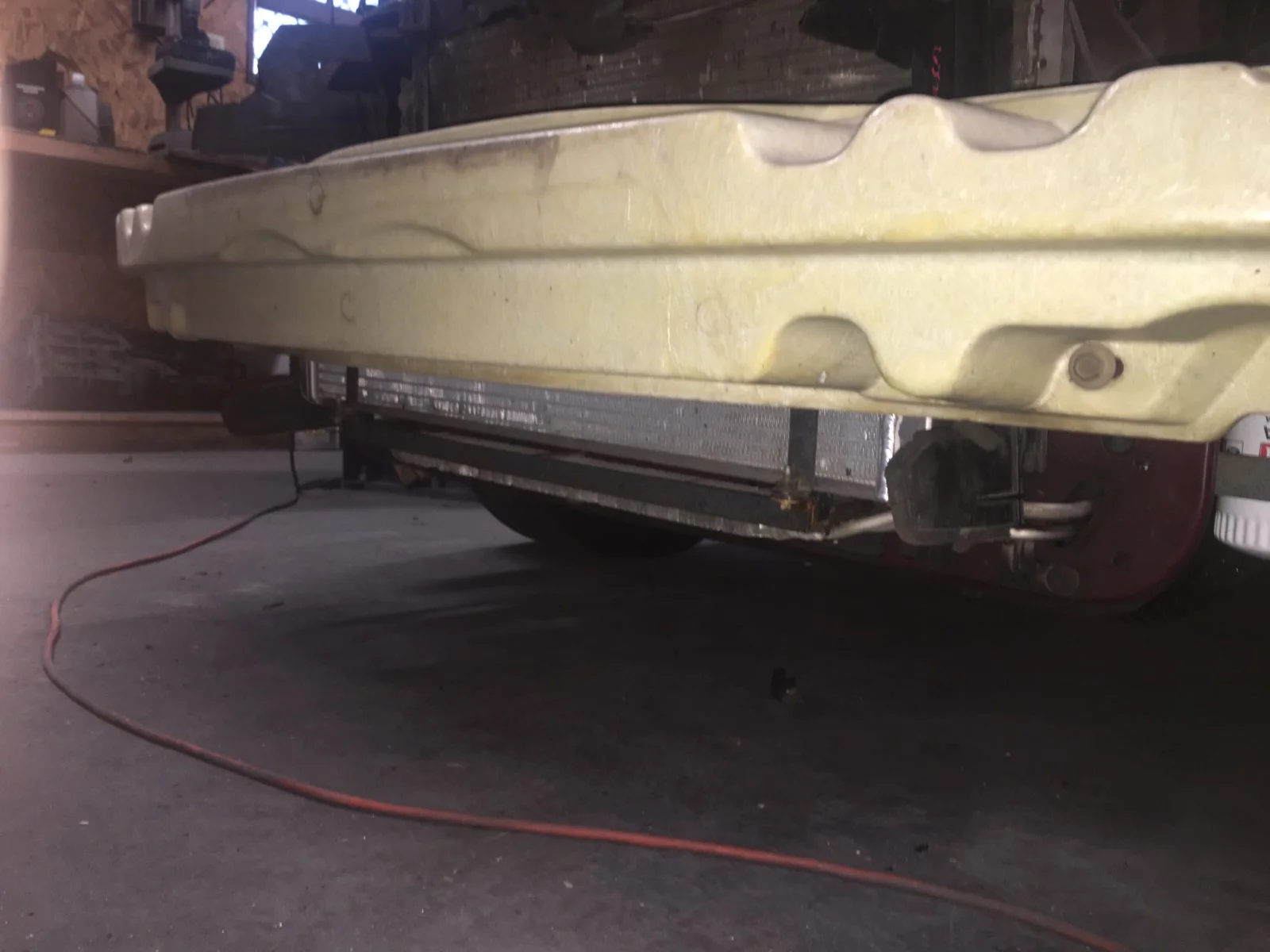

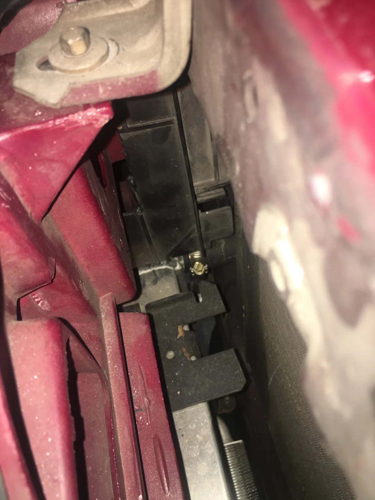

Since I’m trying to ensure this thing won’t over heat again. I thought, what if I could add air deflectors between the bumper and core support that the newer cars have.
A little more quality time at the local pick and pull...and sweet success!
I’ve barely trimmed these and they are damn near a perfect fit. They even kickout at the bottom to cover the heat exchanger.

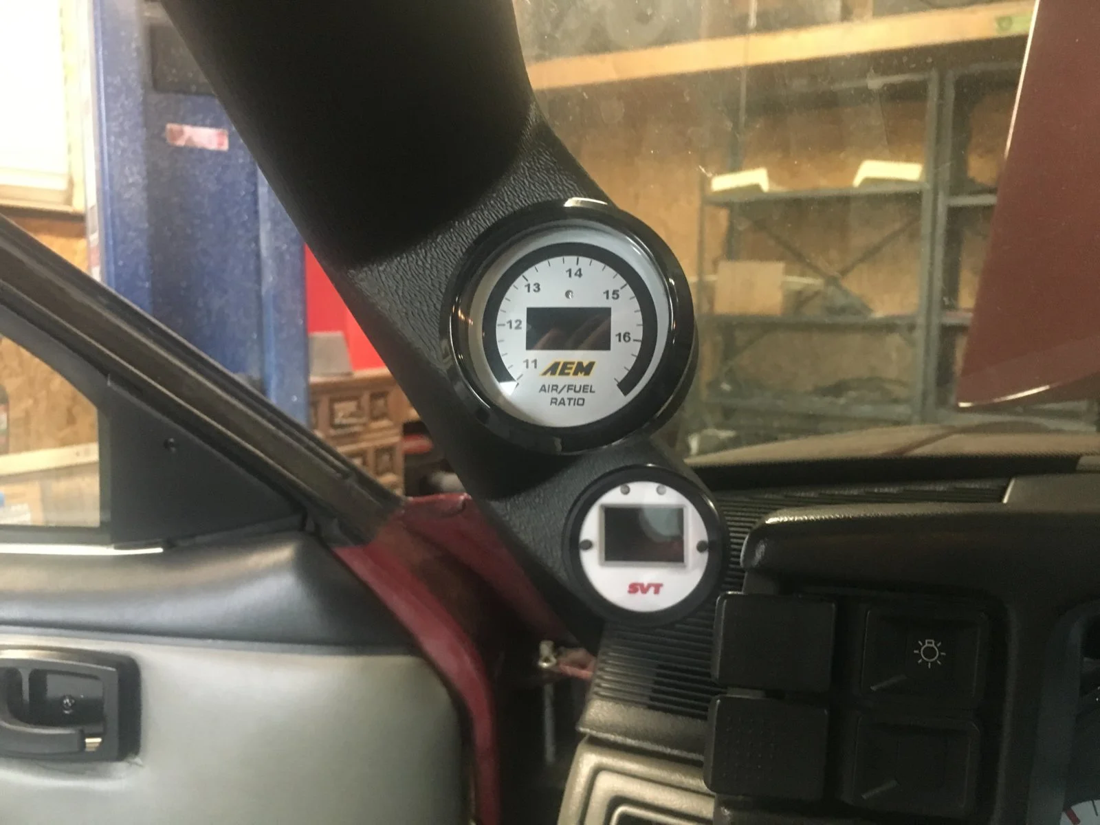

Finished wiring and installing the new pillar gauges. Top one is wideband and the bottom one is a multi-gauge.
Plugs into the obd2 port and will display almost all of the ECU parameters. I’ve got it set to show fuel rail pressure, charge air temp, battery voltage, and I’ve run two analog inputs for oil pressure and water temp.
Finally got the front bumper to fit. Had to drill out all the rivets to the header panel. Then install and fit the bumper and then install the new rivets. The parking lights slide right in now.
For those of you interested, here’s the air dams once trimmed to fit the bumper.
Had to trim most of what stuck out above the inner bumper support. But I still think they’ll do a good job funnelling air to the radiator.

Took it for a quick drive. The good, water temp stayed right on the thermostat the whole time, even with the AC blasting. The bad, the Borla Stingers are hideously loud. So loud that they’re not going to work. Oh well. I’ll figure that out later.

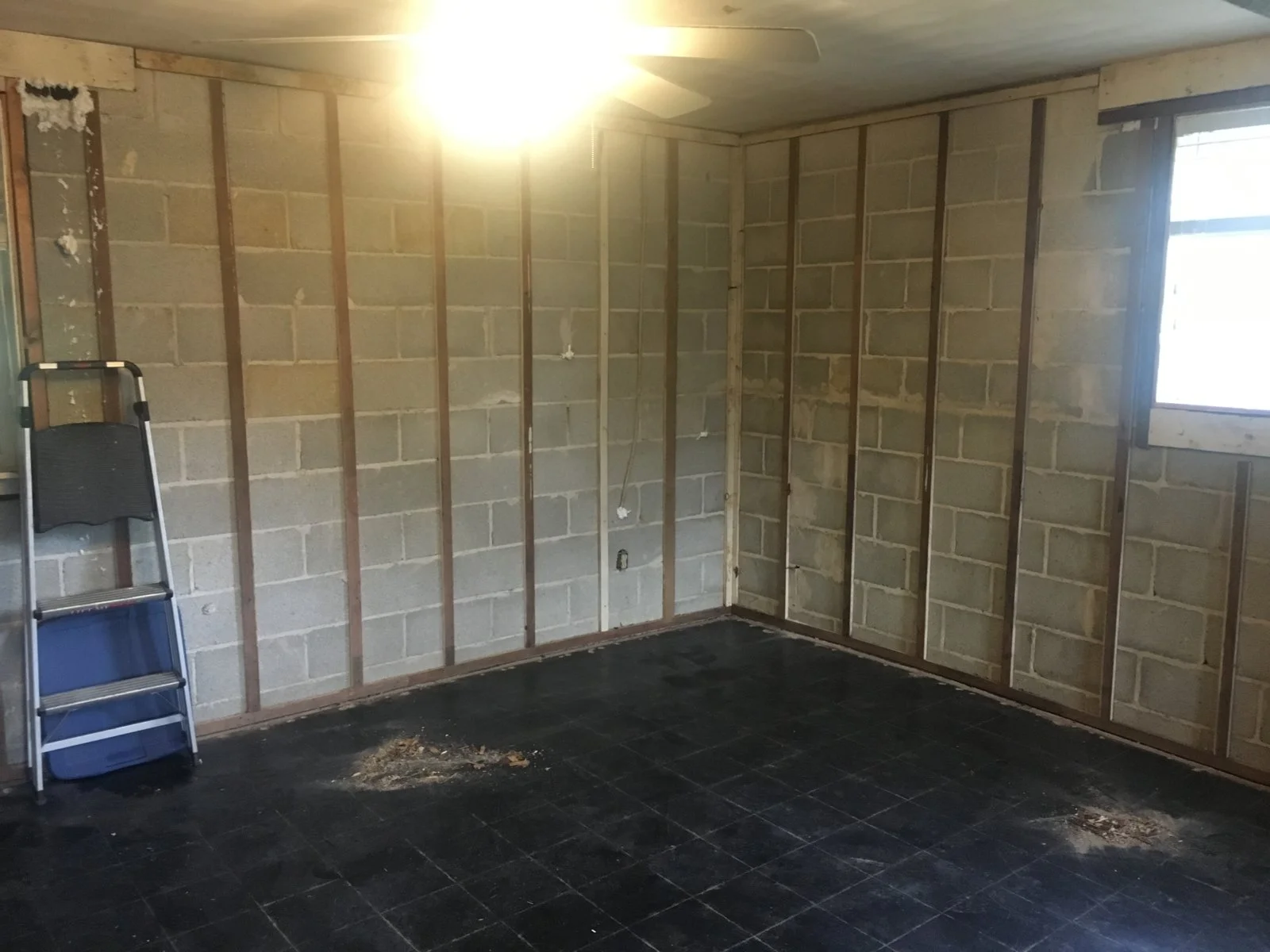

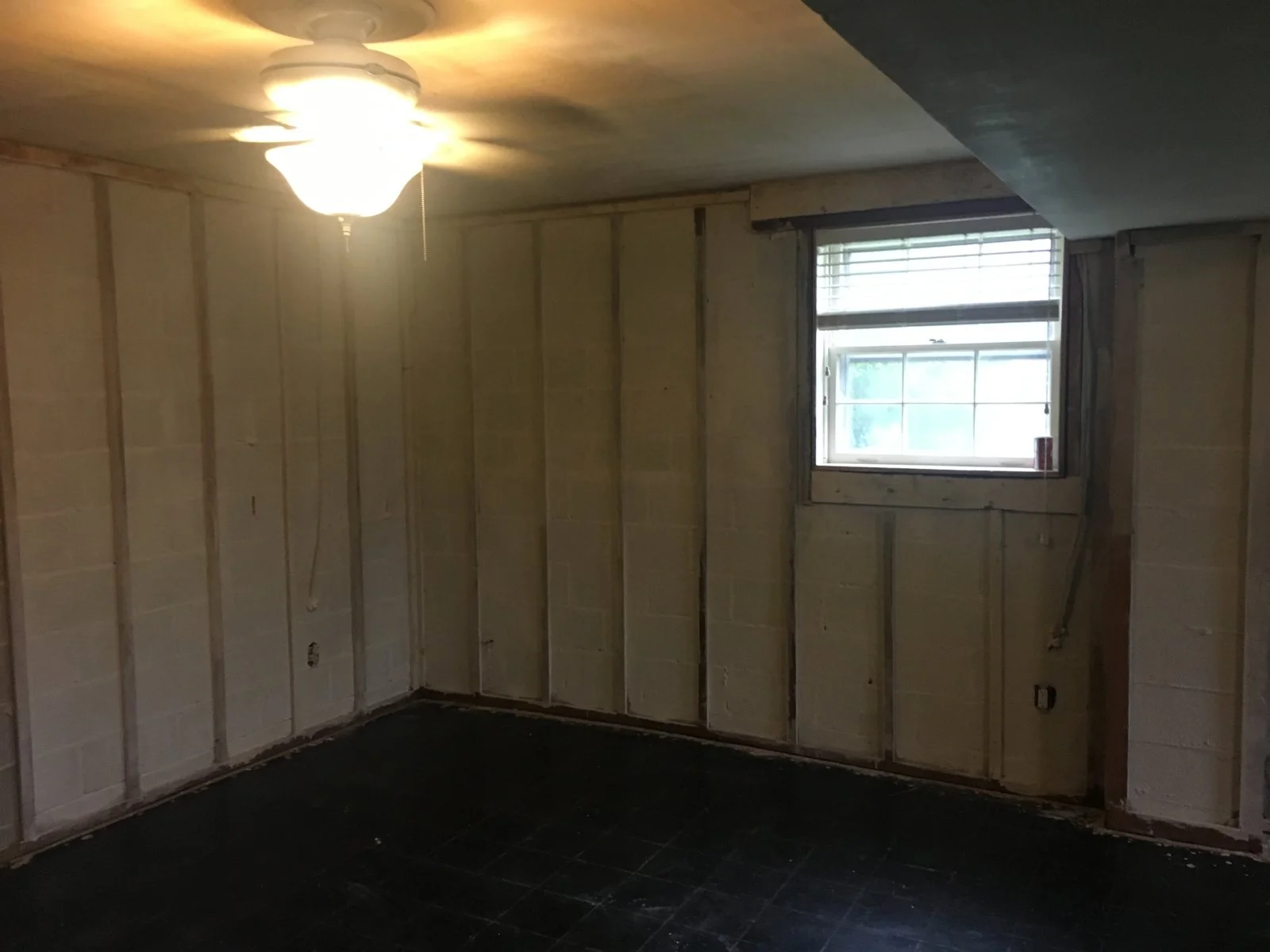

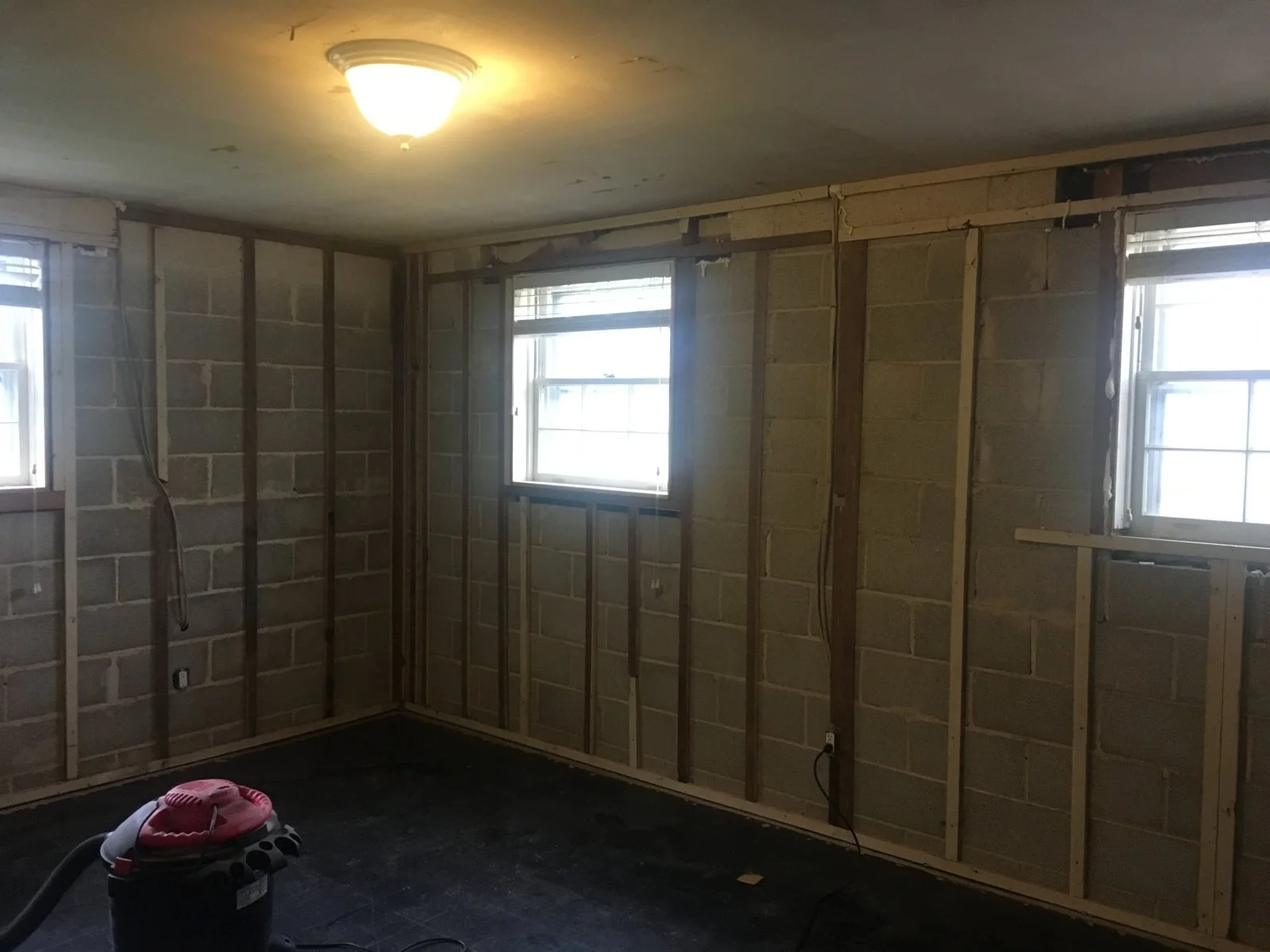

Time for the house. Finished demo of the 60 year old delaminating wood paneling.
Then started sealing the cinder block.
That stuff was a gigantic pain to use. It was so thick, it took 1 hour and one gallon to seal about 6 feet of wall. At this rate it would have taken close to 10 gallons for the first coat and 8hrs. There was no way I was going to spend that much time. So, I thinned it even though the directions specifically said not to.
This stuff is designed to waterproof below grade cinder block walls. My walls are not below grade. I’m just trying to keep them from leaching moisture. Once thinned is still took 10 gallons for two coats.
