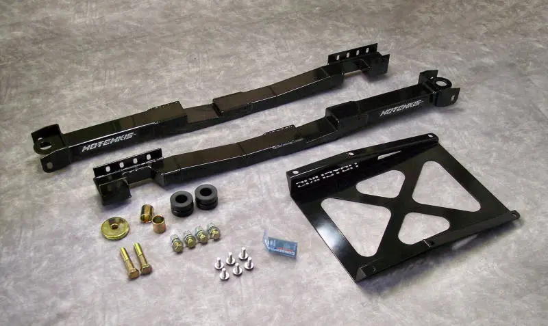

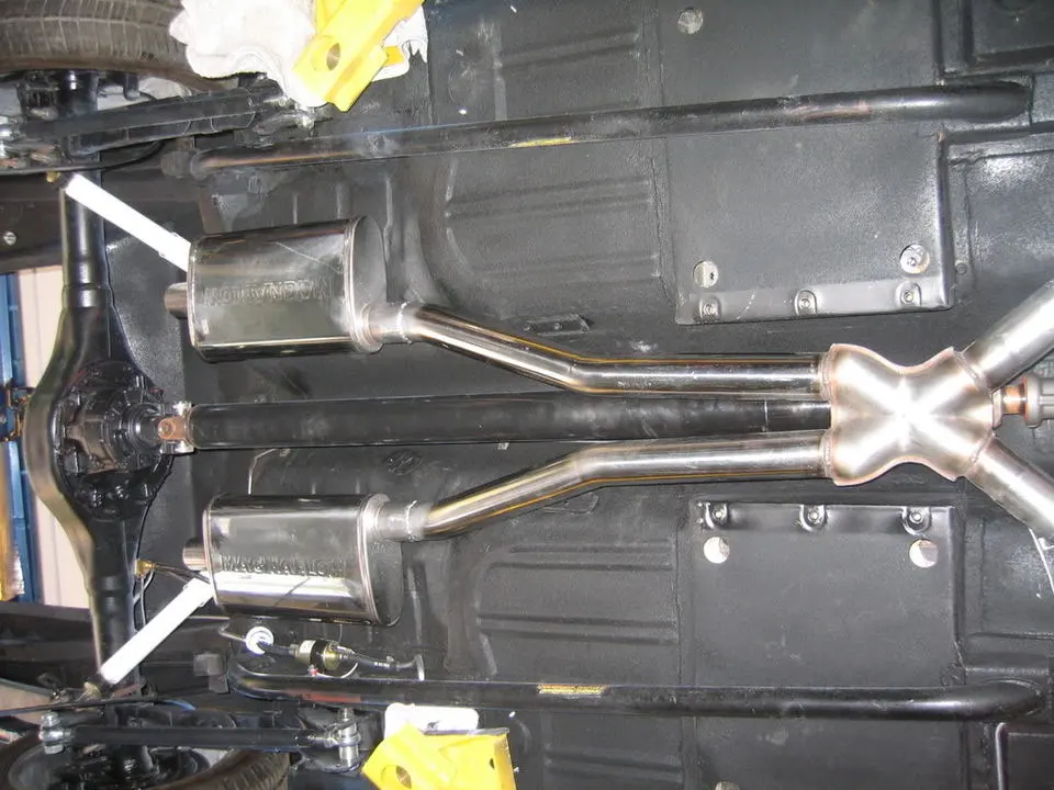

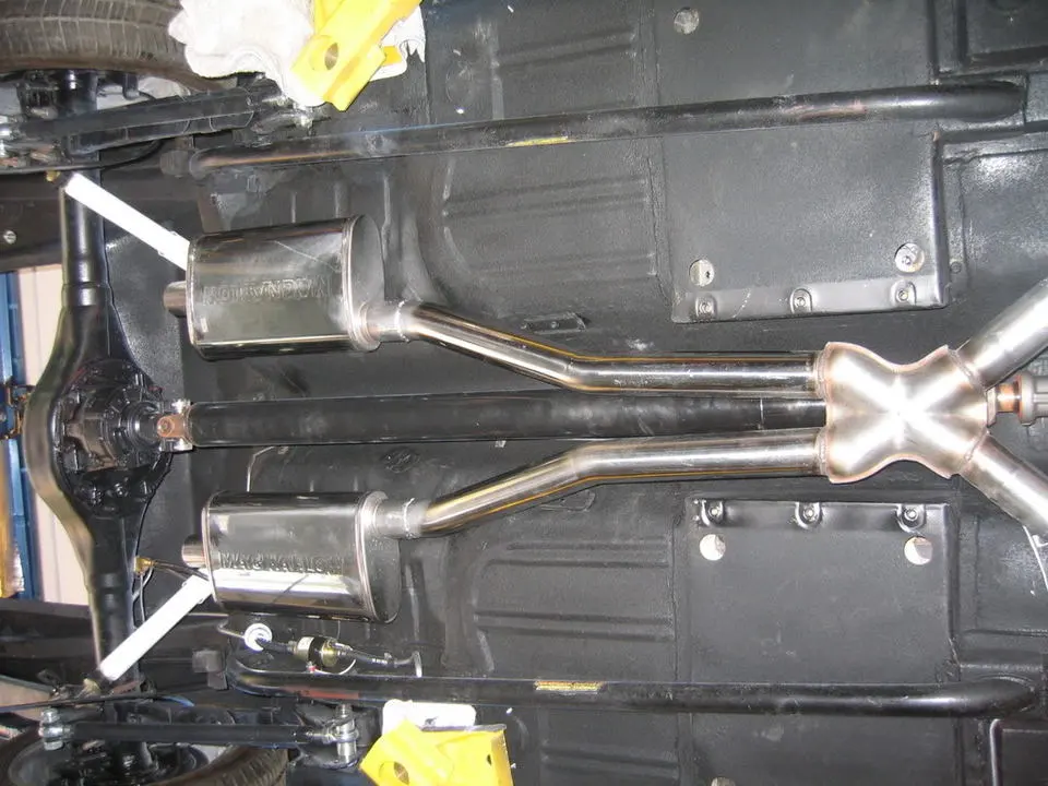

Quick question...Did you remove the extra convertible brace connecting the seat platforms to install the exhaust? If so are you worried about excess body flex?
right around the 'x' pipe

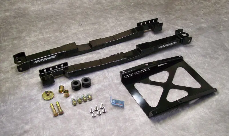

conv seat brace
The standard plate the bolts between the seat supports did not fit with the exhaust in place. I fabricated a brace that fit under the exhaust and welded to the subframe conectors as well. I can post a picture later but I'm leaving on a trip tomorrow morning. In summary, you are right about being concerned that the car was not appropriately braced as shown in the picture. The stucture I put in place not only connects the seat supports but also connects to the subframe support.

3" Magnaflow

Are you planning on running the 3" pipes out the rear? My 2 1/2" pipes are a tight fit between the gas tank and leaf springs. I don't think that the 3" pipes would have fit without some vibration induced clanging against body parts.
Just a thought - good luck.

FWITW 2.5" exhaust fits with the stock convertible belly plate and a T5, but you have to go H pipe. The X just wasn't going to fit.
I'm not running leaf springs; coil-over system. Magnaflow sells the 3" exhaust kit, why would they sell it if it didn't fit? I've heard of others running it. I'm sure some how it can be made to fit.
I just went out and looked, without the leafs there is plenty of room. I think it's going to take some effort to fit it around the coil-over though. If not I'll just dump it to the sides.

It would have been nice to have thought of the H-pipe. The Magnaflow folks said that the X-pipe system would fit on the convertible with minor modification of the seat platform support plate. The minor modification turned into a two inch drop, but the exhaust sounds great and fit very well.
Which is why I'm ripping off the Hotchis design, it drops it like 2"+ to clear everything.
