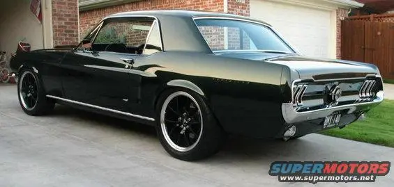

68 Coupe Just Finished
85 Turbo Bird said:
absolutely gorgeous!!!!!!!!!!!!!!!!!
Those pictures are now saved to my "Inspiration" folder :D Got any more?? :D
what all have you done to the interior? What guage panel is that?
I am honored to be a part of your inspiration folder!
The interior is all stock except for the gauges (Autometer Ultra-Lites) that I did myself and the Grant steering wheel. Future plans call for Scat ProCar seats (w/out the headrest), a 6 pt roll bar and 4 pt harnesses.
1320stang said:
I think a modified rocker trim would looks good, the lip at the top polished and the bottom painted the same black with the same level of gloss as the wheels, maybe powdercoated instead of painted.
Here's a crude photoshop...
Thanks a lot for the photochop, it looks great. However, I decided not to install the moulding and returned it to DMP. So the car will be going back to Mohrs Restoration (shameless plug) to get the holes filled.

Yeah about 2" from where it would have sat with the GW springs as purchased. For the back I used lowering blocks to mock up the ride height before pulling the springs and getting them dearched. I would dearch about a 1/2" less than you want then dial it in with some thin blocks. That way you can always easily raise it back up some if you need to.
620 rate springs lower the front of the car 1", so you lowered it 2" past that? and the rear, is on dearched springs, and lowering blocks? sorry for the trouble i am just slightly confused, and how did you adjust pinion angles, when you dearched your springs

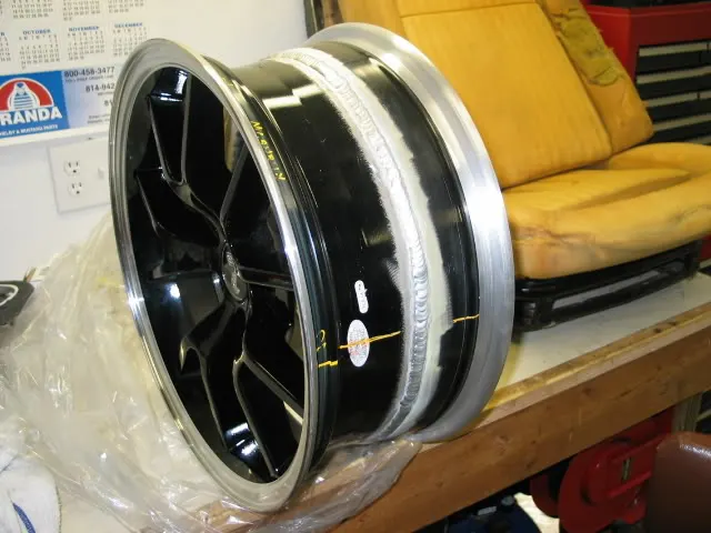

Also what is the ride like with 18's caues there is not to much sidewall there?

sorry that I was not clear...on the front all I know is that I cut one full coil off the springs. If it helps the height from the ground to the top of the fender opening is 23.75" and the back is 24.50". On the back there are no blocks...I only temporarily used blocks to determine how much I needed to dearch the springs. However, I would recommend only dearching these springs 1" and then use blocks to lower it the rest of the way. This allows for some adjustability should you decide to raise it back up for whatever reason. I have not checked the pinion pinion angle...which is another reason to only dearch 1"...so you have space to use angle shims as they will lower the car some as well. BTW what is an ideal pinion angle and what is the allowable devaition?

I am not sure what an allowable deviation would be nor do i know what the pinion angle should be, i figured it might be in my service manual but it was not.
