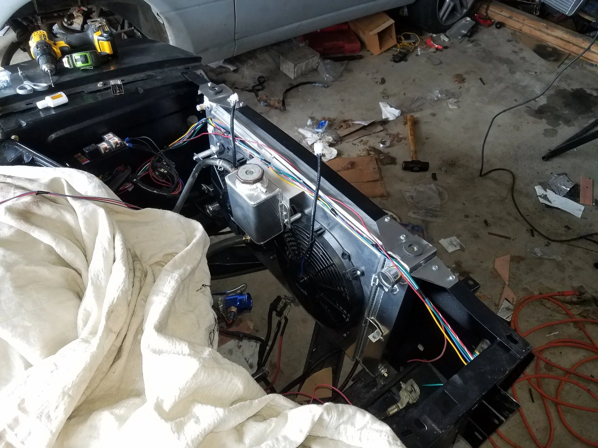

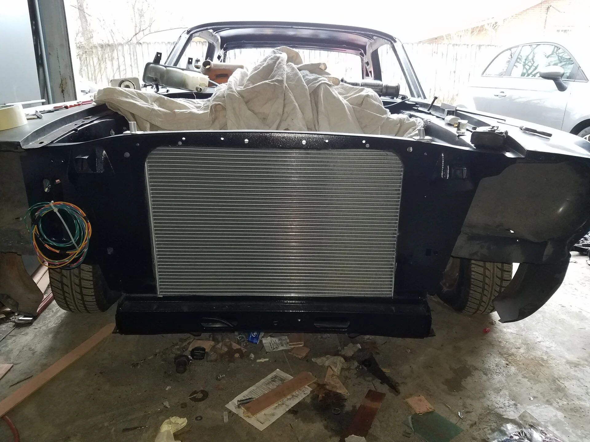

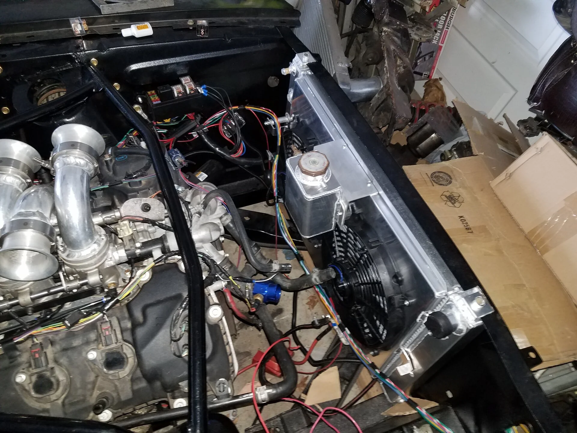

The Coyote has the same coolant outlet locations as my 3.7L(passenger upper, driver lower). I used a SN95 aftermarket aluminum radiator after cutting open my radiator support:
If I had to do it again, I would instead choose an aftermarket '66 Thunderbird aluminum radiator, it would tuck under the support just a little bit better than this one does and its also an expansion tank design.
