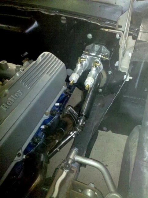

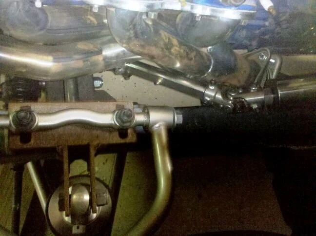

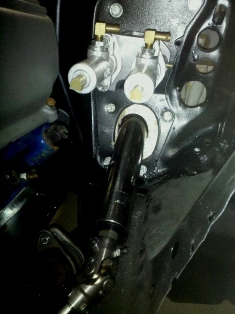

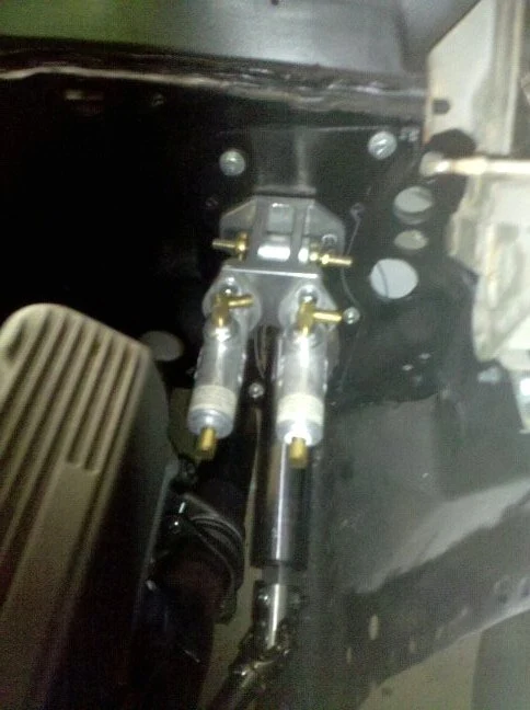

The steering system, exhaust and driveshaft are in.

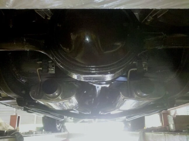

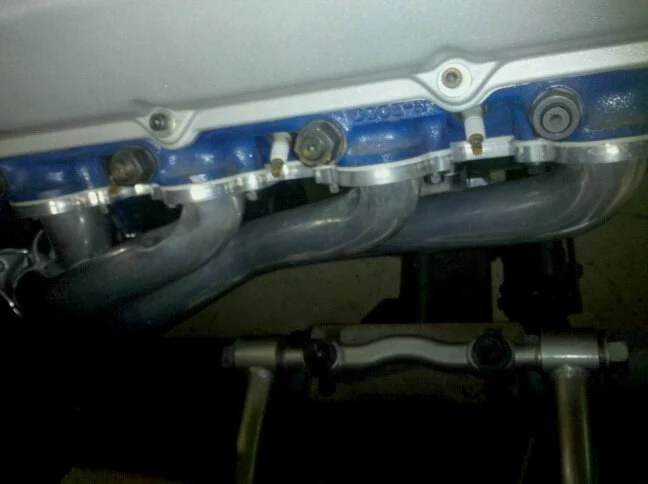

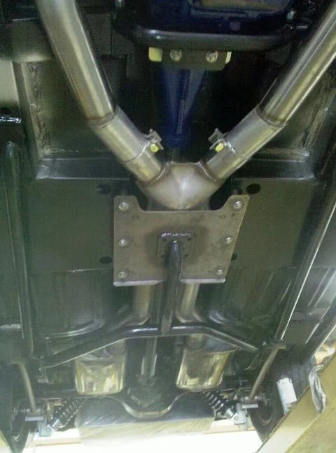

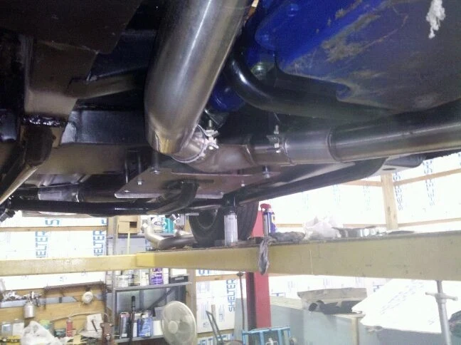

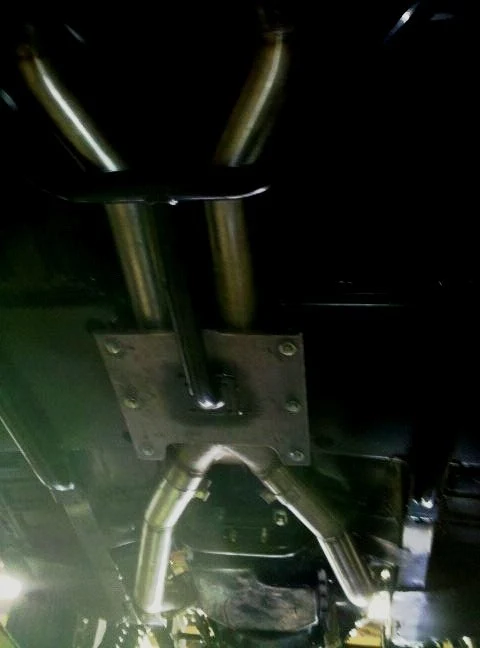

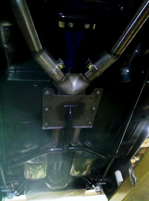

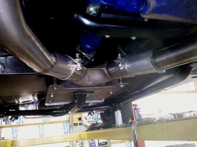

UPDATE - Exhuast, Headers, Steering, Convert Plate, X-Bar, Suspension, & Subframe All Complete. 3" Stainless Steel Magnaflow exhaust. FPA Headers.
I have to finalize the design of the convert plate; going to add some metal sides to add some strength and cut out some on the main plate to allow cooling under there. The car is back in the garage until we move to the new house.
Adding metal sides to the convert plate - great idea, crucial!
I have to finalize the design of the convert plate; going to add some metal sides to add some strength and cut out some on the main plate to allow cooling under there. The car is back in the garage until we move to the new house./QUOTE]
There is some very very nice work here, but at first I was going to be critical of using spacers on the convertible plate, as you really lose the strength there. But your idea of metal sides, or plates, or "wings" added to the sides is really inspired. This makes me really think about adding spacers, "wings", and putting my exhaust back where it belongs above the convertible plate. Personally I would tie the plates into my Tinman subframes that go through the convertible plate. so the underseat subfloor ties ALL of that - subframes, plate, etc., to the rocker panels.
I also really like your idea of the TCP convertible brace welded to that plate. Very nice work there.
I've seen and participated in a lot of convertible floor pan reinforcement threads, and threads about what to do about the bolt-in plate and exhausts, and you have some very good ideas there. The only thing I would add is that if you can tie the plate to your subframe connectors and to the rocker panels, or at the very least to that convertible subfloor plate, you would have an UNBEATABLE subframe/convertible plate-compatible-with-exhaust/rocker panel reinforcement system. Something that even the coupe and fastback guys might consider to strengthen up the middle of their ride. A lot of those guys are thinking about the convertible subfloor system, and if they did that, they would be well advised to follow your lead and drop and reinforce the plate.
Nice work! :nice:
