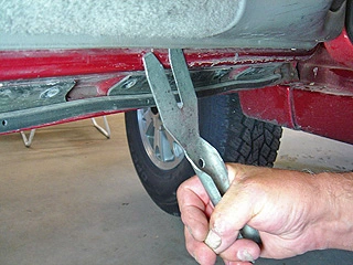

With one of these. About $5 from Glazier/Nolan. Remove the door and window handles, and the arm rest. The pry up each panel clip. The chrome outside handle is connected to the latch by a pushrod, and the to the door with a nut inside the door, and a Phillips head machine screw at the back of the door. I put a little masking tape on the tool to protect the door from scratches.
