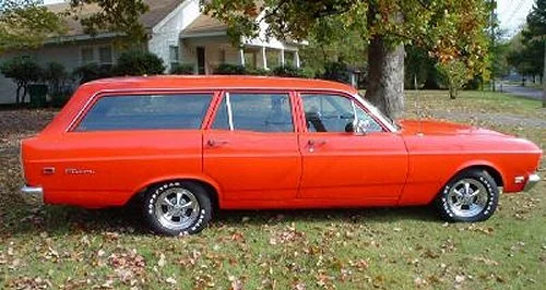

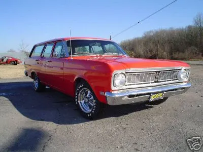

Ok, I traded my 74 Bronco for a 69 Falcon wagon (looks like a 66-7 Fairlane from the doors back) and now I want to do some suspension modifications to improve the handling and because I just can't leave anything alone :D I've been told that I can use 67-70 Mustang sway bars, is this true? Could I use the 1' lowering coils up front also? I've checked with Falcon, Fairlane, Torino specific vendors and their catalogs and personnel are a little vague on what fits and what doesn't. :scratch: TIA.

tjm73, that was the 70 1/2 Falcon, the last cars produced with that name :notnice: but this bodystyle is different. The front sheet metal is definitely 69 Falcon but the rest of the car is Failane nad the interior seems to be a mix of Fairlane and Torino.

Sweet dude!!
I've always wanted to get a wagon, put the doors (and jamb I guess) from a 2 door on, weld up the rest and either colour match the rest of the glass with tint or weld in a panel aka sedan delivery style.
2 buckets in the back with a DVD/ playstation for the kids, then my kayak (colour matched of course with poweder-coated rack can go on top). :nice: Look good though.
BBRacer, I was thinking along the same lines, weld the rear doors shut or swap the longer Farilane sedan doors, move th b-pillar na dcreate one long side window, with limo tint of course. The more I look at it the more I like it the way it is. It just needs to handle and stop a little better. I am going with EFI and an AOD though :nice:

Pretty Much you can buy stuff from a 69 Mustang and It will fit because I have a 68 Falcon and when I by stuff for it I just say 69 Mustang. All the front suspension is the same. I just replaced everything up front. When I order it I just said 69 Mustang 428 motor. Your Falcon front end looks exactly like mine.
My dads good buddy owns a 69 Mustang and we built my car after his. Because his car is so sweet.
