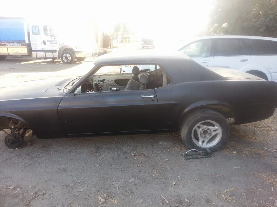

Have a "not quite"-rolling chassis for a '69 coupe. Looking to do a resto mod. Getting started with the body work. My next "project" (read task) is to redo the front suspension. I got it after someone had changed it, now its pretty much trash....
Any suggestions on good front suspension, I can place on it? Also looking for some good brakes?
