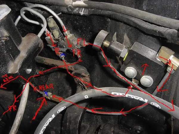

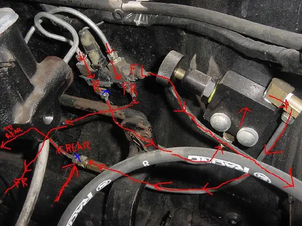

I think its the same as my 67
you wont have problems like me as there is no difference in the hydraulic system, only in the brake pedal and the addition of the booster, however... the rear end, etc. you using 9 inch rear?
I'll let ya know on the lines, shouldnt be too hard.
Regarding the post about the 67's system...
Thats what was used up untill 70 which is a two unit distribution block and proportioning valve. Although yours looks like an aftermarket adjustable proportioning valve it's still the same idea. Thanks for posting that, it's giving me ideas.
