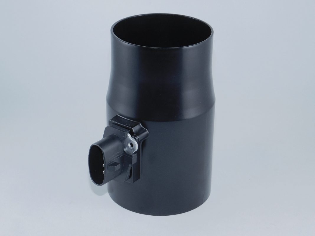

The adapter does not connect to the stock airbox. You use the stock rubber tube at the airbox side. The adapter flange screws to the 70mm maf. The adapter hose end goes to the stock rubber tube but you may need to trim the small end off of the stock tube. The other end of maf connects to the tube that hoes to the TB.
It’s necessary when installing a factory ford 70mm maf on a Foxbody that originally came with a 55mm maf. The 55mm Foxbody maf has a tube connection on each end. The larger 70mm maf has tube on one end and a flat flange on the other. The adapter bolts to the flange side of the 70mm maf and thereby provides a tube type connection point

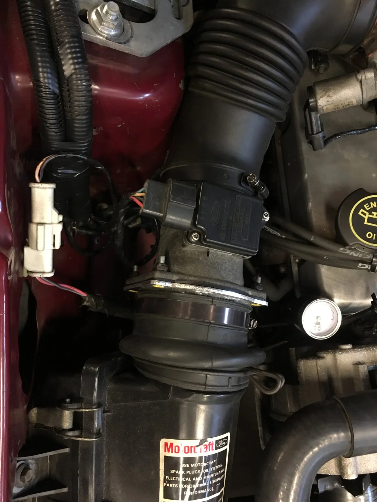

Here’s the MAF adapter with Ford 70mm MAF on Foxbody with factory airbox and factory tubing. To update me previous post, it looks like I trimmed a little of the rubber tube at the air box side to make it tube shorter. The reason is the the 70mm MAF with adapter included takes up more space than the original 55mm.
Yes, that's what I meant to imply. Connects to the rubber tube that connects to the stock airbox. Same as your photo
