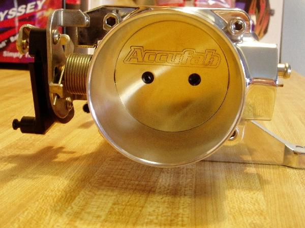

With the mods i have what would be the better size. i am planning to buy Accufab and after i get the throttle boby get the plenum.

The Accufab is made for a 70mm and thats also what they recommend
70mm. Here's why http://www.modulardepot.com/?show=articlesdet&aid=30

I have a bbk 75mm, no complaints. came with new gasket. straight forward install. bigger is better if you're going to get a blower down the line.

Better throttle response down low with the 70mm - the $10 diff is no big deal, but the 70mm was recommended, so that's why I went with it.

If I am planning on adding a S/C down the line would it be better to get the 70mm or 75mm?

75mm if you're going FI.
But you're better off with 70mm in the time being. I'd only get the 75mm TB after you've purchased the actual S/C. Many people have high hopes to get this or that and very few really follow through with it.
N/A-70mm
S/C-75mm
Is the 75mm going to hurt me if I dont go FI after all? I dont see the point in buying a 70mm now then I do end up getting a S/C than having to buy the 75mm.
