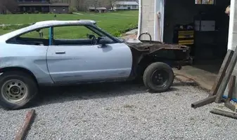

Yep the body doesnt have any holes its the subframes in the front and floor pans. The floor pans had been patched but not to my standards they just put large piece over the hole and left all the rust under so Im going to get floor pans and cut everything out. As far as the subframes go Im going with 2 1/2 sq tubing up past where the radius arm mounting bracket bolts on and back about 30"s and then to the rear spring mount to try everything in see pic yellow line would be the sq tube hopefully straighter than in pic.
